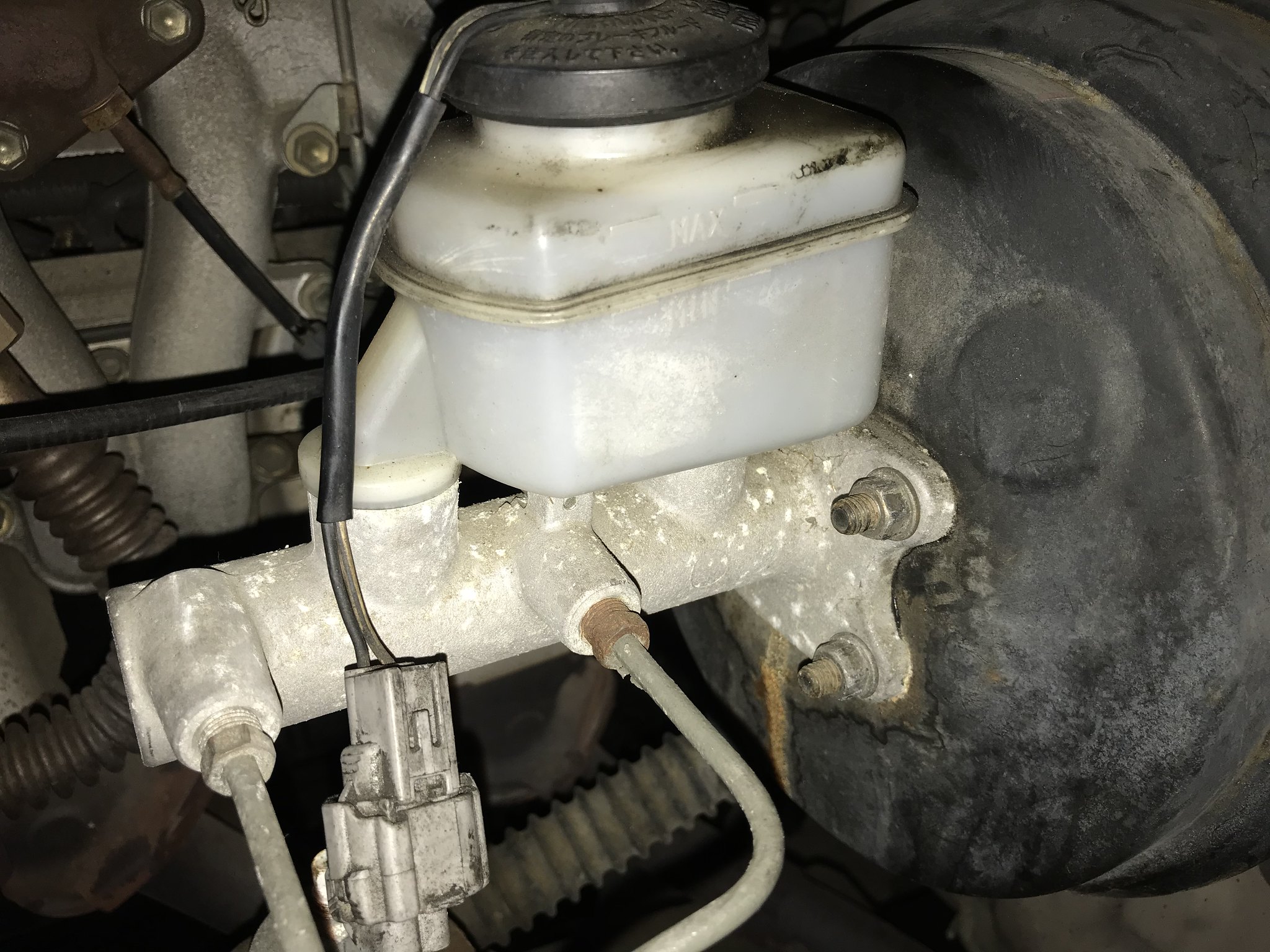

Brakes
They are super squishy! They stop, but just barely. The PO said the master cylinder needs to be replaced, but how do you know if it's that or the brake booster? Also, rebuild or just replace it? ....need to search more about this topic.

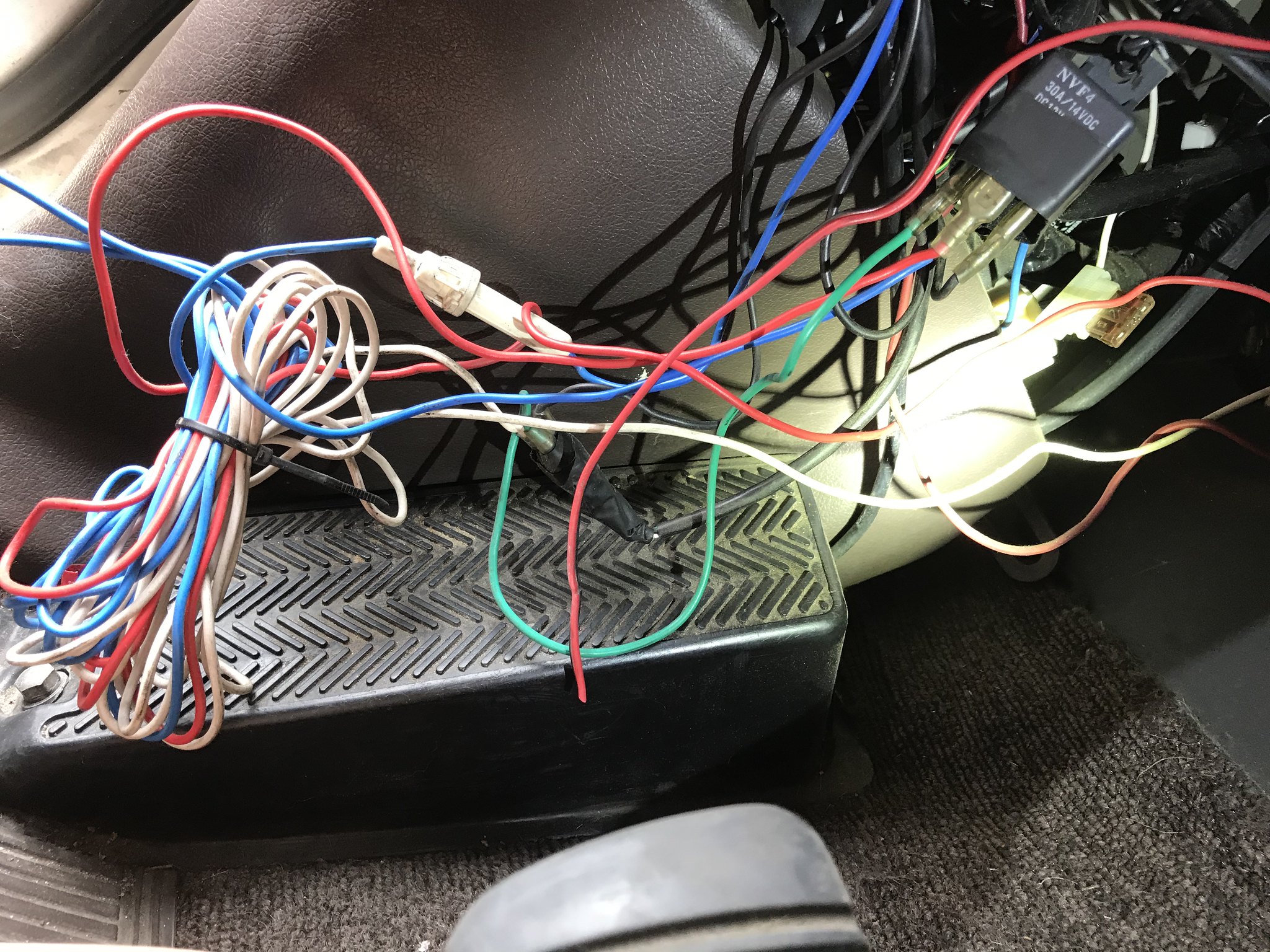

Alarm System:
The truck has a ridiculous alarm system that has only one remote that is literally in 3 different pieces. If I disconnect the battery, I have to deal with disarming it all over again. I searched at it looks like the 1991’s didn’t have factory alarms….. so am I ok to remove it, provided I figure out how it disables the vehicle, and remove that as well??
WTF is this!
It's under the drivers seat. Is this part of the alarm? It’s wired to so many different things and then goes up behind the stereo to this plug, and then also up overhead to this thing….. if this isn’t factory, I’ll just remove all of it. I have a feeling it’s part of the alarm system, but because of the way it’s imbedded, it looks like it could be factory. I have no idea!
1995927

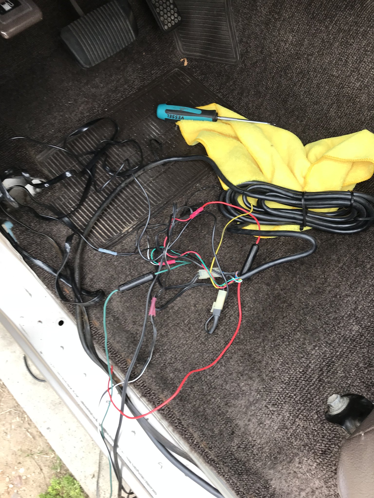

It's connected to all of this mess.... that has spliced in wires, running to ghost exterior lighting all over the truck. Such a mess!
This is all wired separately.... Alarm???
What is this thing??
It’s not connected to anything….
Is it SMOG related? I’m confused.

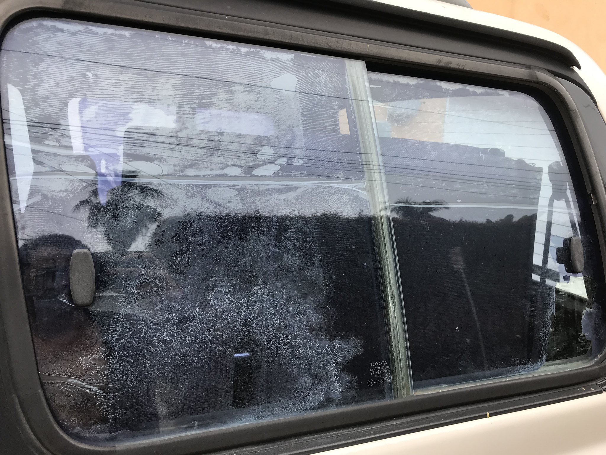

Tint
Is there a good way to remove the tint? Heat gun on low setting? Razor and windex? ....that's how i've done it before, just looking fo new ideas.

I'm almost certain that the thing under the seat is for a 90s car phone.
Oh man, that would make sense! There is a large cable that comes off of it that I followed but lost under the dash. I bet it's a coaxial cable. And I noticed that the antenna looked off, and kind of like an older cell phone antenna... and I just searched photos of LC80's and they don't appear to have come with front antennas. You can see mine in the photo. I bet if I pull it out, that large cable will be connected to it. Thanks so much!

I would yard that alarm and weird box out asap. It's not doing you any favors.

To remove the tint get some 409 cleaner and a black garbage bag. Spray the tint with the 409 and cut the plastic garbage bag to roughly the size of the window and stick it on top of the 409. Leave it in the sun 15 mins then peel the tint off in one piece and hardly have any residue to scrape.
Their symptoms are quite distinct: brake booster failure means hard pedal and the master cylinder problems are more like loose pedal, caused by master cylinder bypass.
WOW, this is exactly what I needed! Thanks so much for this info!
