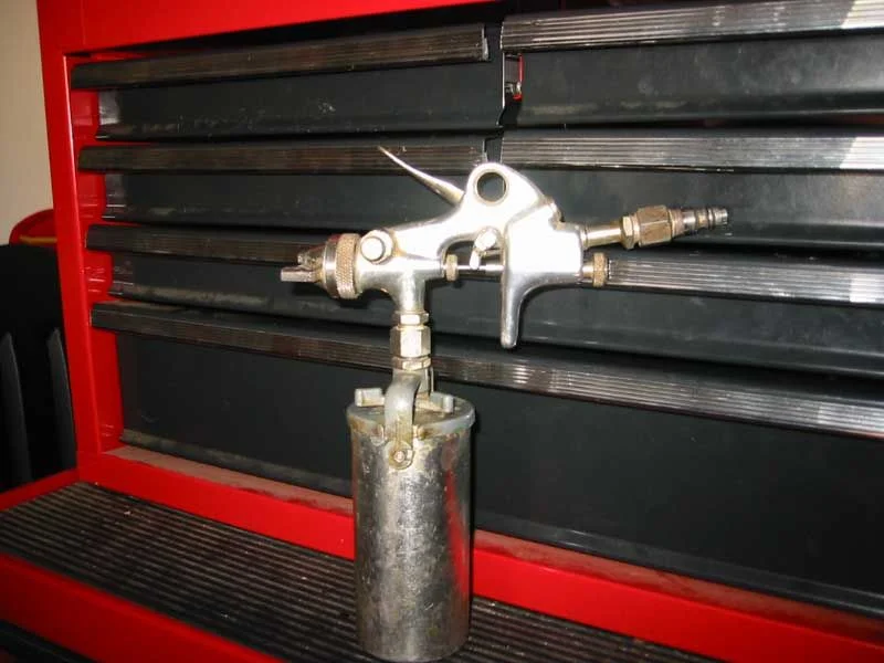

Image 3 shows my 20 year old Binks model 115 detail gun. This is what I used for the application. You can use a brush, but the dye really needs to go on razor thin. The detail gun was perfect for applying a thin dry coat. Three coats were done to each seat. They took a total of about 30 minutes.

The dye is water based and sprays like Latex Paint. You do have to watch your gun carefully for plugging. In fact, Kysti recommends agains spraying due to possible buildup on edges and seams. I used to paint cars for a hobby so I know how to spray, well sort of. Also, the detail gun is the key here. The product needs to go on THIN. That is why the seam holes did not fill up. In fact if you put it on thick enough to do so, it would look like a Tammy Fay Baker makup job. If you look at a new car I dont think the seam holes are filled. Finally, it is not a hard plastic coating. It is soft exactly like the original finish. it is very flexible. After my test areas on paper dried, I folded and creased the painted spots in an attmempt to get the finish to crack and it wouldn't
