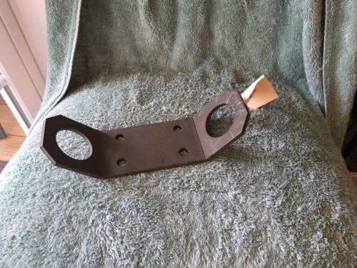

@WarDamnEagle and @flintknapper where did you guys source your hitches and the safety hook wings on the backside of them? any links to websites or links to forum vendors would be much appreciated! Electrical hook ups as well if you have any
My hitch is a Holland Ball Pintle. I'm not sure they make it anymore. The safety hook wings, as you call them, is a NATO Chain Plate. I don't recall where I bought mine but they seem to be readily available. Eg: Plate, Pintle Hook Safety Chain Hook Assembly - https://real4wd.com/product/plate-pintle-hook-safety-chain-hook-assembly/
I used a Hopkins trailer wiring kit specific to the 80 series. I had to drill a hole in the center with a hole saw and then the assembly mounts with 4 screws. I recall it being a very easy install.
