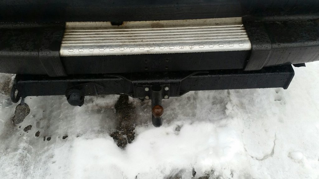

I pulled a hitch off of an Isuzu at the junkyard years ago for the pintle holes and have been using it for 4 years to tow my 21ft boat, multiple cars, moving trailers, etc. I've used it hard with over 5000lbs on many occasions without issue. I've even used it for snatch recoveries many times.
what finally did it in was towing a heavy car with no trailer brakes. I only had a short window to borrow a trailer and didn't have the correct wiring connection. It was a short tow, 15mi, so I took a chance and rolled without lights or brakes.
The frame crossmember handles pulling just fine, but apparently cannot handle the force of a 5500-6000lb trailer with no brakes. Luckily it wasn't catastrophic failure

View attachment 3300482View attachment 3300483View attachment 3300484
If the car on the trailer would have been loaded back further and kept the weight on the trailer and not the tongue, it would not have over stressed the cross member.
Assuming there was no such deformation 'prior' this incident.....I would say that excessive tongue weight is more the culprit than lack of trailer brakes. Everything I see in the pics point to that.
definitely had too much tongue weight as well, but I've done that before without this result, so I think it was a combination of factors
Given the amount of rust on the frame, I can't agree this is a fair test of the limits of the steel.
While it certainly wasn't designed or intended to be a fair scientific test, but the rust is pretty much all surface rust and should have a negligible impact on strength. I'm mostly posting this as a PSA to people to not cut corners when towing. Take the time to load the trailer correctly and make sure the brakes are working.

It's actually designed for a pintle hook style hitch and other countries rate it for close to 8000lbs towing. I think my problems were almost entirely caused by me not loading the trailer correctly and not having the trailer brakes hooked up. I'm going back to my under-frame hitch, but I think I'm going to cut off the crossmember that is now ruined and mount it to the top of the frame so the receiver sits in between the frame rails instead of underneath
Towing close 8000lbs with a 80 would be sketchy with any type of hitch !! 🤷‍♂️
