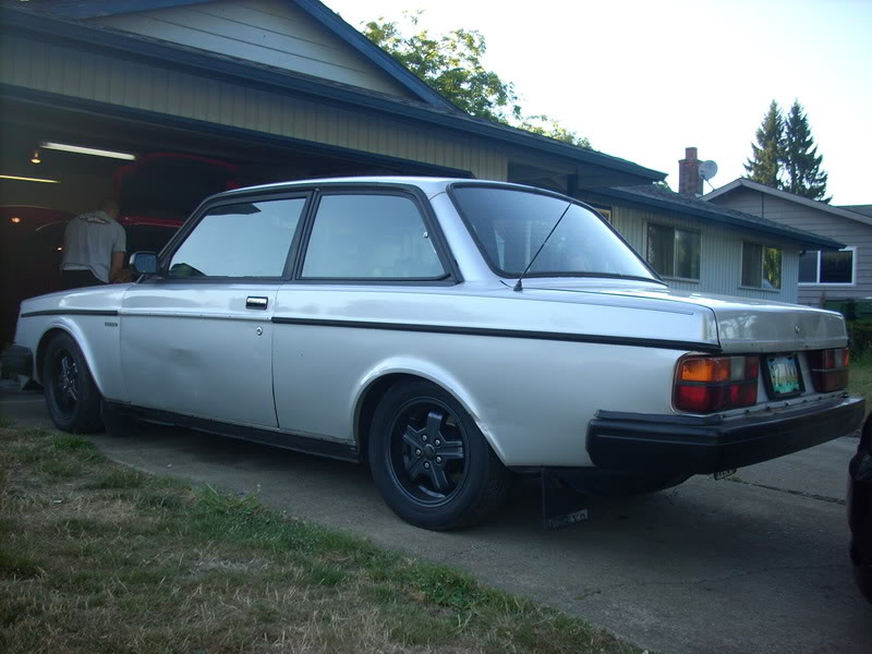

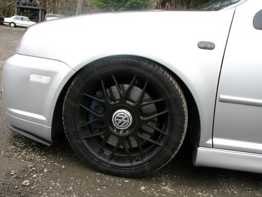

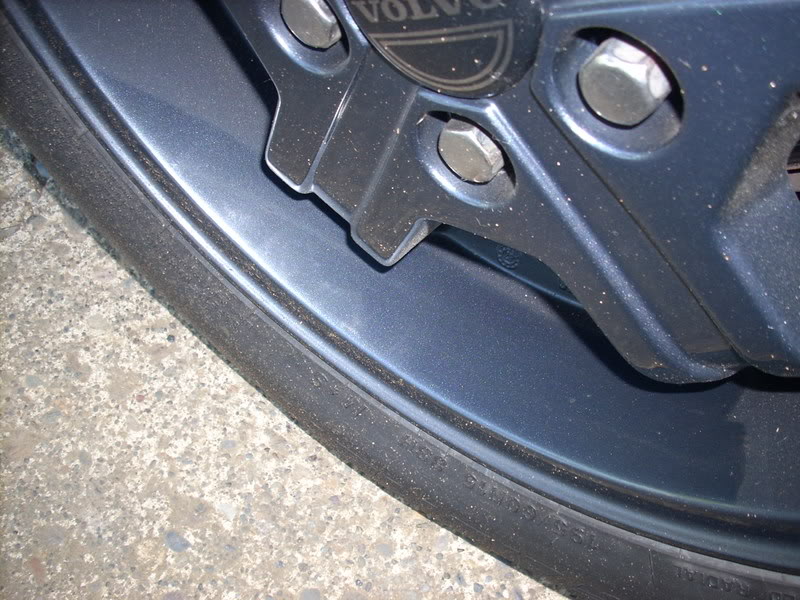

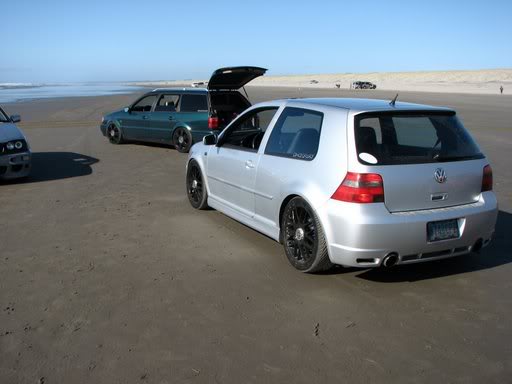

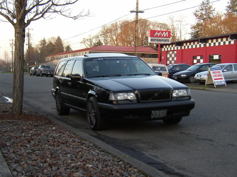

Powdercoating aluminum (IMO) is a waist of money... The key to a good painted wheel is the prep. Make sure it is beyond clean, then clean it again. Start with an etching primer and the spray it with multiple light coats. It will hold up just fine until it finds a rock but then powdercoating wouldn't have lasted either! I have ran spray painted wheels on quite a few cars with great results.
Some pics to prove it:

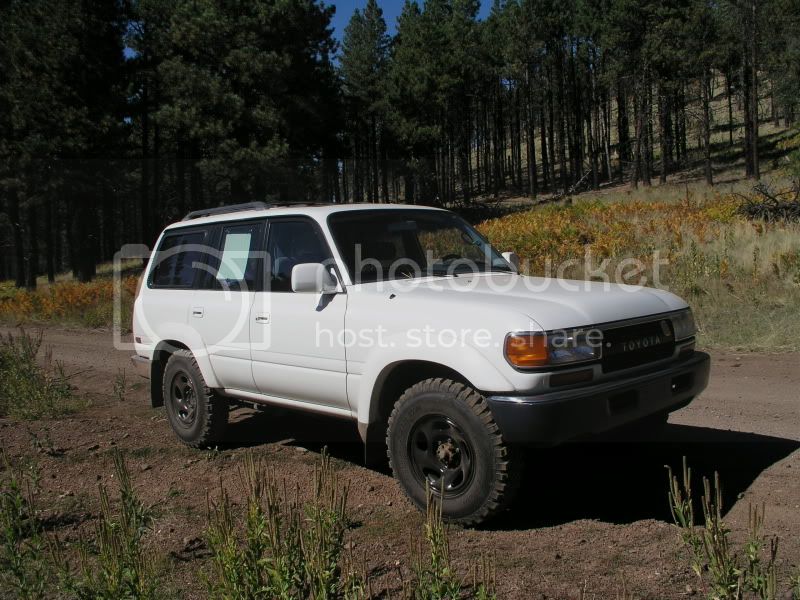

Scuff, Krylon flat black spray paint,and keep what's left of the can for touch ups.:bounce2:
