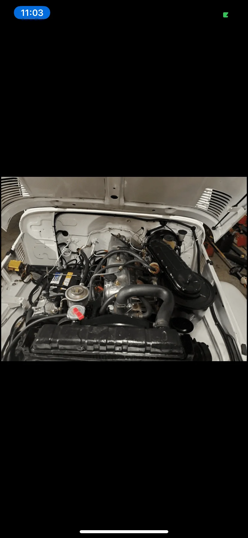

so I picking up this white 74 fj40. The owner is not sure if the motor 2f he says it might be an 1f for reason unknown. The picture of the engine shows 2f on the valve cover. Can you guys tell me what engine this is. And if it's the f1 is it still worth getting?

Ask for a serial number from the engine block. If it starts with F its an F then its an F motor. Valve cover means nothing. Where's the oil filter? F will have them on the intake manifold. The exception, in North America, is a 1974 which will have it mounted on the block beside the distributor. The 1.5 F is very well respected... and there's nothing wrong with F motors.

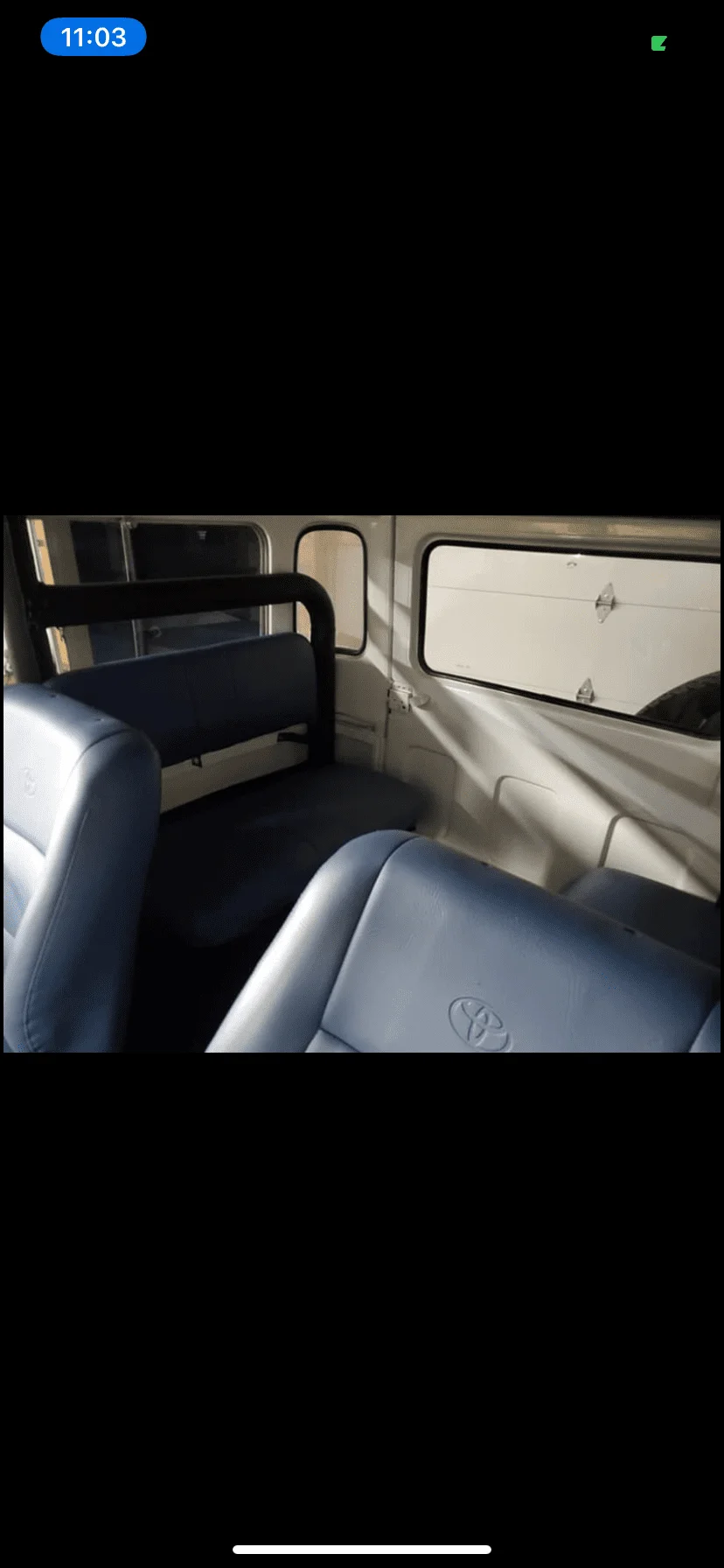

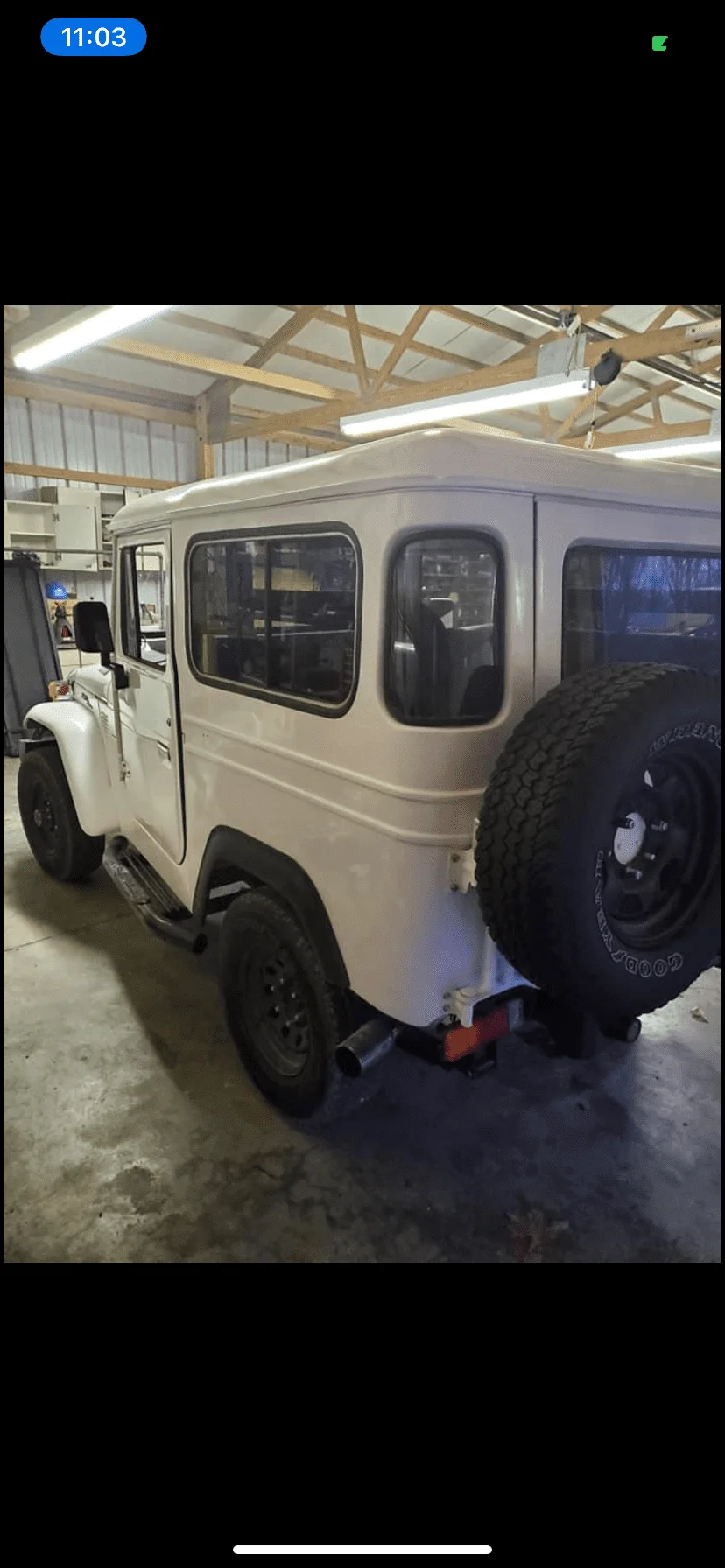

Just forget this! Maybe redone many times and mixed/missing parts. It’s not worth even thinking about it.

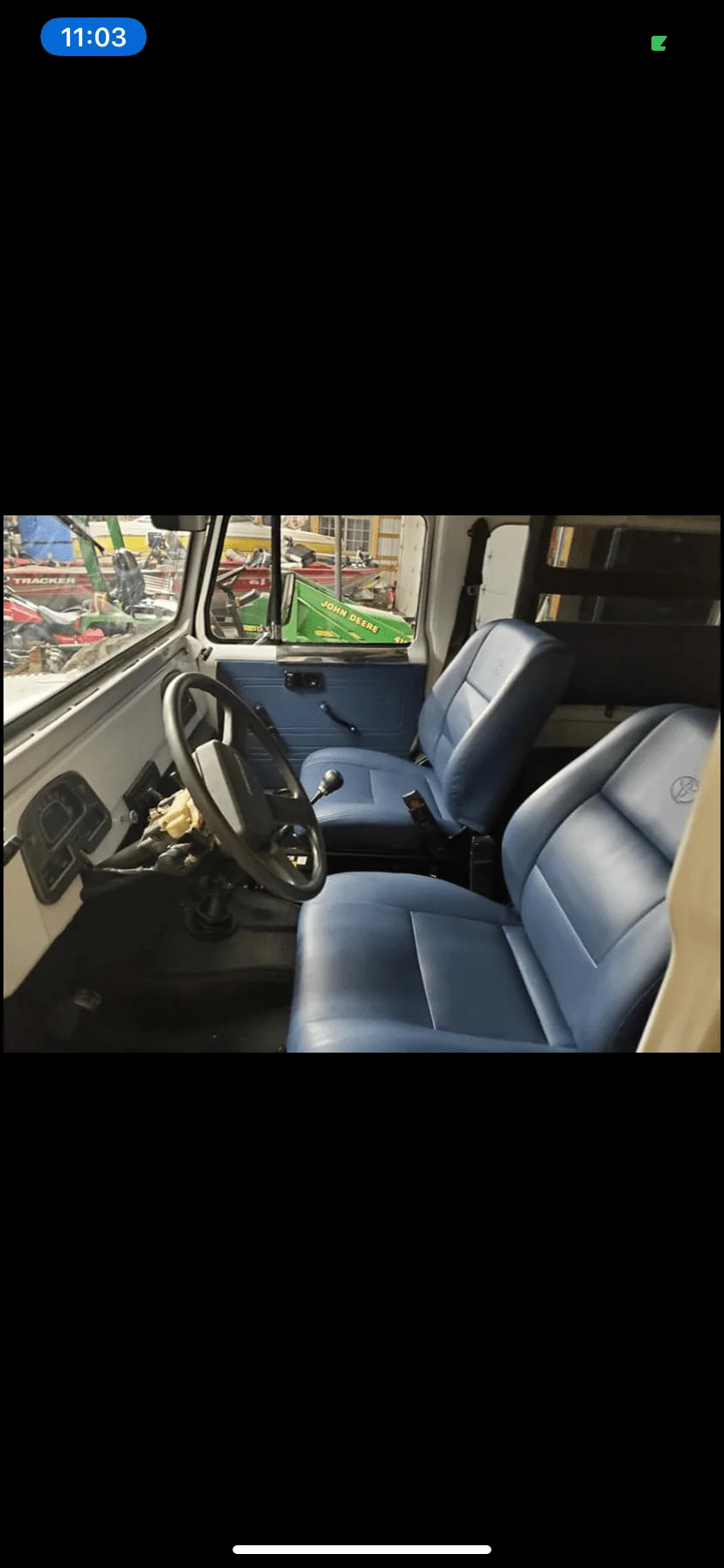

What the hell is that thing!!?? Where are all the dash knobs!!? It has a 70 series steering wheel and it doesn't even have the shroud on it. The roof is strange, the whole rear end looks bizarre. Stay the hell away from that thing, its an aberration.

I don't hate it from the outside. However, I agree with others that it probably has some hidden gremlins. and will most likely not be turn key.

No heat. Pretty. Dash is odd, cheap respray, odd fixtures. Flame me. I have never seen a SA truck that is more than lipstick on a pig. Major FUps. If you enjoy a major PO bitch session, have at it. Paint is pretty because it’s fresh. Never seen good paint prep. Rust always bleeds through. Ask for detailed resto pics. If they don’t have it, run.

I agree with everyone else. This thing looks like a basket case. I believe you can find a much better example for the money you have to spend.
