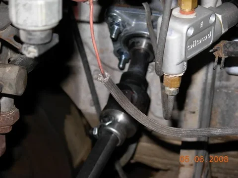

Just finished my saginaw conversion.
test fit before welding everything up. I also decided to add a 5/16 plate where the box penetrated the frame for a little extra strength
I used the Borgeson 36" DD telescoping steering shaft- It fit between the motor mount and frame.
Ready for some rocks now:bounce::bounce:
Tim:steer:

Whats the deal with the wire ties :eek:

My guess it they are to hold the rubber bellows boot to the steering slip shaft to keep debris out. These are found on many factory setups and are normally held on with metal band clamps but a zip tie can do the job just fine also I bet.

John Smith was correct- Just a dust boot- like they use for shocks. - BTW- I did trim the excess off so it would reduce drag and friction;)

Thanks for the nice comments- I took way longer on this than I should have out of a desire to do it clean, right, and have something safe! I kept my stock stering shaft- just cut it above the rag joint. I had the u-joint at the shaft connection welded on by a professional- again with keeping safety in mind.
The shaft was a 36" DD with a 1" bottom and 3/4" top. It cleared the motor mount and frame barely- but with some wiggle room.
I would strongly reccomend this shaft and u-joint set up for anyone doing this conversion- it's just superior to a solid shaft set up and the u-joints are trick sealed bearing units.
