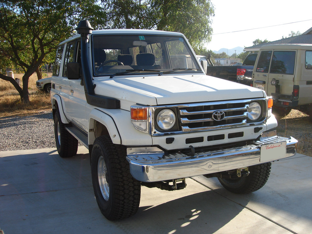

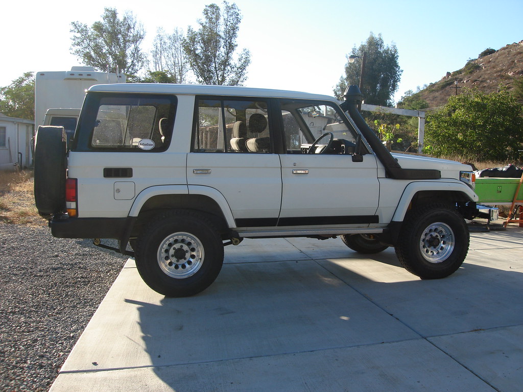

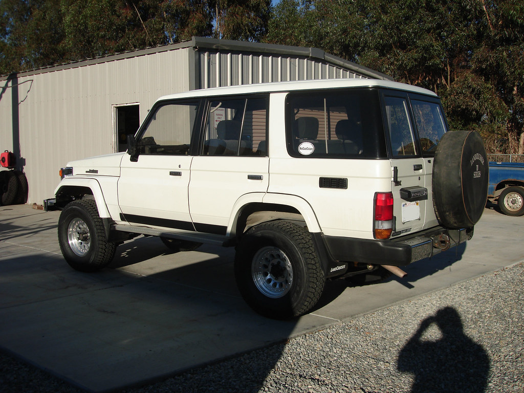

I have a HZJ77 with Extreme valve body and billet torque converter in the A440F as well as a Turbo glide turbo charger, slight lift, 33" tires and I think it will tow 5000lbs with no problems. I think you would be fine with the airstream but you need to put brake controller on it. Here is a few pics o mine, I think they are pretty rare in the US :D
Cheers,
Michael
