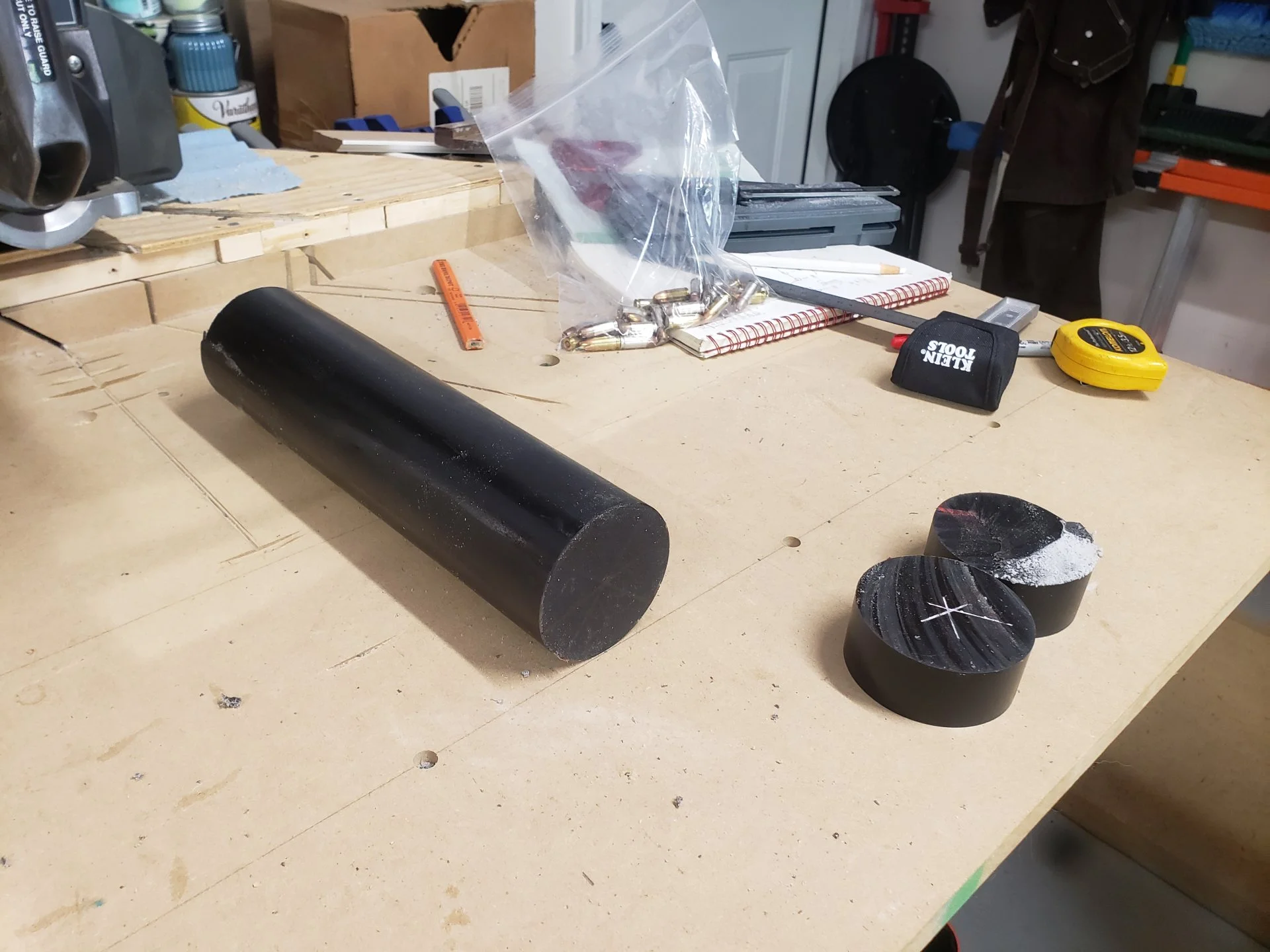

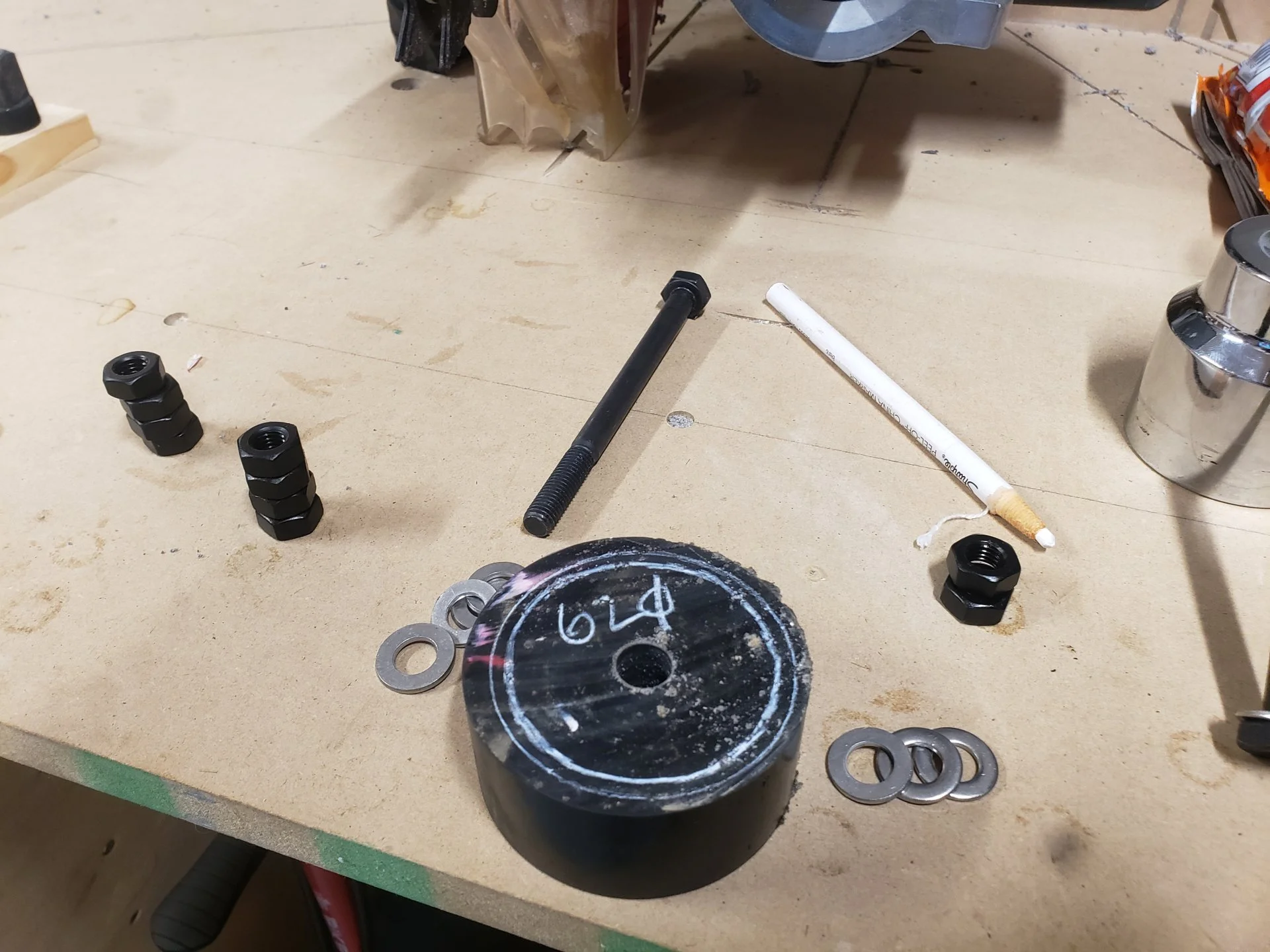

Well seeing as these are only a spacer and I'm keeping the original rubber bushings (mine were in decent condition) I got 3" diameter, 12" length, 90A durometer polyurethane cylinder from universalurethane.com and cut it to 30mm thickness
I then drilled holes in it for the bolts to go through. I got some 10.9 metric bolts, washers, and nuts from McMasterCarr in 130mm (qty 10) and 190mm (qty 2 for the front) lengths.
And Bob's your uncle! A cheap DIY body lift kit! ^_^

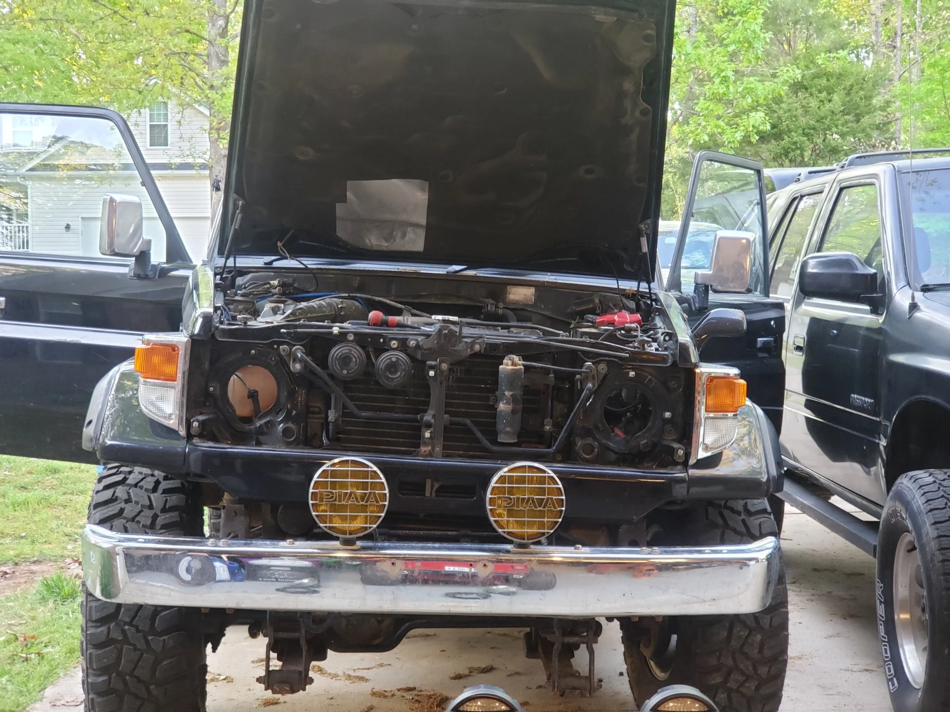

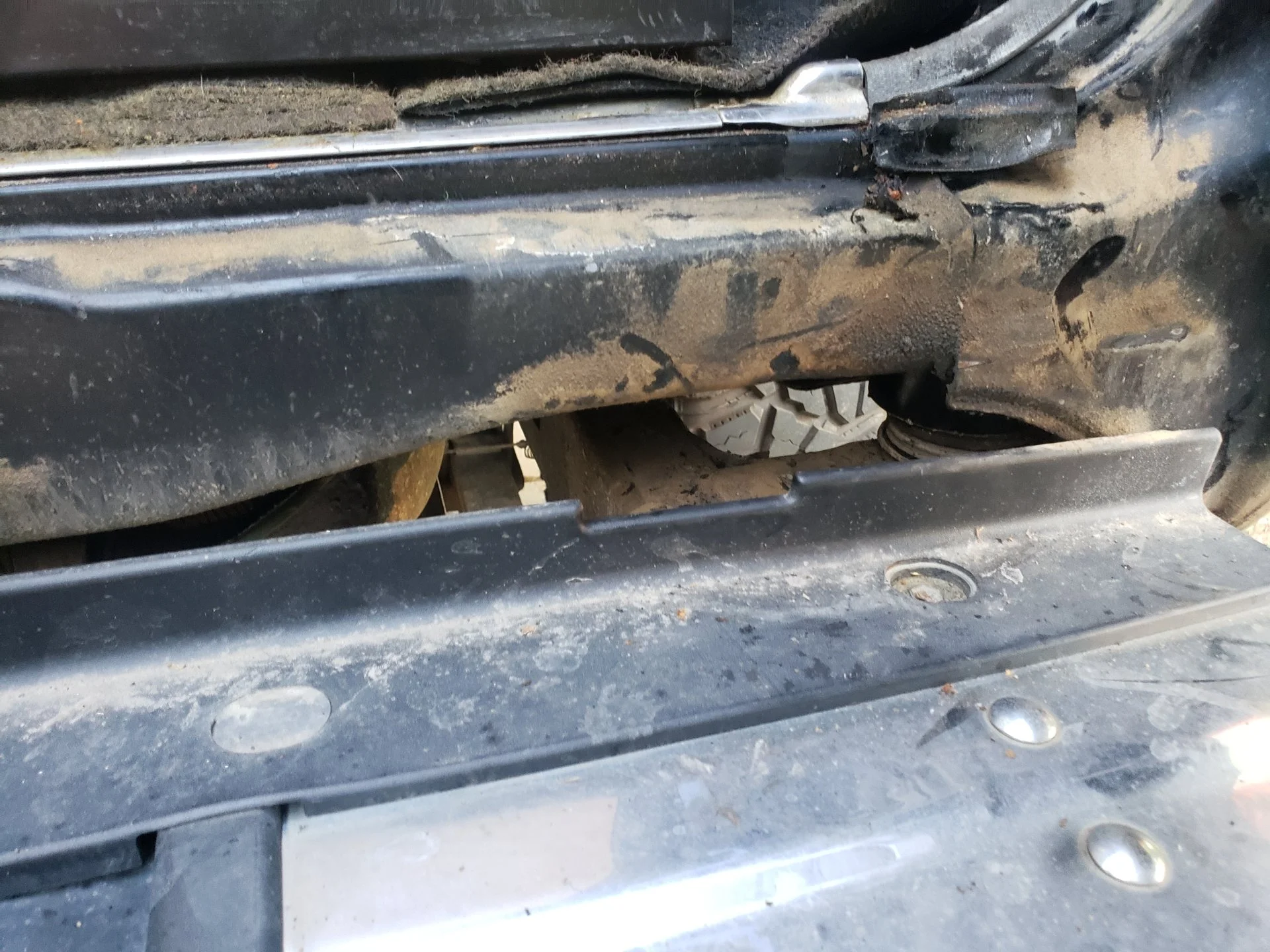

I was originally planning to cut the discs down to the diameter of the OE bushings, but I found that I only had to shave a little bit of a chamfer onto the front pucks to fit into the cups, otherwise I put the rest of them between the body and the original bushing. Worked out great, no issues over the past month I've had it installed. And best of all: my tires don't rub any more! and I didn't need to extend my bump stops~!
Oh yeah, to get the pucks in there, I just unbolted all of the OE body mount bolts, put a jack with a 4x4 on it against the pinch weld, and slowly jacked the body up enough to fit the pucks in over the OE bushings. I didn't have to adjust any lines, hoses, or electrical connectors, but there is one heater hose from the engine that you need to keep an eye on.
I also forgot that the radiator is mounted to the body and not the chassis... so I clipped the fan a bit on the shroud when I first tried to start it... :doh:
Had to take that off in a hurry so that I could make the trip back home :rofl:
