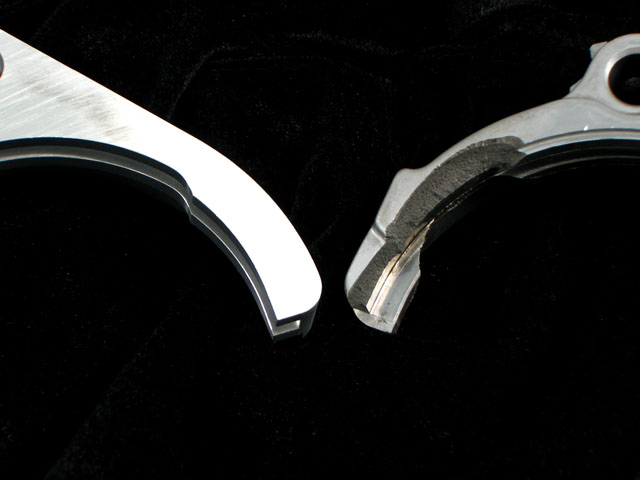

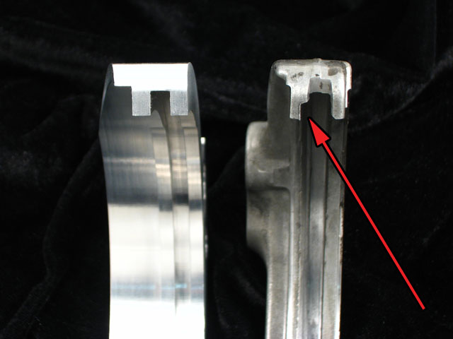

I notice Marlin sell a stronger 1st to 2nd gear shift fork for the R-series 5 speed trannies...
Billet Shift Fork, R-series | Marlin Crawler, Inc.
...and a heavy duty bearing cover...
Comp Series Transmission Bearing Cover Plate | Marlin Crawler, Inc.
Will probably put these in when I get my R151F rebuilt, if someone that knows these gearboxes thinks it would help.
Are there any other improved parts for it, or other ways to strengthen it?
