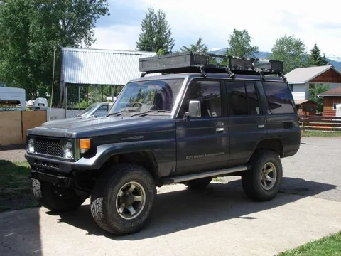

here is a pic
Hi,
The HZJ77 has leaf spring all around,rear leafs are superlong,OME don't make springs for the 77,may be one from the 45 will work.mine has ZEAL 3" lift fro mJapan.
electric hubs.
Electric lockers but hard to find.
mine come with power windows,p door lock p sunroof,electric 24V winch.
it is for sale.
Simon
Winnipeg
5 speed?, kms?, rust?, price?
again
5 speed,140,000km,no lockers,Zeal 3" lift,ARB bumper,roofrack,snorkel,home brew turbo intercooler,3" exhaust,24v electric winch,custom rear bumper with tire carrier,full float rear,Ispro pyrometer and boost gauge,converted to run on WVO,130 liter stainless tank on left middle underbelly of truck.
impreza hoodscope.
Asking 24K OBO.
sorry 22K OBO
Took it to Alaska last summer
