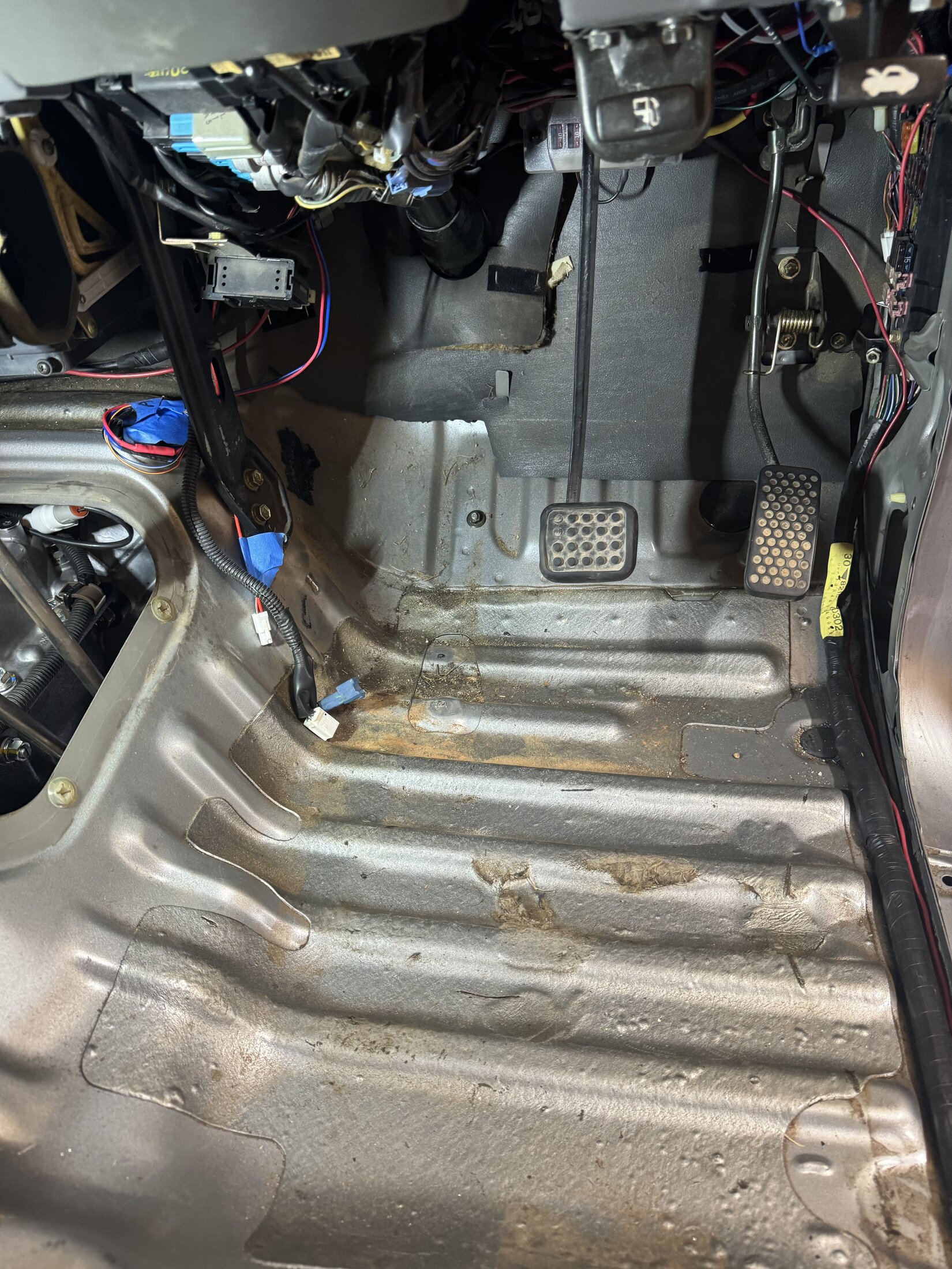

2. Source the bolt in clutch box/pedal he used. There is absolutely no need for a booster, it is a very easy to press clutch.

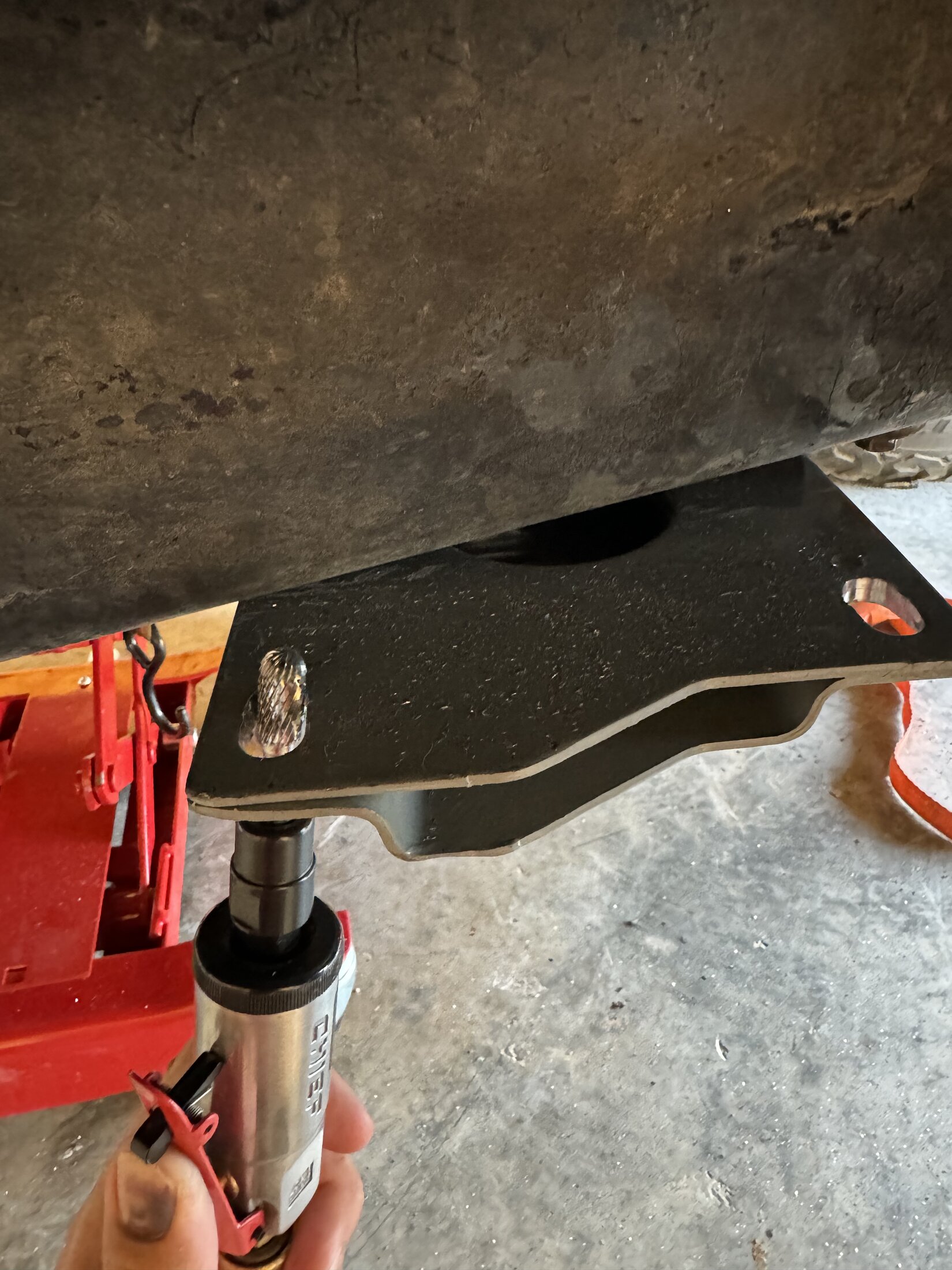

3. The RH gussets (51321-60090) for the coss member to bolt to are not available anywhere I could find (partsouq, megazip, amayama, toyotapartsdeal, etc…). So i bought 4 LH gussets ( 51322-60080) and used a die grinder to oblong the holes in the cross member to fit the gussets.

5. I used my factory brake pedal and just modified it to be clutch friendly.

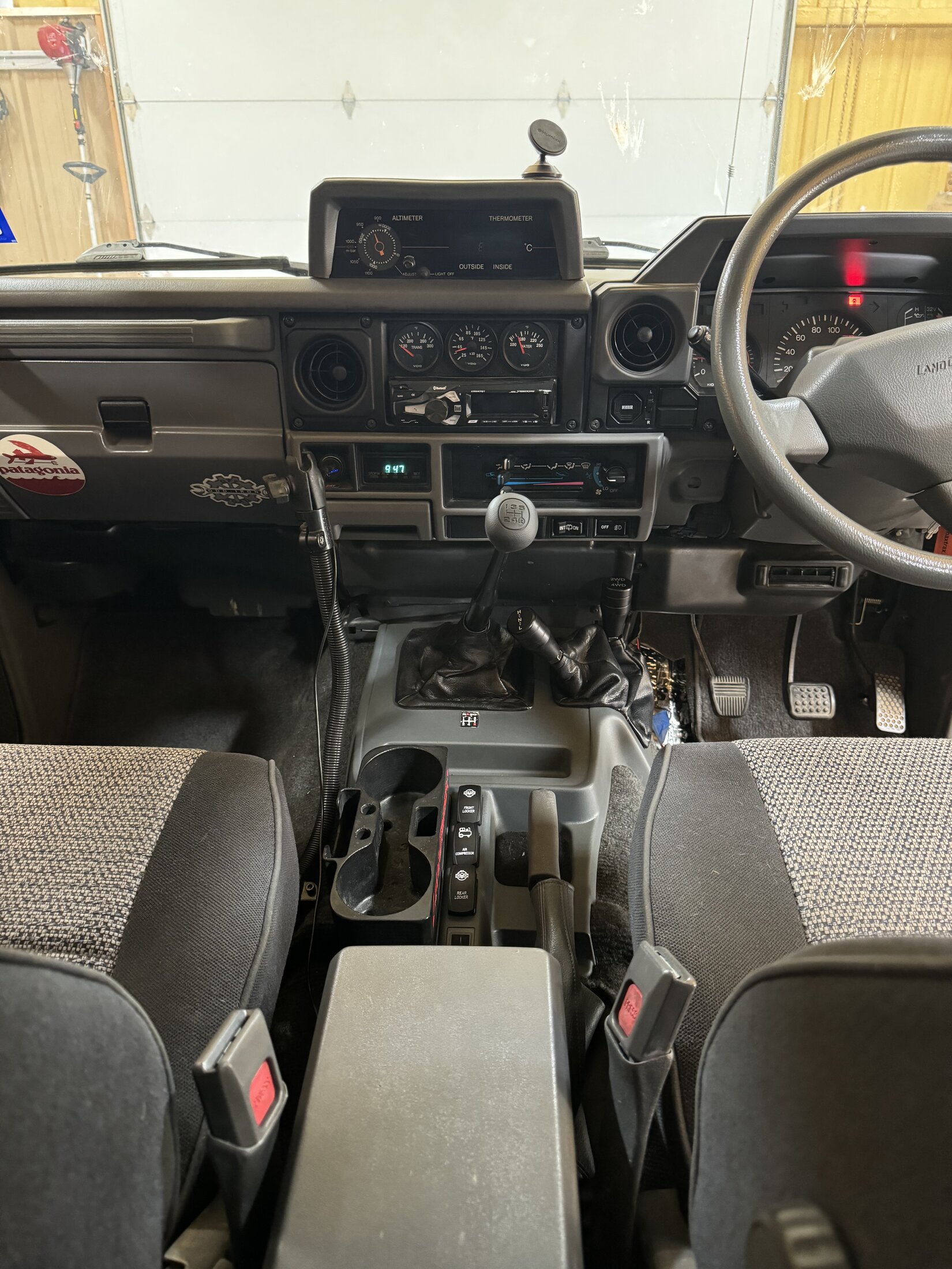

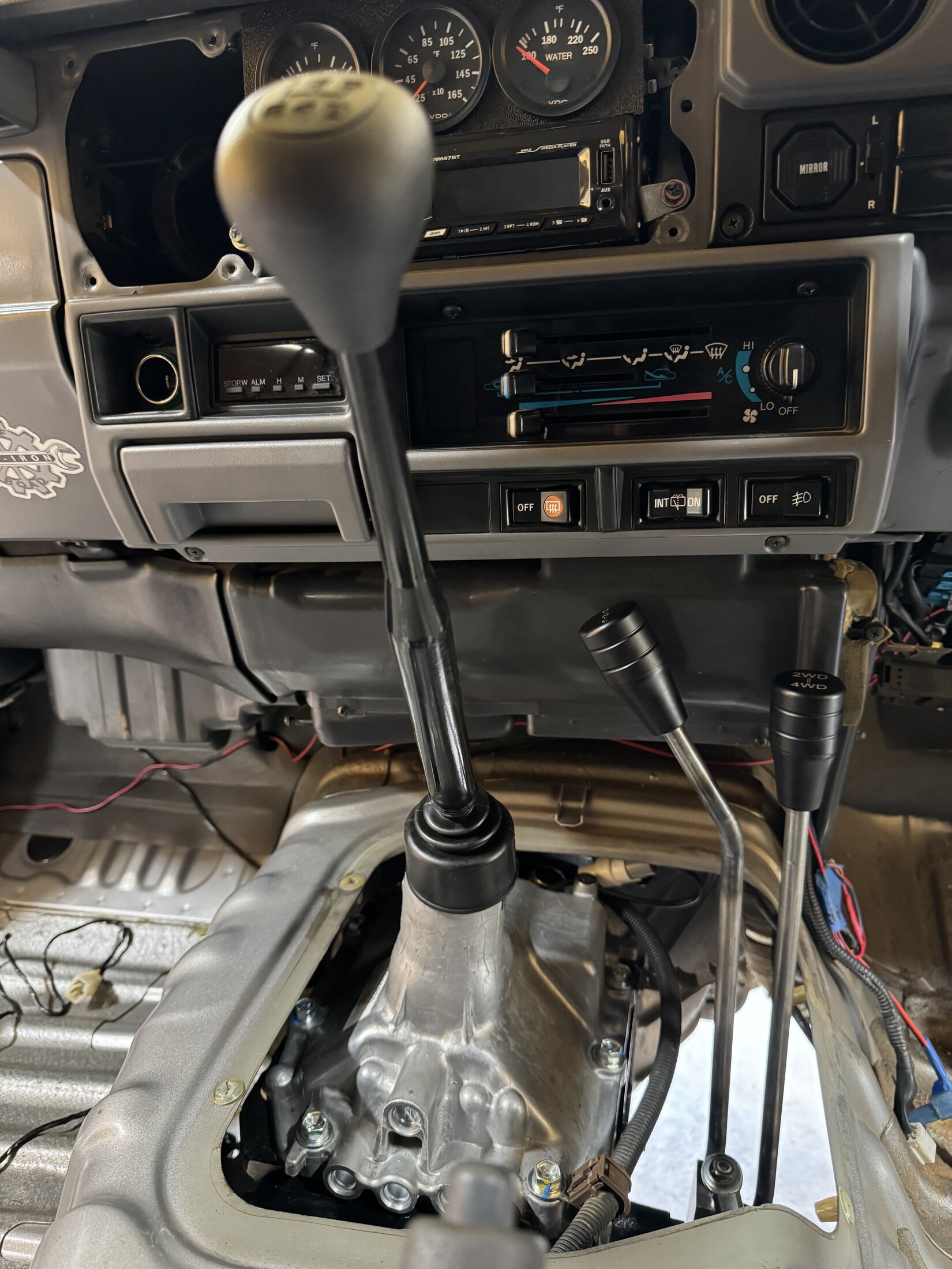

6. I used a twin stick tcase shift kit. Im on the fence so far. Seems like every time i think i have it right I hit a wall and need to bend s*** again.
7. @Zee was imperative to sourcing the console/clutch pedal/clutch line I needed. I have not started installing the interior yet. Will update as I get there.
