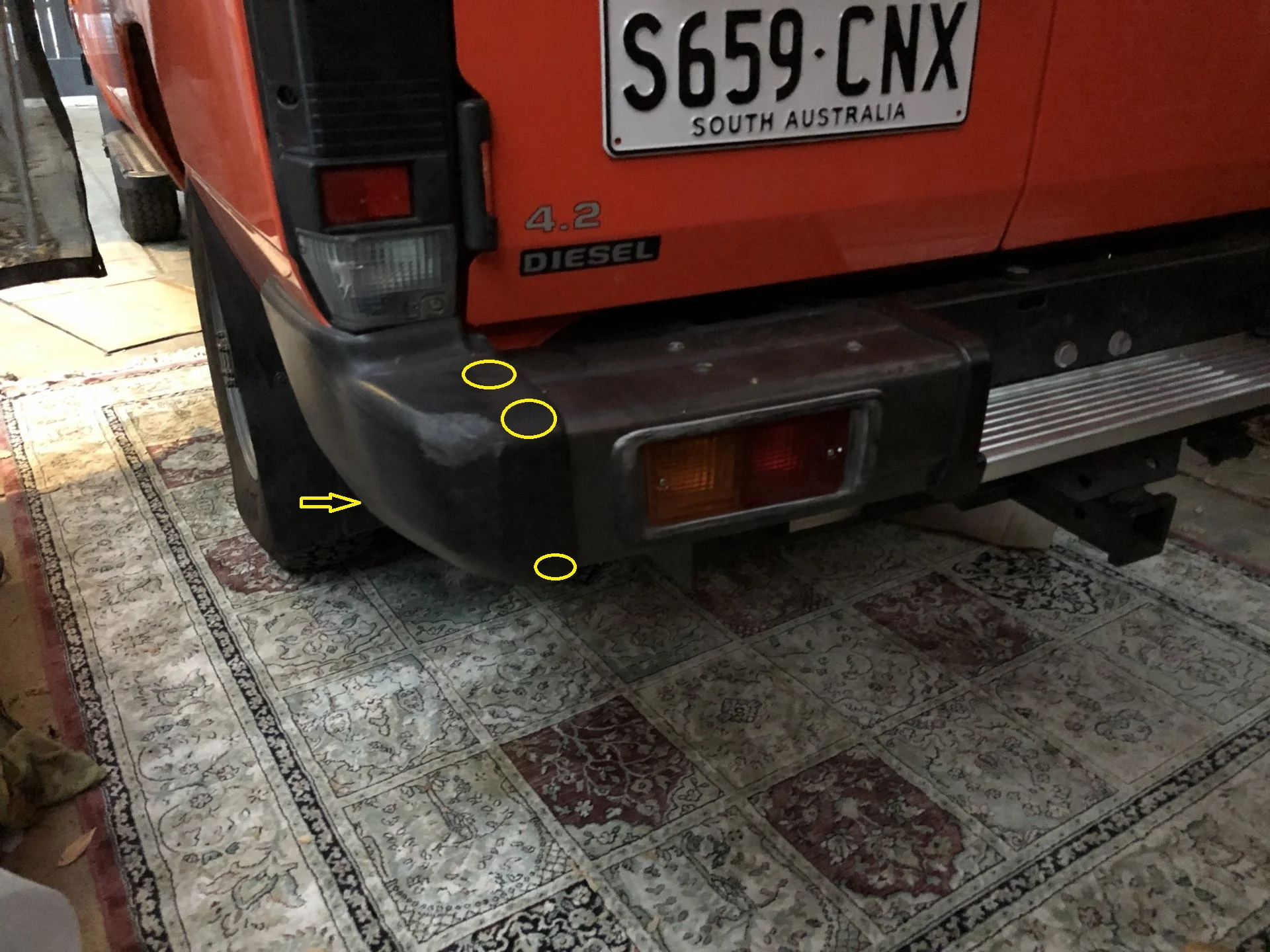

I was just worried that I would have to get at something from the inside of the rear quarter. sounds like it is all under the truck. Correct
Hello,
Three bolts are inside the bumper ends, not under the truck.
One bolt is on the lower front corner of the bumper end.
I have marked the bolt locations with yellow. Three inside, one (arrow) on the side.
You have to reach the three circles from within the bumper. It is tricky at first but you get used to it quickly.
The arrow indicates the other bolt, accesible from the outside.
