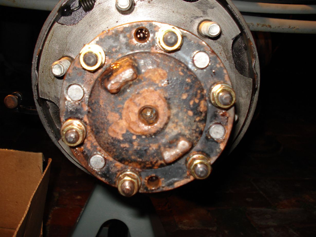

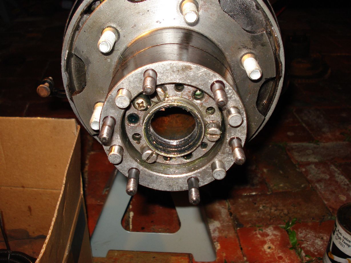

its a pritty common problem in the early FF hubs.
This is how i got around the problem
4x 10mm dowels
yep, you MUST have the dowels since they are what takes the torque load (not supporting load, duh). the 6 nuts only lock the axle into the housing and are not design to take the torque being transmitted.
4 is better than 2 / 2 is better than none...FJ45s where notorious for rear FF problems...
