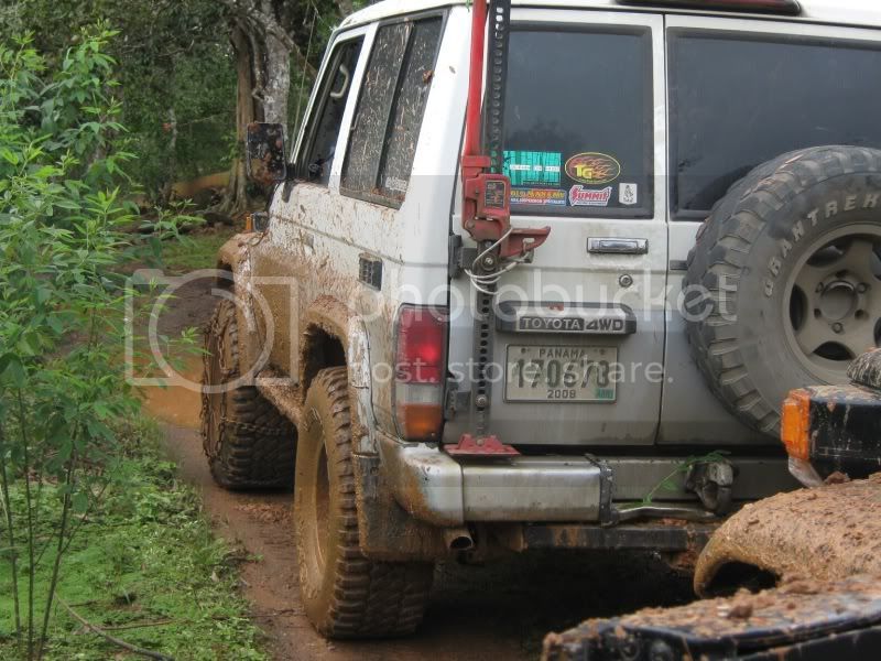

But yesterday I found here in Panamá a 70 series .. that the owner said it's from 98 ( looks like ) with 1HZ engine and H55F with BF1A combo drivetrain ..
That really surpriseme .. coz thought post 90 all 70 come with H150 and HF1A ..
Here tha pics ..
plate ..
here tha tranny and t-case ..
there is always Toyota with something new ..
tha Cruiser .

What is that blue truck in the 4th photo? An old Nissan Patrol?
Yet it is .. a couple of 'em here in Panamá ..
