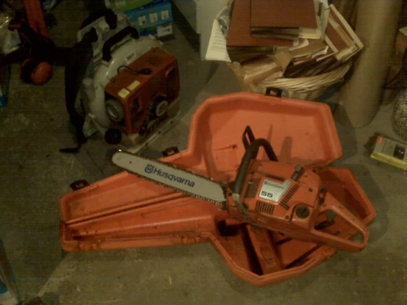

Had both of these for quite a while. Both still work pretty well, but have annoying quirks that I would like to fix for my dad, who is the primary user.
The Rancher 55 works great and always has, but has always leaked bar oil when not in use, see the case. It will leak out all the bar oil in between uses, but seems to oil the chain fine. Before I tear into it, any parts I am likely to need?
The BR 400 starts and runs fine, except for full throttle. It will occasionally reach top RPM but often won't. Notice the air filter cover is removed, with this cover removed, the blower stays at top RPM more than with it on. This points to an air restriction, but the air filter is clean. Fuel is carefully mixed with fresh, no ethanol gas and Stihl oil. Perhaps I should replace the air filter anyway, and go from there.

The Stihl blower?
Thanks for the link. I will check for a clogged vent similar to what D'Animal describes for a Stihl.
Uhhhhh, yeah, the stihl blower pictured in the picture in post 1. :o
