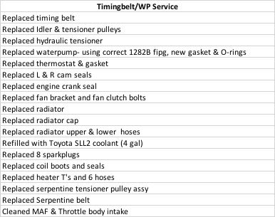

I just did mine last month, here's my summary:
Special tools I had to buy: the Schley pulley holding tool, a pulley puller, and of course the spendy FIPG - don't forget that:
Amazon product
Forgot to mention - if I were to do it again, I would replace the upper and lower radiator hoses with new clamps and maybe the outlet coming out from the thermostat, it was pitted. I've had a small amount of leaking from these engine side connections. I'm hoping it will just go away....... :oops:
