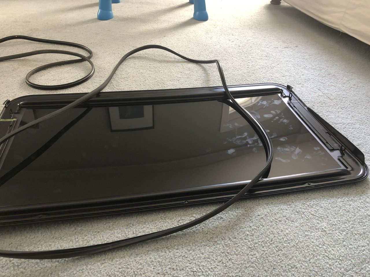

On my third 200 series LX and am experiencing both water intrusion when washing the car and extremely excessive wind noise when driving and the shade is open. This noise is unlike any other LX I’ve had. Some noise is normal, this is very annoying to where it can affect in cabin conversation.
Does anyone know the part number for the sunroof seal and or how to remove and replace it?

no way - you can (I have) replace the seal. A few torx gets the glass out (behind the accordion plastic). Remove it and replace seal.
part -63251-12190
Yes!! Thank you. You’re the man. How long did the job take? easy for an inept diyer?
the hardest part is getting the sunroof in and out without hitting the paint. I was solo and used a few towels.

Could you shed some specific light on what you had to do to remove the glass?
Raise the glass up, remove the accordion plastic which reveals torx bolts on each side (I think 2). Unscrew and lift the glass up and out (I didn't have a roof rack at the time). I think you could also angle it down and through the cab.

I did get the glass out that way...replaced the seal.

FYI I ordered the Lexus part for my LC and did it with the glass still installed. Tilt up, remove seal, reinstall what you can of the new seal, press it it into place, and the last bit was en exercise with a flat plastic tool to get it to seat right. Under an hour of effort
I did this project as well. Watched two different YouTube videos for guidance. Fairly simple project. I would add some sort of silicone lubricant to help the gasket go onto the glass. The worst part of the project was ensuring the glass is level with the body panels on top.
I highly recommend doing this and should have done it a year ago! I also recommend cleaning the body panels that the gasket seals to.
