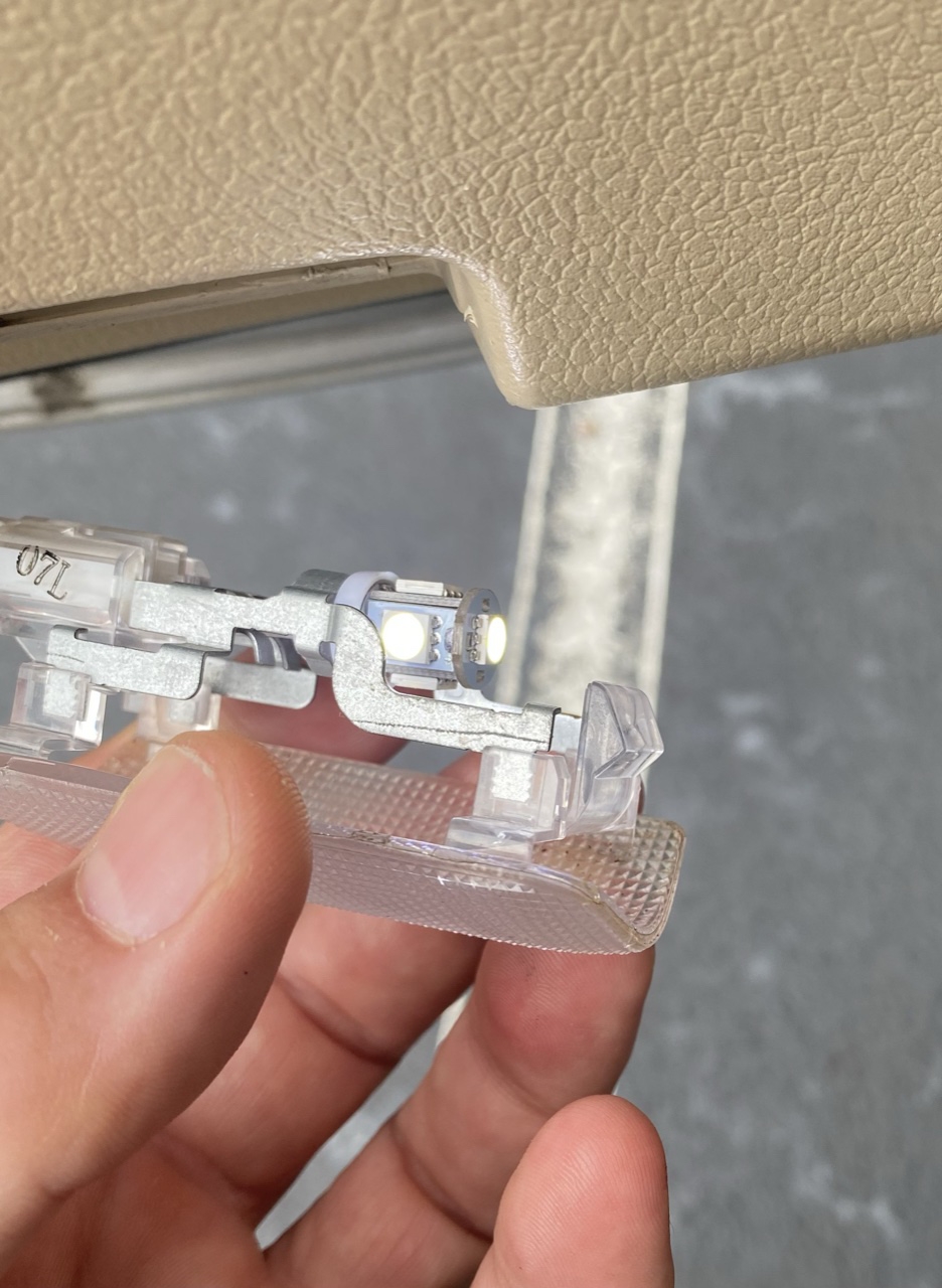

You know what they say about a picture being worth 1k words.
Thats awesome, thanks for the pics, it makes total sense now.
I was picturing that the clear plastic brackets holding the light were the clips holding the cover in which is why I was trying to pull from the other angle.
I know what you mean. And the best part is, on some of the interior lenses, the bracket parts you can see through the lens are where you pry from. I just did the LED kit that @FullyLitLED is selling. So I've taken them all off now. If you don't have one of those little pick sets like the one I pictured, I highly recommend. Can't believe how long I've been taking apart electrical connectors and trying to remove tiny clips without them.

I've got a pick set, they are super useful. For any kind of interior car parts I try to use my plastic tools first because I'm the guy that tends to snap parts off because I'll think "maybe if I just pull a little bit harder... *crack*". But now that I see how it's put together, I'm not worried about using the picks.
Cant thank you enough for the pictures, everything just makes sense now.
