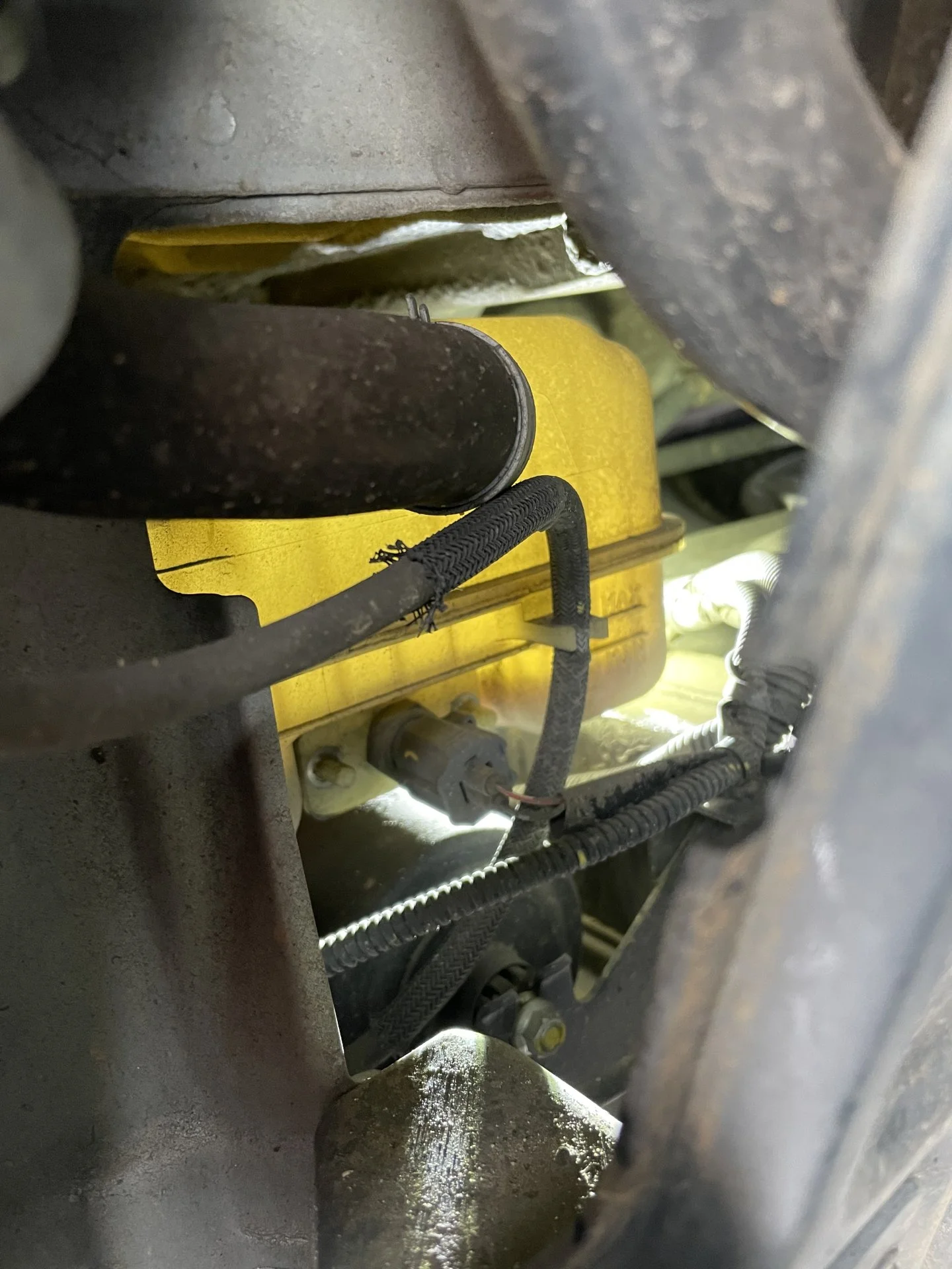

Is this a 'normal' level?
Looks like it’s low but not empty. If the truck is in ‘HI’ the fluid should be near the ‘min’ line. Might just need more fluid or have a leak somewhere.
