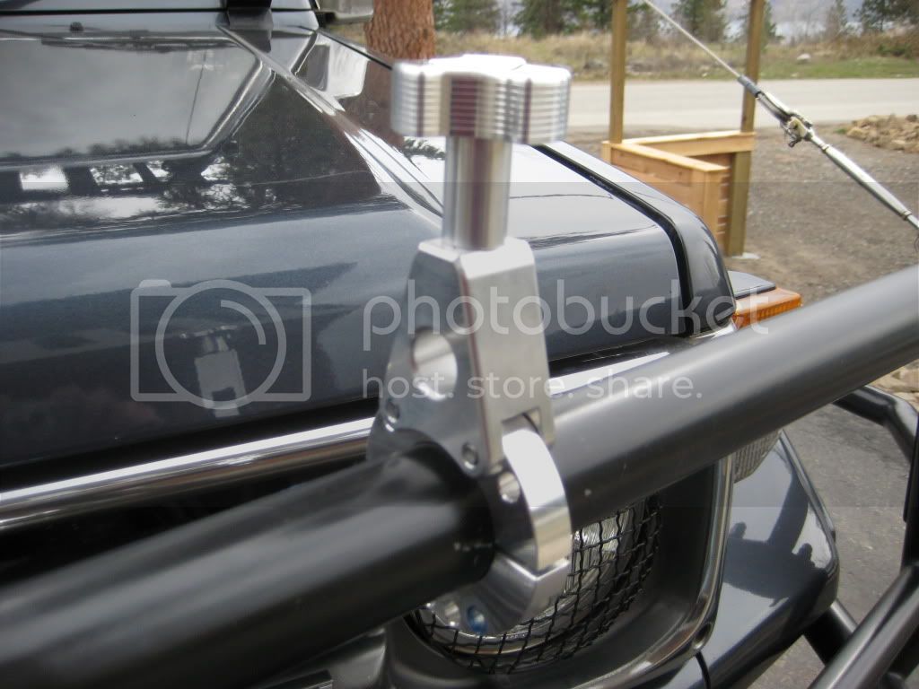

This got me thinking on where and how to mount my jack. I didn't want to do any more welding on my finished front bumper so I did a search for mounts and found these:
The are absolutely solid! The knobs are a good size and they bolt up slickly. Took about ten minutes. I got them from Luke at Fourtreks. Nice guy, and helpful. He also makes other mounting systems. Used locktite to help them stay on and they are serious bling. My sweetie thinks they look like weapon mounts. The stainless hardware is good and the threaded rod for the knobs is the same thread pitch and diameter as what is used for propellers on out board motors. You can get locking nuts for them.

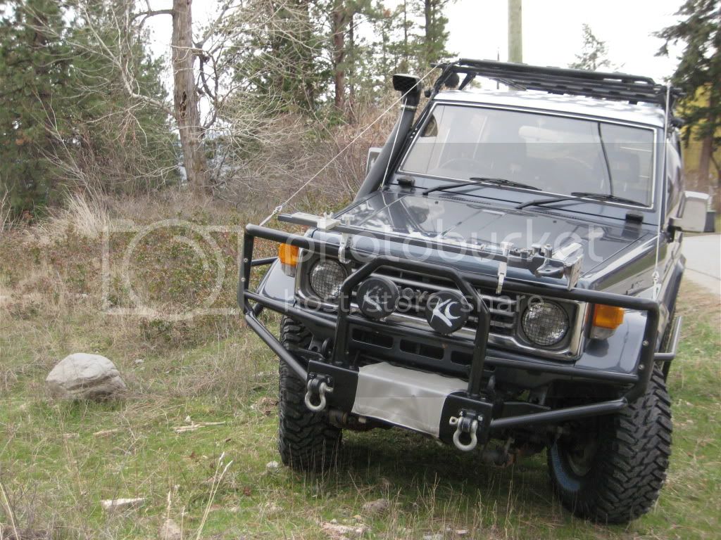

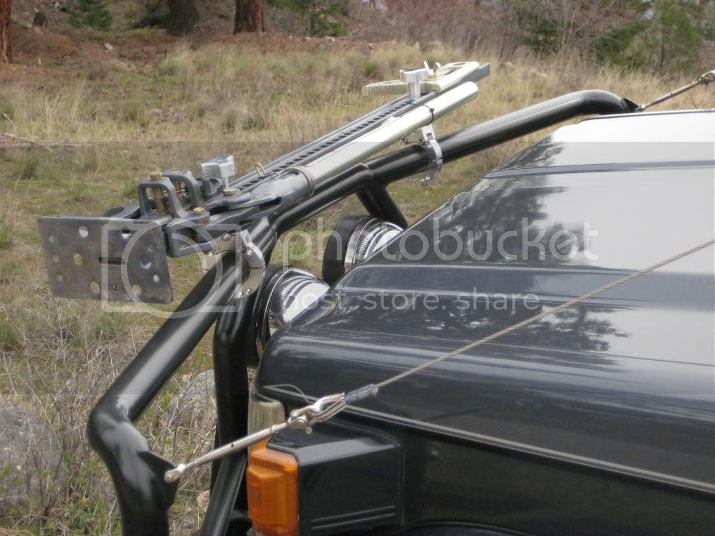

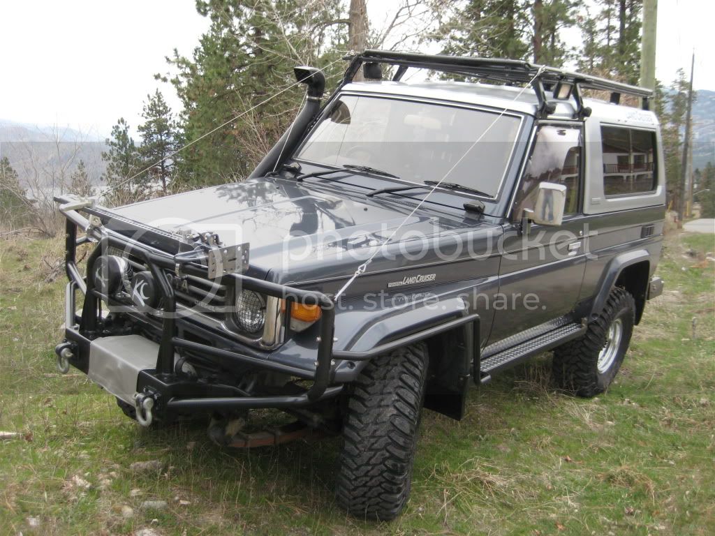

Here's a few pics of the jack mounted.

Isn't it dangerous to have the hi-lift mounted on that location? in case of an accident those mounts might break and the jack could get thrown straight against the winshield.
Just a thought, looks good though.
nice looking ride but use the same mounts and mount it off the side of the roof rack or the back...
just saying...
Hmmm. some interesting points about an accident. Didn't occur to me and even though I don't run the jack daily, you never know when you might hit a moose or deer on a logging road.
Might have to move these to the side.

What are those guid wires from your front bar to your roof rack for?
Currently thinking on moving the mounts up to the roof rack.
I have a rear swing away and with the tire, tool box and jack, there's a lot of movement even though I'm using a 1200lb trailer spindle. Wanted to get the weight of the jack off it too
I'm putting the tire back on the door, and then fabbing a swinging rack for shovel, pick ax and tools. This should lighten the load.
The wires get branches up and away from the windshield when I'm going through scrub. They're made out of stainless cable and marine sailing turnbuckles. The guy at the marine shop said the buckles have a rated 800kg failure point. Should be more than enough for some branches:)

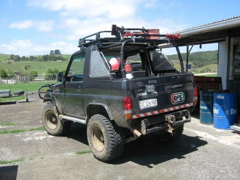

Hi lift mounts
Well here is what i did with my Hi lift . The guys at foretrecks supplied the mounts top gear they even supplied to New Zealand

I have torn off two factory snorkel tops in dense bush, where a thick branch hits the windshield frame and nicely leads the branch under the cap. With no opportunity to stop...it was simply watch it get torn off from the corner of my eye. I've a sense some guide wires would have given the cap a fighting chance.
gb
i like the idea of the guide lines...
of course Greg you could turn the working end towards the windshield if it is a Safari, if it is factory... well, that would get expensive fast.
The guide wires went through the top hat of the safari snorkel on my 60 series.
Won't leave home without them and they've been on four trucks. One of my trucks didn't have a bumper to attach them to so I made a bracket that bolted to the apron supports. It extended out of the gap between the hood and the fender. I drilled a hole in the bracket it and was good to go to attach the wires.
