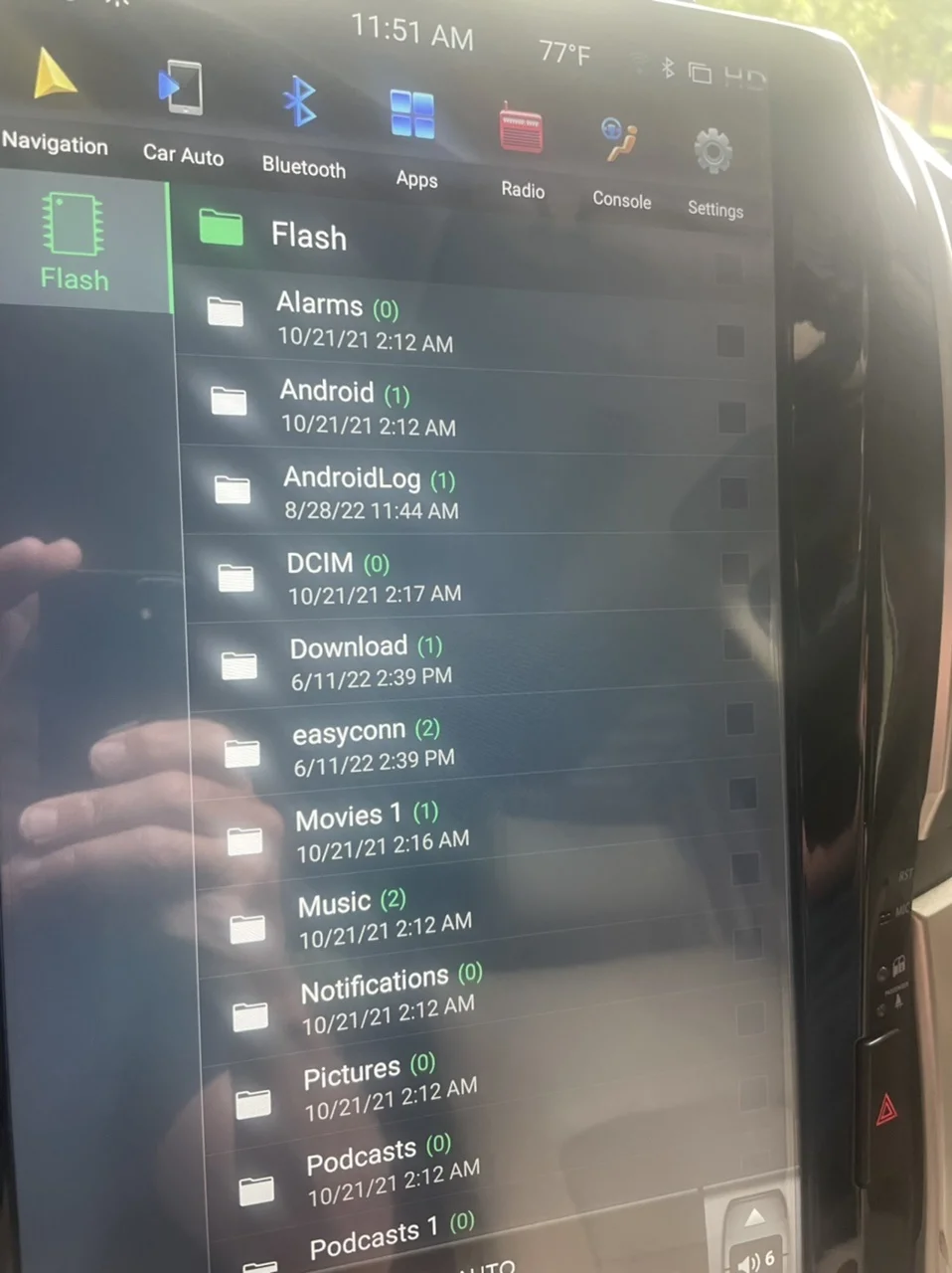

So I want to use a USB drive to store map files. I can't figure out how to make the HU (mine is an EC Offroad 16" for 2013 LC) see the flash drive and use it for the storage loaction. The file manager app only seems to show the folders on the build in flash drive. I also don't see a way within the various nav apps I have to direct where file downloads go. It just seems to default to the built in flash drive location. Anyone one done this? Hey @Romer I'd guess you have done this. Any thoughts?
I plug it in go to file manager and it appears on the left. I select it and copied my files to a memory folder on the unit and remove my flash drive
Oh. I was hoping to just keep the files on the usb drive and have the apps run off it. That way I could just keep all my map files in one place and now worry about storage capacity (I have a 1TB usb).

Initially it didn’t recognize the usb drive but that was because it needed to be formatted. I got that working and can see it in file manager.
