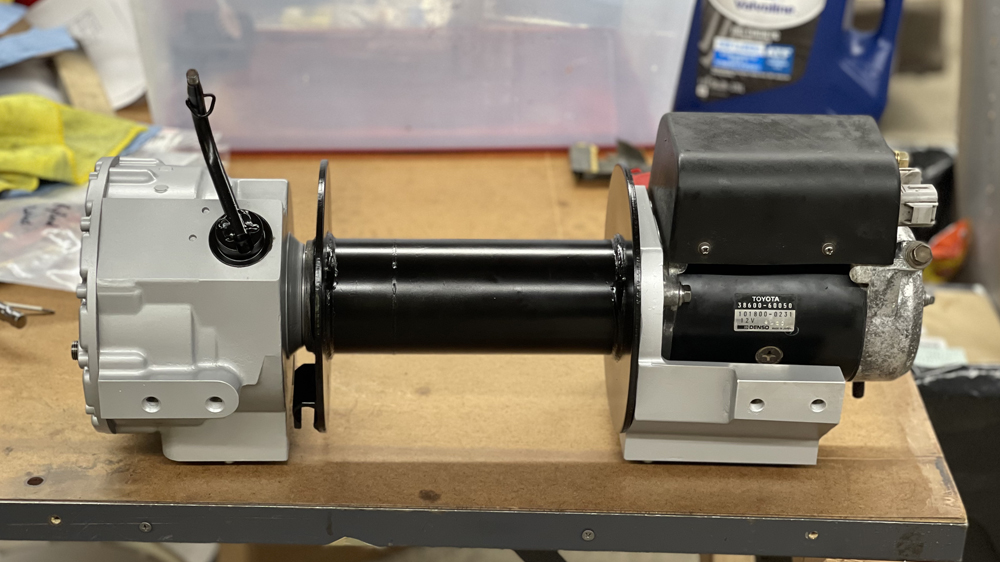

im putting my new to me little pet ( goliath ) here on my 5/89 FJ62LG-PNEK :cool:
well .....
im not saying where my
DEX III Fully Synthetic MOBIL1 point of precision entry is till you chop chop with those TECH. Pics ......
Damn that's nice. Is that from Wits End? I came across their stripdown and rebuild of a winch and it kinda looks like that. So pretty.
