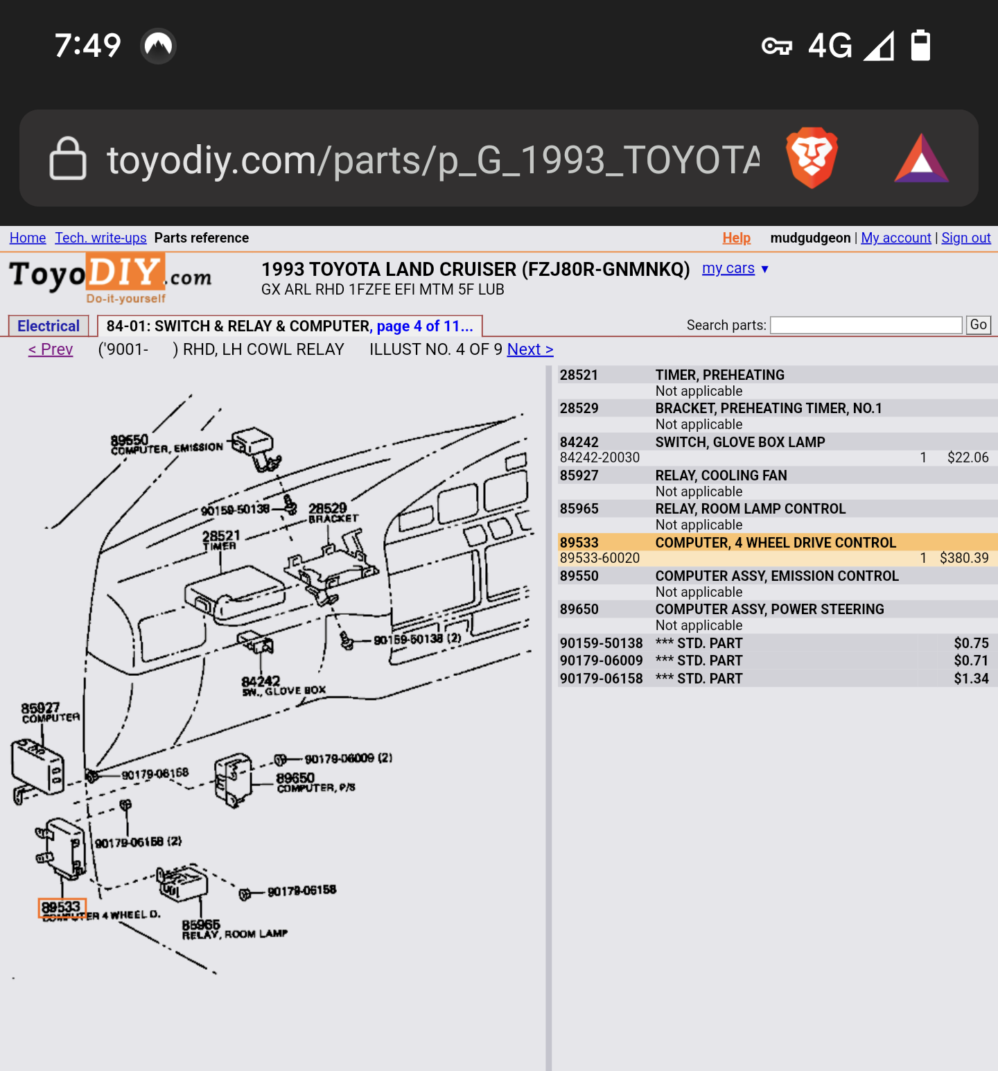

Alternate direction: Anyone have tips on finding the 4wd ECU? I know it's somewhere in the vicinity of the passenger side kick panel / glove box, but I haven't found it yet. If it's somewhat easy to remove, I could swap units with the car I know works and see if that was the problem. (I did earlier tonight finally locate the fuse I think powers the diff lock... I must have looked over the top of it a dozen times as it is *clearly* labeled "DIFF"). My fear since I haven't found it yet is it's behind a bunch of other stuff, so I'd have to dismantle lots of stuff under the dash on two cars to test this idea.
If anyone has a different idea on how to prove whether the 4wd ECU is working correctly, let me know. I thought about testing the voltage at the Diff fuse, but I think I'd just be testing the battery voltage (usually fuses are closer to the battery). I guess if I have already disconnected the actuator per the above post, I can simultaneously check the signals reaching the actuator... royal pain, however.

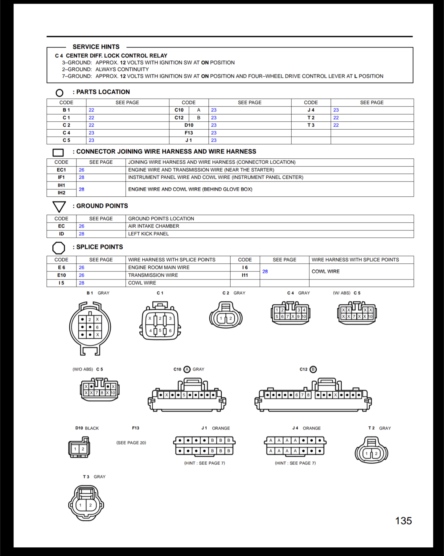

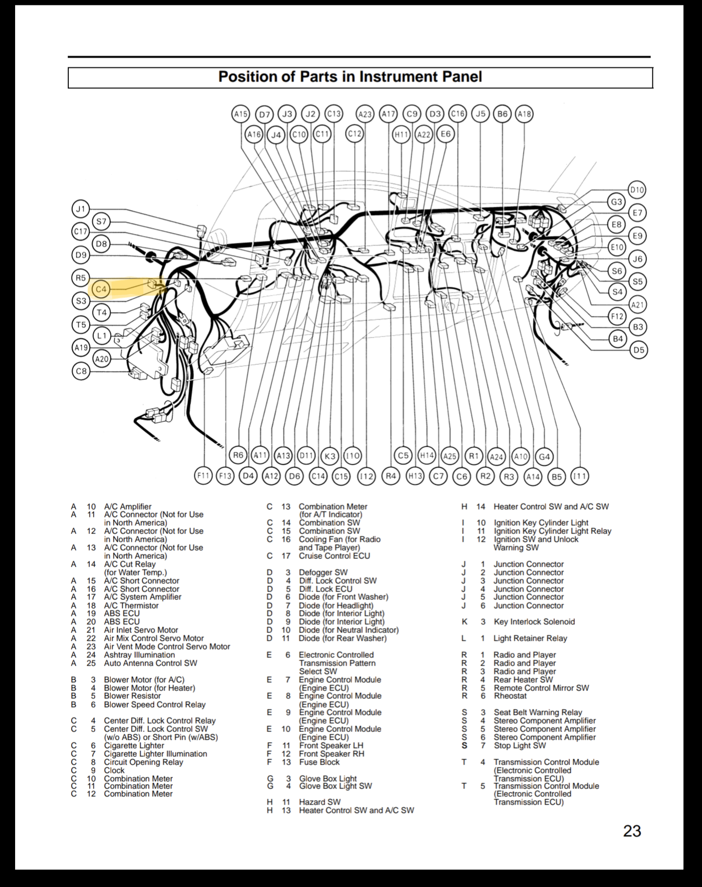

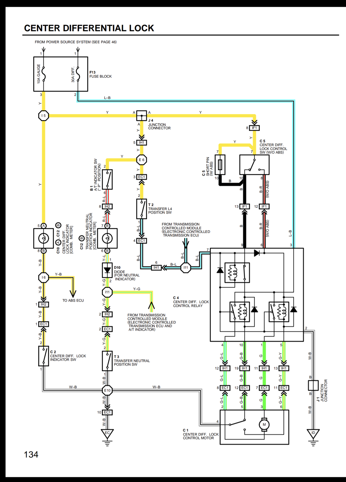

I found a full EWD for a 94 US market FZJ80. The key points will be correct, but reverse the side everything is on.

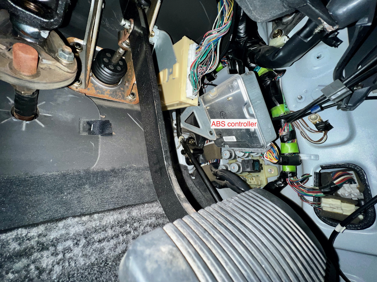

First up, the TRANSFER CONTROL RELAY is high up in the driver side kick panel, for you the right side. It will be above the main relay panel you photographed earlier.
You're looking for location C4 (but mirror reversed)
Wiring diagram (again, not the right model, but the critical circuit information is there)
And EWD notes
And EWD notes
Awesome! Thanks... This explains why I'm clearly hearing noise in the right kick panel area (double click on the car that functions correctly, single click entering low range and no click when using the dash button to override the "lock" command). The picture of the transmission relay helps a ton... Now to find the bastard. Cross my fingers it's easy to remove and I can swap the units in the good bad cars to see if that relay is the problem. That's my leading hypothesis at the moment given the sound differences between the working and broken cars. If it is that relay, the part is in stock... not super cheap at about $160 with shipping, but can be found.
I've confirmed the DIFF fuse is fine both visually and then to double check my work, swapped it with a new one. It's not the GAUGE fuse either... visual inspection plus all the other gauges work fine.

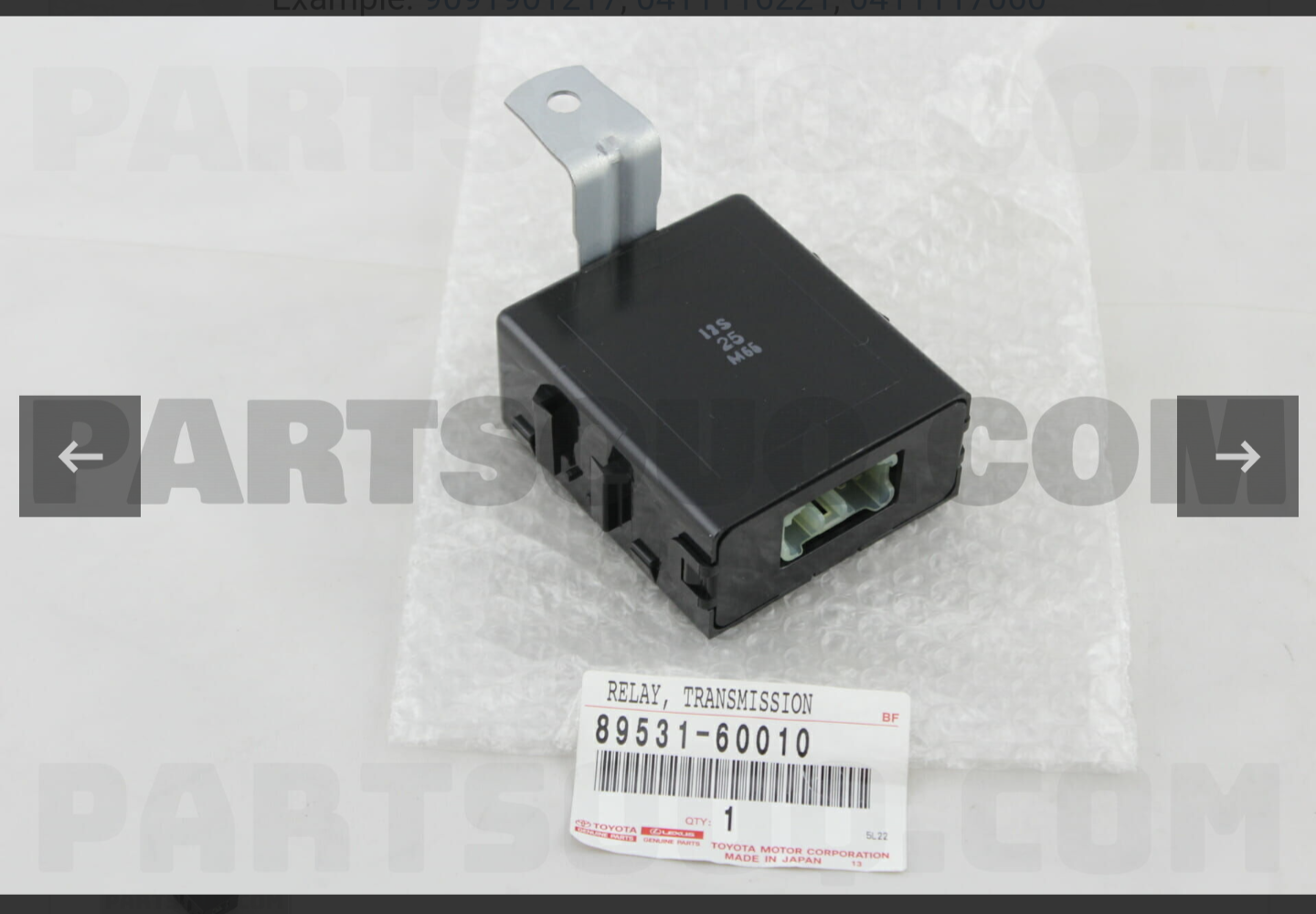

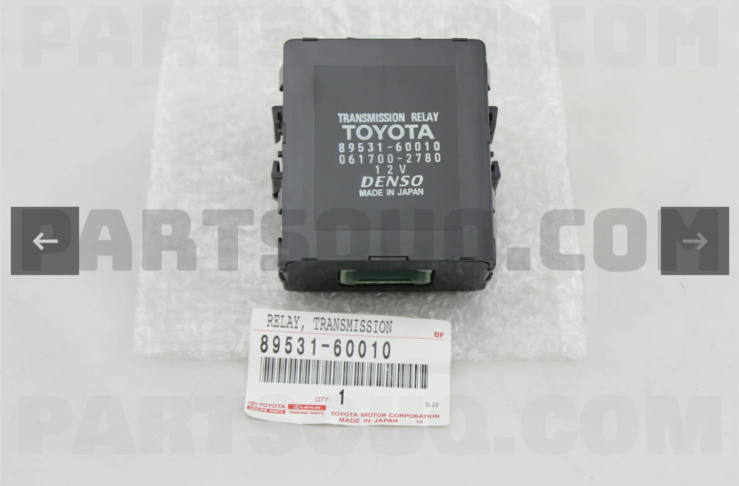

More detail... for anyone going down the same path later. The Transmission Relay is indeed behind the drivers side kick panel (right side for my RHD) and it is for sure the piece that makes the clicking sounds when you lock the center diff. It's mounted behind the ABS box, so to access it, I had to remove the ABS brackets and lay the box to the side, then there's a single nut attaching the Transmission Relay to the sidewall. On one of the cars, the ABS box easily flopped to the side out of the way after nudging a couple cables around. The other had an extra set of wires blocking the path and I had to remove one of the triangle mounting brackets from the ABS box to allow me to maneuver the box out of the way. The first photo below is with the ABS box already out of the way and the second photo shows the ABS box's normal position sort of blocking the Transmission Relay (the mounting bracket on the right side hasn't been re-attached in the photo).
So that's the news helpful to others. The bad news for my case is I swapped the Transmission Relay box between my two cars, but the center diff lock problem didn't move with the box, so the problem is not the Transmission Relay.
I'm going to stew on it a bit longer and see if I have a genius idea for other solutions or tests, but I'm nearly convinced... maybe I already am convinced and just don't want to admit it... that I need to replace the CDL Actuator. I'm sure I'd end up taking it to my mechanic for that... uncomfortable access without a lift and not something I'm ready to tackle right now.
Referring to this diagram:
You should have +12V on pin #9, and GROUND on pin #10 of the control relay in order to unlock the CDL.
