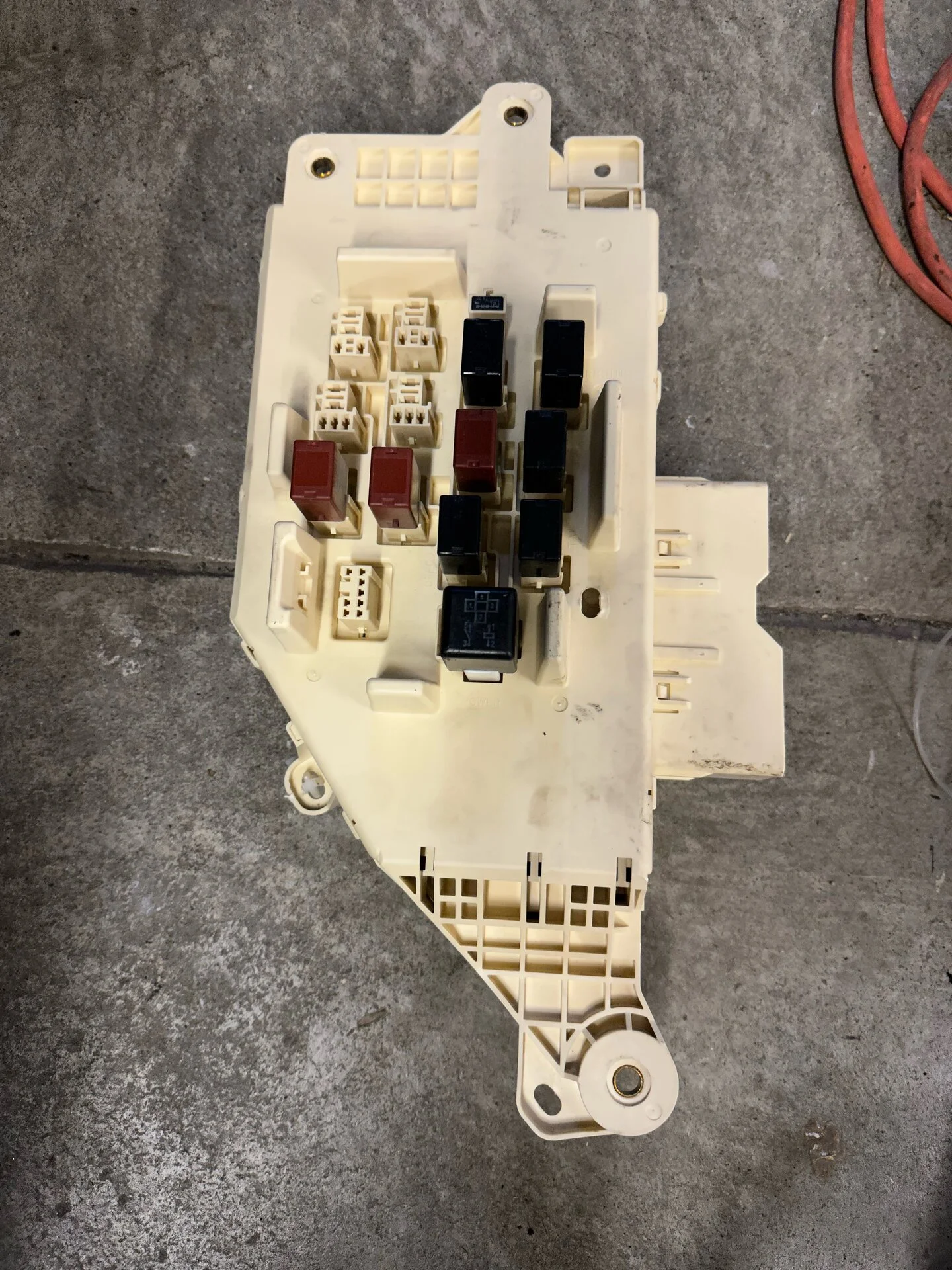

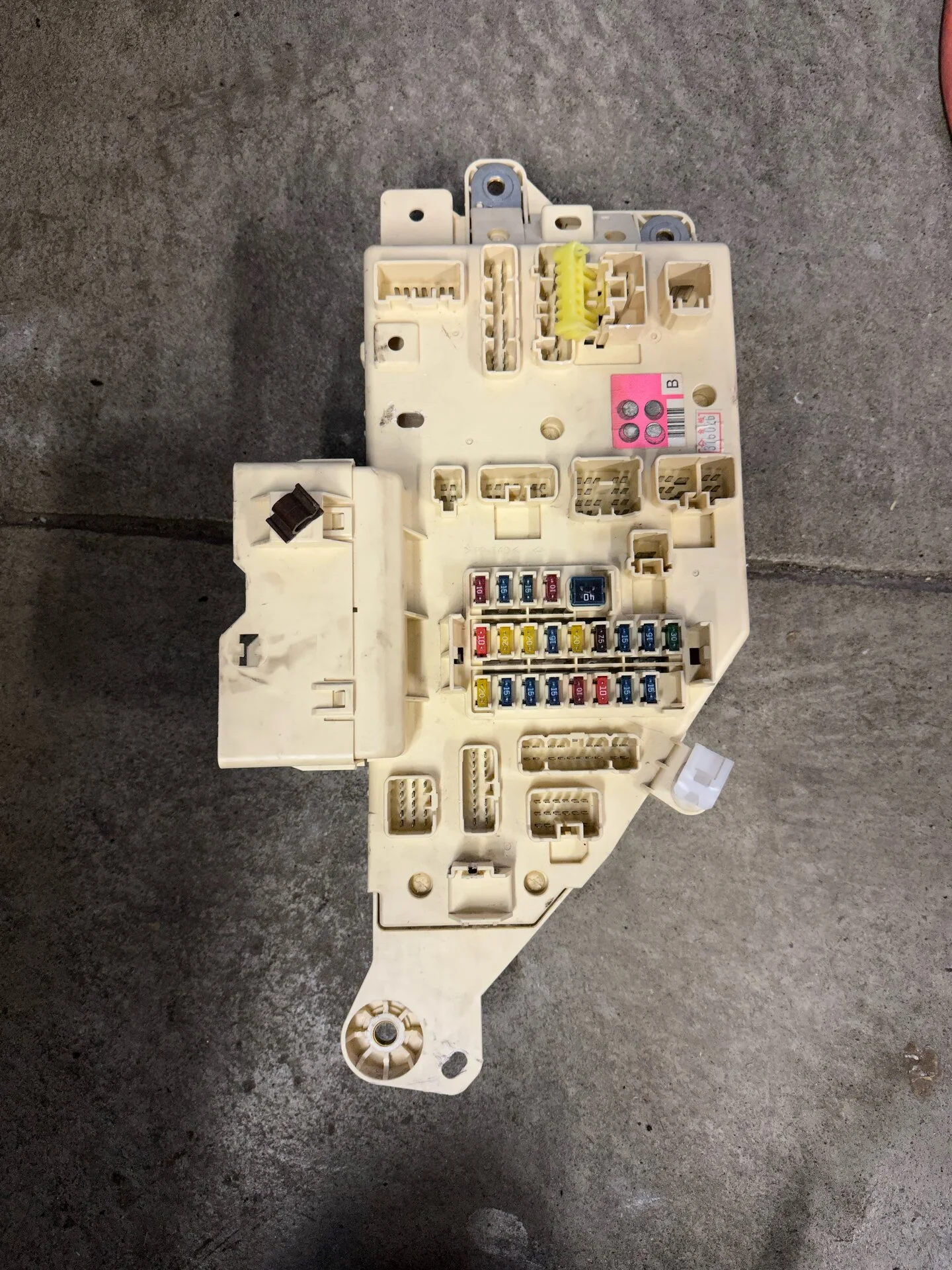

On a LHD 100:
1) Remove drivers' side door sill plate, dead pedal and then the side kick panel.
2) Disconnect all electrical harnesses to the "Cowl Junction Block" (the part shown below)
3) Locate and remove the 3 bolts that fasten the junction block. Positions shown below.
The relays are on the backside and just pull out.

Disconnect negative battery post clamp, before remove junction box.
