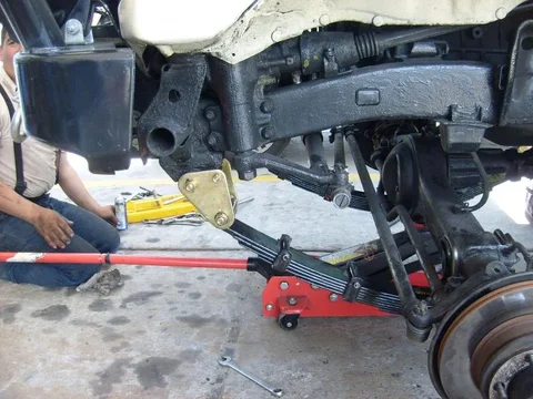

Thank you all for the answers , this is my config right now, dana 60 semi floater open , front axles high pinion 70 series open also and will leave it that way I modified the axle and converted to 80 series coils and radius arms, 1994 toyota fzj80 manual gear box (that thing is huge!) behind a chevy 350 tbi with headers, toyota fj40 chassis and body, I am plannnig to run 38 or 39¨tires , I am do not have a heavy foot but some times is necesary just a bit , terrain is little bit of rocks , mostly mudy hills and couple of hundred miles of pavement to get to the ¨real deal¨.so the question is Do you think I should modify anything with this axles with my tire set up? (I know that overkill is better) .

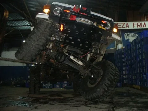

then run 36" tractor tires and REALLY be different...(open small front diff)
like this: (and then you can have fun like this: YouTube - Wayne holing - 3 wheeling a Cruiser)
Woww now that is different! jajajajaja but I assume that hey will be a bit loud on the street :) nice pictures chushers! if they run open diff and they look very heavy foot ( I am not that Heavy foot) I think it will be fine with 38¨ or 39 ¨on open diffs , are there upgrades just to be safe for this axle , right now is what I have and has to work for me , any junk toyota axles arround here stock are about 1000 Us each , not to cheap being a Toyota country ,

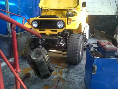

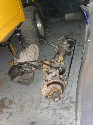

Photo of the axle and trany
The truck before I took it apart.(I bought it like this and it was a big mistake P.O build it with sh....t and everything was wrong example a bit of rust coming out of the motor!! :mad: )

Has Both Venezuelas 70 Seires axles.
