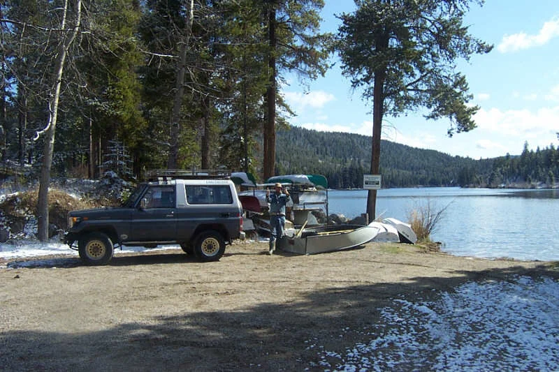

Here is a pic of Gold Boys rack:
attachment.php
It attaches to the front gutters and the rear ones.
Anyone know how strong something like this would be?
How much weight could it hold?
I could try and fab something like this up?
Or would the what I have be good enough?
I don't want to cause perminant damage.

I wonder if I could get away with a system like this for 6 months:
I looks like its connected to the metal and not the FRP.
Connected to the front metal cutters and metal rear gutters.
What do you think?

I believe the gutters are connected to the FRP not any structure below.

I think the FRPs are fiercely strong. I've crawled all around mine wiht no significant creaking or groaning. If you set up a rack with the gutters side and rear doors and tie it all together you'll probably end up with plenty of strength for canoes etc.
My hombrew rack came home one day with about 350lb of timbers loaded on top (with a forklift!). Granted, it wasn't off road at all other than the odd frost heave and all the highway construction potholes, but the gutters, and surprisingly, the rack, held up OK.
But, long term the exo-cage is likely the way to go.
