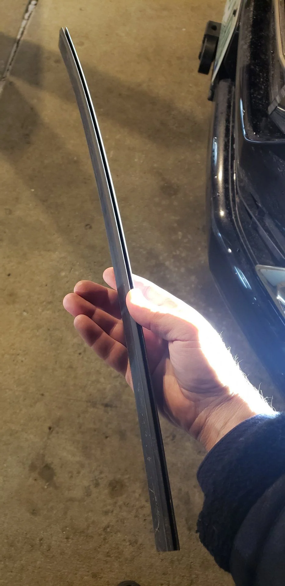

However, I did have one somewhat odd casualty. Several rubber strips in the roof grooves, left in place by the dealer in between the roof rack mounting points, popped out. Here's one of them:
Anyone have a perspective on how important it is to have these in place? Do we need them to protect the roof channels from corrosion, for example? Can I just discard these?

They are primarily there to prevent leaves and pollen collecting then decomposing there. Also having something blocking that welded/sealed body seam from UV is probably a good thing.. even though it is painted I’d bet it is more sensitive to sun damage than regular metal body panels.
The trick to keeping them in place is to make sure the body and strip are squeaky clean before they go in. Any decomposed stuff acts like grease and they seem to fly out.

Mine had one of the middle pieces missing when I got it, but I replaced it and they have all stayed put for another 50k miles. But like I said I made sure the tracks and strips were clean so the rubber would stick as well as possible with friction.
I’d be careful with any serious adhesive onto the paint there. It is over sealant for that welded seam and might not be as resistant to the paint pulling off if it is really grabby.

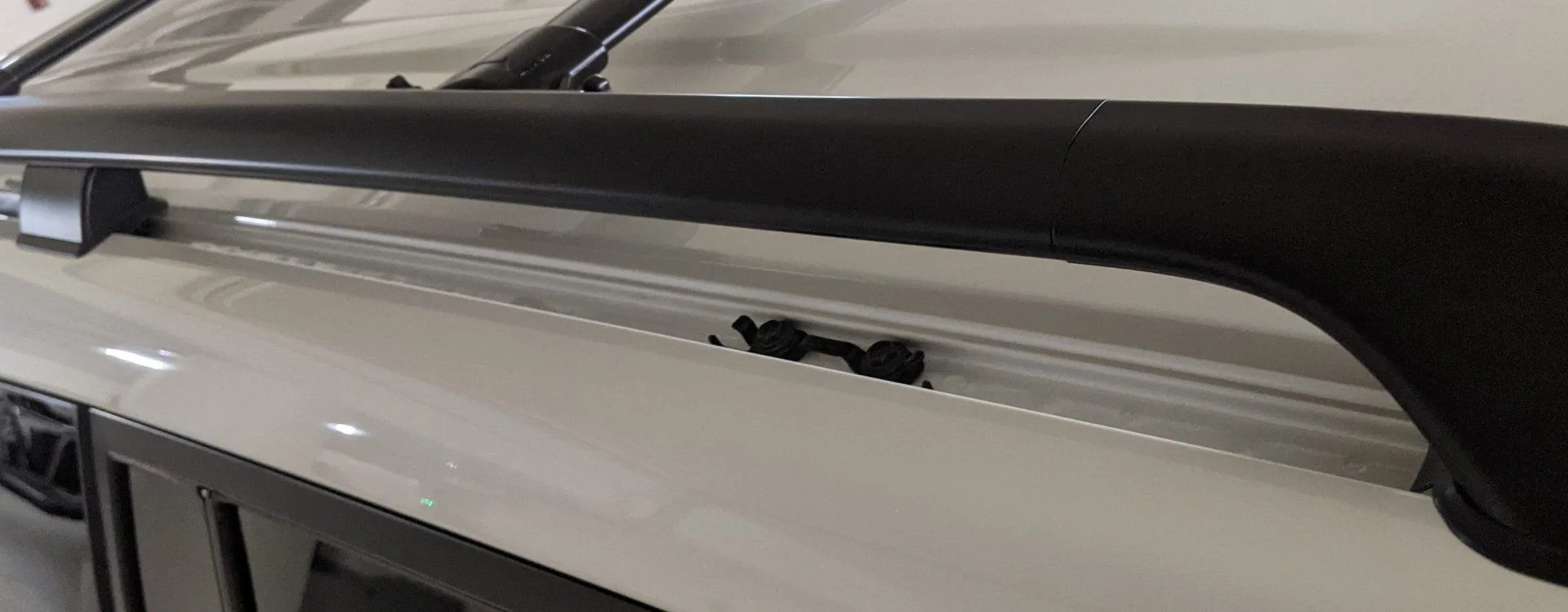

I have less than 5000 miles on my 2021 and parts are already flinging off of my roof. It sounds like a known issue that can be fixed with some RTV so not a bit deal but the dealer say it's not warranty and more worrying the clip is unavailable.
Love that you buy an almost $90K MSRP vehicle and they won't replace $50 in parts. It's stuff like this that gives dealerships a bad name.

I am wondering about this clip that they claim is not available.

I am wondering about this clip that they claim is not available.View attachment 2550452
They need to try harder or get someone with more than 3 months experience to do the lookup. Every part on your rig is available from toyota. Even some that didn’t come on it, like the strut spacer!
This should be 75596-35030
