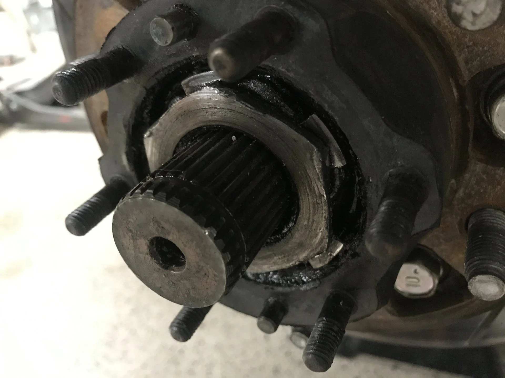

Funny question but has anyone measured their hub temperature with an infrared thermometer?
I’ve recently re-torqued my front wheel bearings to around 25ftlb, and measured the temperature. My rear hubs, which i never touched, were 90*, the wheel was 80* and the rotor was around 126*.
My front hubs were at 102* with the wheel being 85 and the rotors around 126*.
This was a 30minute drive in the sun, at 75*.
