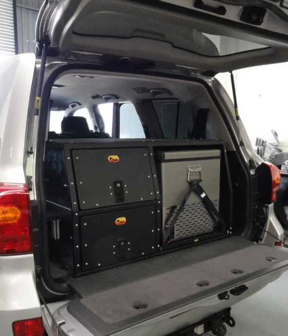

Alu-Cab makes a good tilting one. Here's mine with a large fridge/freezer. Perfect clearance from the top hatch and allows full opening of doors.
How are you liking those drawers? You still like the fridge access this way? I'm considering this exact same setup. Is there an easy way add more drawers on the left side?

Maybe something similar to this could work unless you need three drawers. In which case, a standalone mounted to the typical side-by-side would work.
If you have a fridge mounted on top of a drawer, the tilt is a must. It works perfect in my 80, but if it didn't tilt, I would need a step stool each time I wanted something out of it. Something like below, you may be able to get by without any tilt (and may not really have an option to tilt with a tailgate).

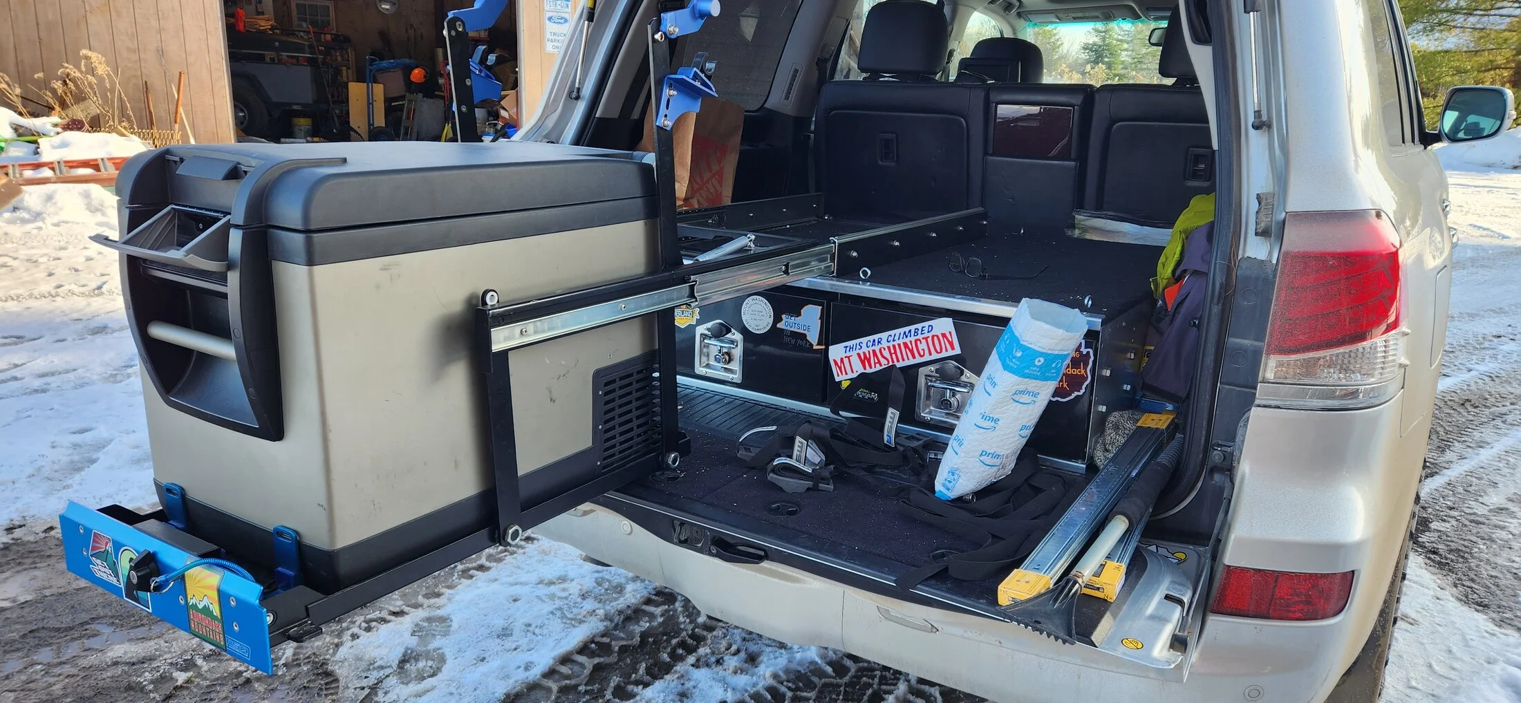

I have spent hours searching different drawer system photos regarding fridges or coolers. 90% of these photos are just glamor shots of the fridge sitting inside the rig all tucked away on the drawer system. I just picked up a used ARB drawer system in the classifieds (thanks!) with the drawer slide, but its so high I don't know how accessible it would be if I bought a fridge. I see there's now a mini-revolution of slide/tilt brackets to angle the fridge down a little, as my setup already has a slide I am wondering how (at least for the last 10 years) all of these fridges on the ARB style or Dobinson style drawer systems were accessed.
I guess my main question is: how much room do you have when your fridge is opened to access your cooled goods? does it hit the hatch or body? does using a strait slide improve access for something like the 50qt ARB fridge? Anyone with photos of an opened fridge that they can share to show how much access they have?

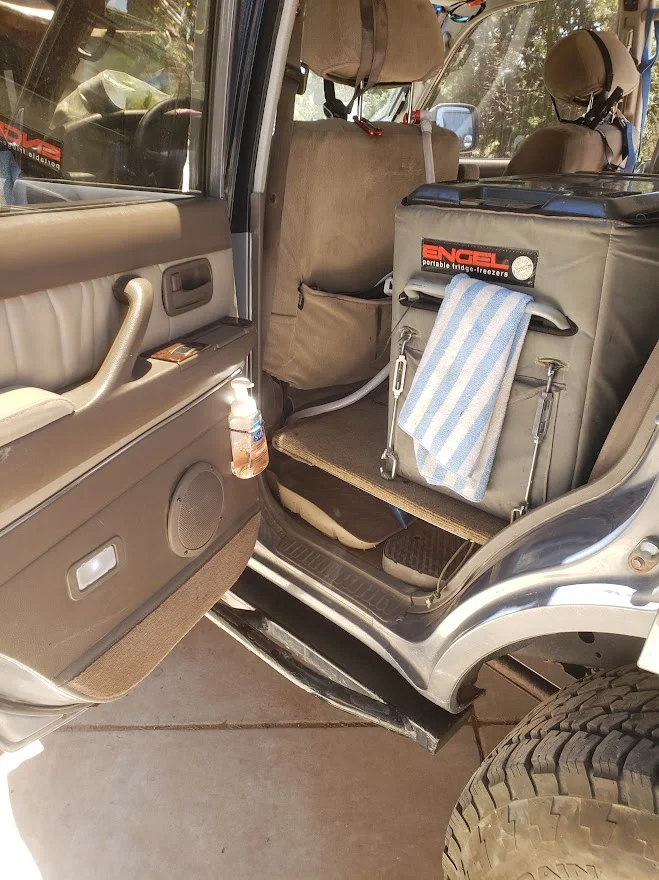

The pic below is from my 4runner cargo buildout process, and i got lucky when I found out i can use the rear hatch to hold the lid open :bounce:
The second pic is from the 80 where the fridge lives in the second row and uses no slides. When I was dating a 5'5" lady, she needed the step stool to grab/see inside the fridge. When I was dating a 5'8" lady, she had no issues but now I might be dating a 5'3" so guess I'll find out on our first camping trip :hmm:

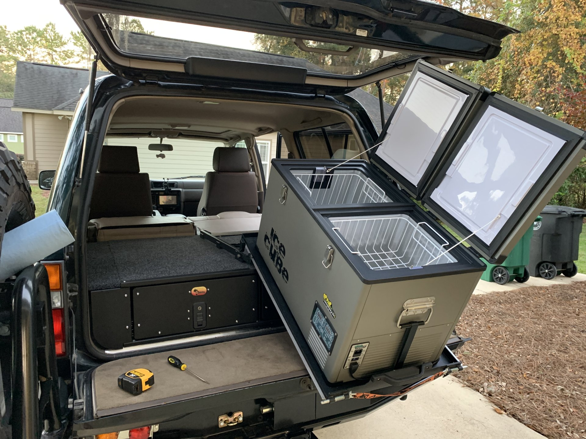

I got this setup, rests on the tailgait and my fridge opens about 95%, hits the glass at the top but the glass holds it open so it's works well enough. I could probably get longer slides and play with the geometry a bit to get it out further, but good enough for now. My National Luna fridge is very deep, other fridges would clear no problem.

I have drawers and looked at slides and found them to be too bulky. Also the fridge is too high and compressors run better when level. My solution was to take the passenger side seat out in my 200. My NL50 fits in there perfectly. The power pack for it sits in the foot well. Access is easy.
After some real world testing, I hate this set up. The angle makes the compressor kick on, which can't be great for it, the lid hitting the glass and not opening all the way is a problem, and I have to pull out an additional basket when I pull out the one inside of it bc the outer one slides into that spot. I'll be ditching this part of my drawers kit for a fridge drop down system.
