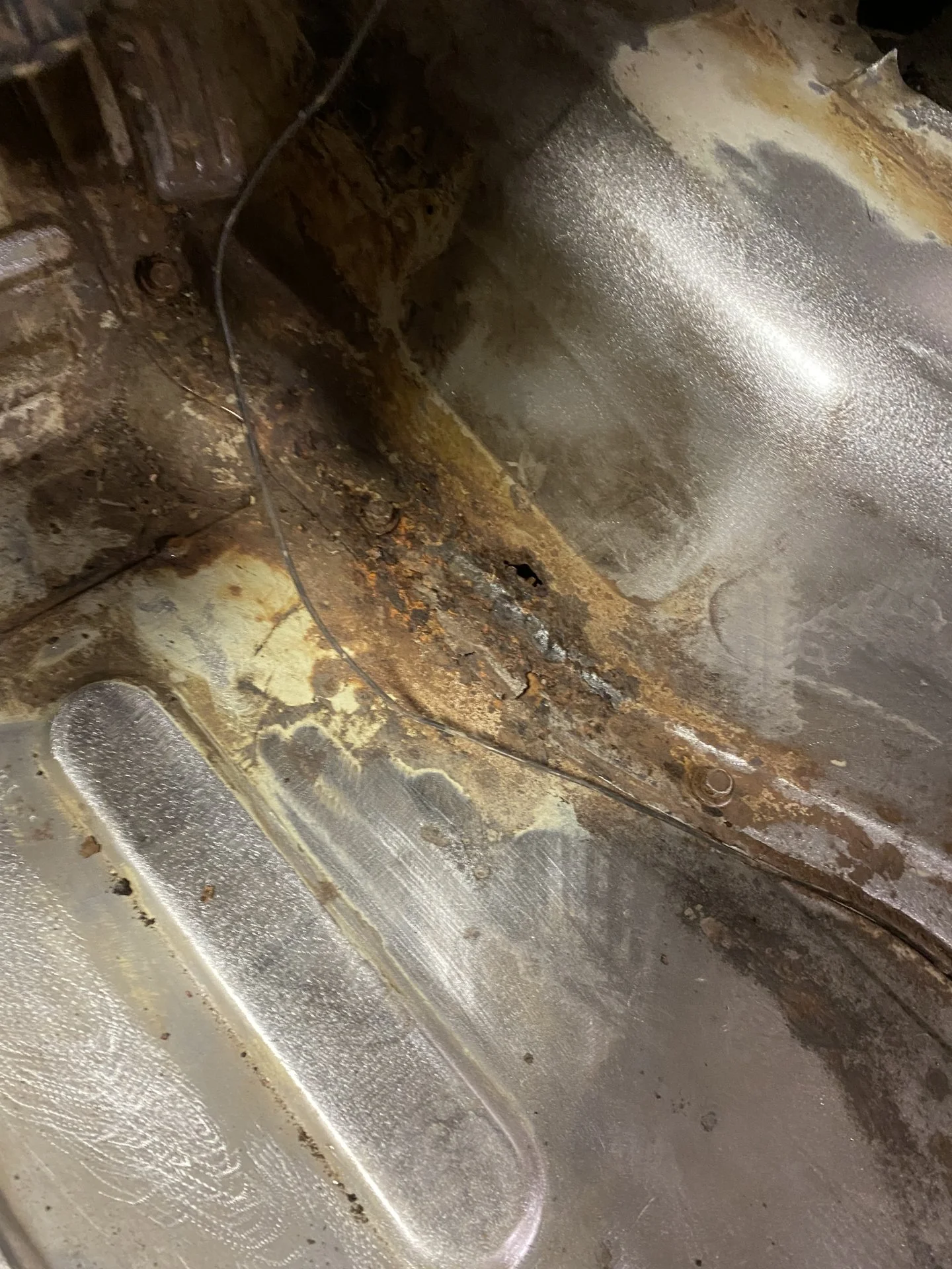

I'm just grinding on the inside removing rust still.........
Anyways, I just noticed this rusted out spot. How easy would this be to fix for a complete newbie to metalwork.

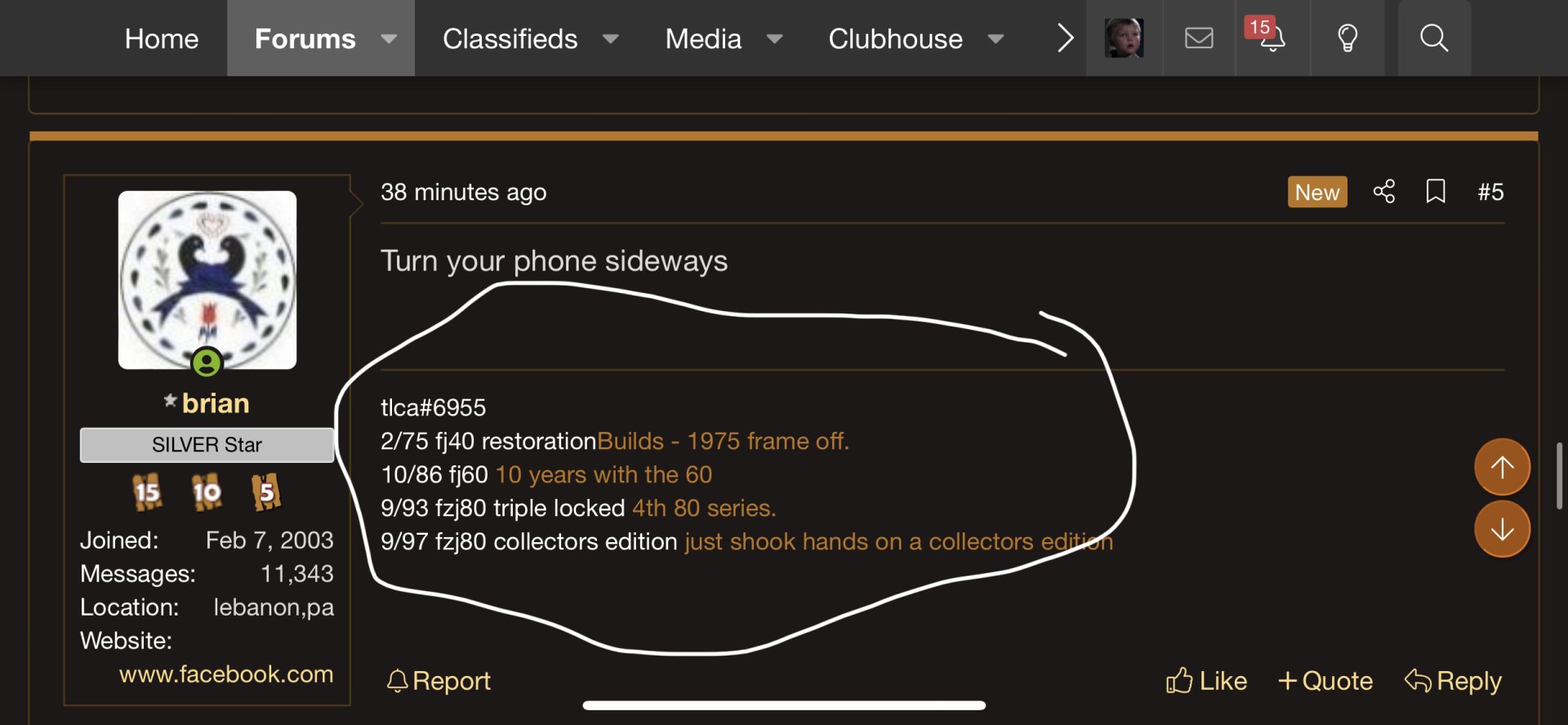

A lot of people create a signature line and put their rig info in it. It’s easier than remembering every time you post a question.😉
It would help you get an answer regarding a replacement to know what year you are working with.
What do you mean by a signature line?
If you decide to repair it, I would remove it so you can clean and prep both sides with it out of the vehicle. With it removed you can also clean up the floorboard under the flange as it is most likely rusting under there. Cleaning the cover's bad spots down to bare metal will allow it to bond well to fiberglass or basic body filler.
It doesn't look too bad at all. You should be able to bend up some patch panels that fit right up. I personally wouldn't spend the time, or the money to find another hump to harvest from. If you do go that route, just find a hunp that is in good condition.

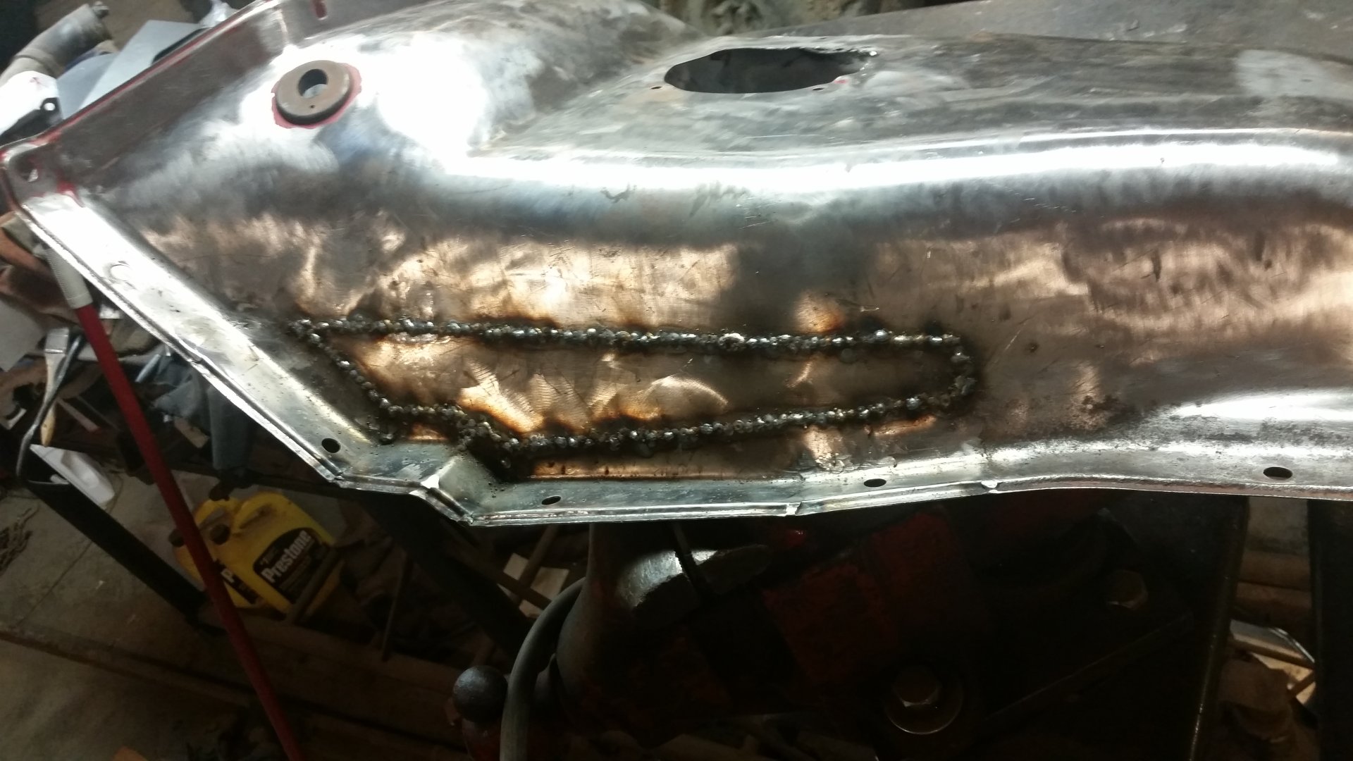

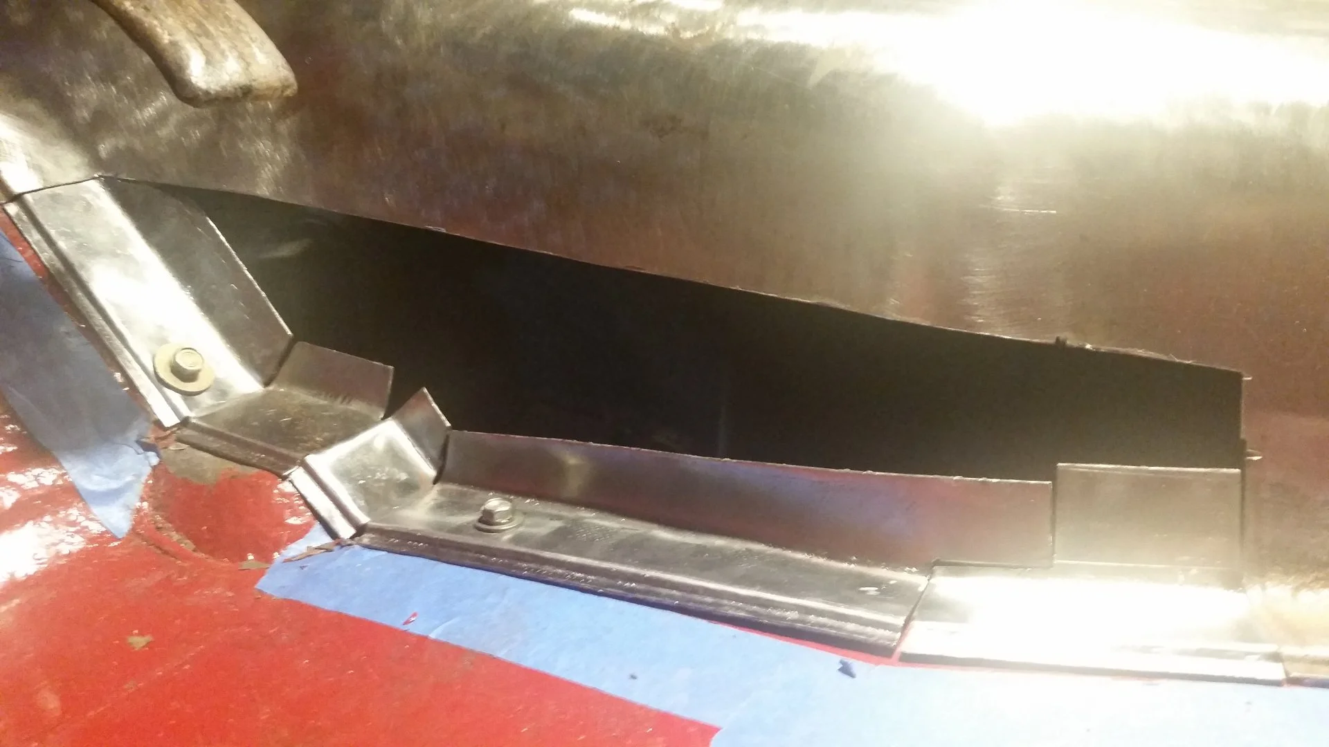

As other have said, you should remove the hump so you can remove all the paint, then repair the humps flange. Try to remove the bolts without breaking them. You can use a wire brush, heat and PB Blast the threaded ends of the bolts from underneath the floor. Then work the bolts back and forth to try to remove them. Its easier to remove them than drilling them out. I think I had 1 break, so I threaded it out from the bottom with vise grips. Then I ran a tap thru the threads. I patched my pass side hump flange with part of another hump I had. The drivers side I had to bend up and make a new flange area then scab in a sheet metal piece to fill in the larger hole.
How did you get the bend on the edge of the metal to look like the original?

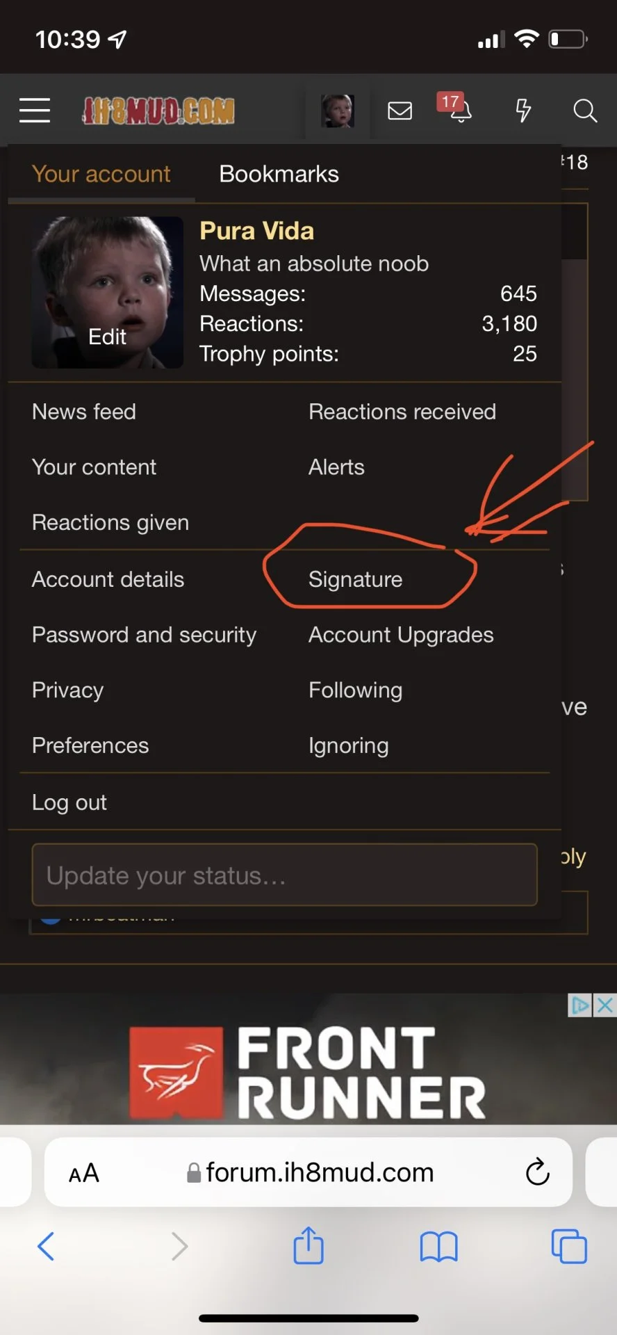

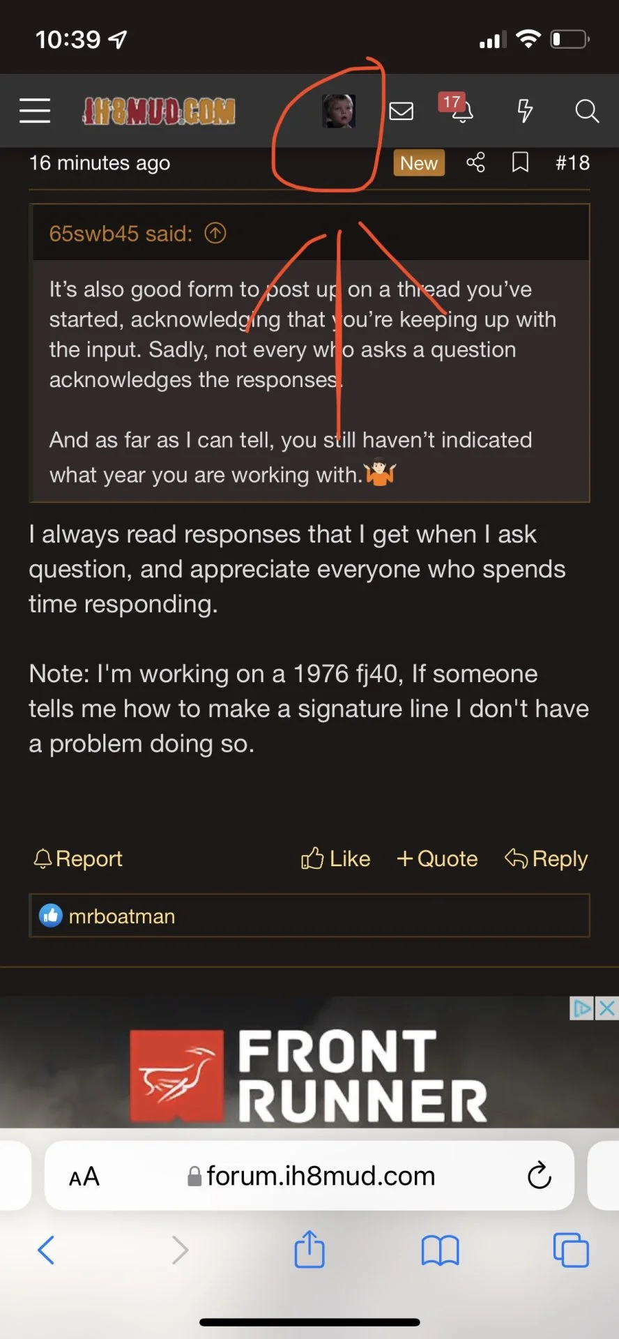

Note: I'm working on a 1976 fj40, If someone tells me how to make a signature line I don't have a problem doing so.
