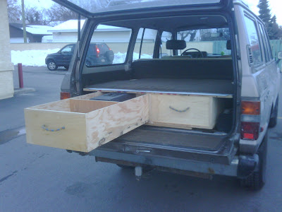

My storage drawers are very similar to Kevin's.
The entire box is off the floor by an inch so that I can stash the extension I made to bridge the box and the back of the folded seat.
My drawer bottoms are slightly raised so they clear the bolt heads with no problem.
I just ran the bolts through the floor (after making sure I'd miss anything critical).
It works well but I worked from the top down (instead of drilling up) and it was a pita.
Should have stuck with my original idea of fabricating some steel brackets and welding them to the floor.
Crappy Cell Phone Photo.
