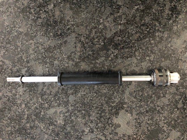

I snapped off a bolt and have another with a rounded head holding my gas tank skid. If they were accessible, I'd just drill and tap them. Unfortunately, I can't reach them with a drill. Do any of you have tips or trick for extending the reach of a drill bit? I imagine an extended length extension with a chuck at the end, but my google searches are coming up empty. There are plenty of extensions for 1/4" hex (I own several), but I don't know how to attach a HSS drill (metal bit) to them.
If you weld/have a buddy who does, I’ve welded bits to round stock - as reatively slow as any drill -RPM is, it’s just fine.
I’ve never done it for die grinder type speeds - they spin too fast.
I know Harbor Freight has ratchet extension sets.
I found a 12" steel extension with a drill bit attached at the end , see attached. Great tool. Can't remember where I bought it though.
All good options, thanks all!
This item pictured above is what I was imagining. Any idea what it is called?
Closing the loop, I used these two things:
It is an extension, and a small chuck with a hex shank. It worked great.
Enkay 584-C Drill Extension Set,... Amazon product ASIN B0009X4VX0
3/8” Drill Chuck with 1/4” Quick... Amazon product ASIN B081M3NR13
They worked well.
Thanks for the help, guidance and recommendations!
I bought some of those long drill bits too, but this setup worked better since I could start with a small bit and work my way up in size until I got to the right size for my tap.
