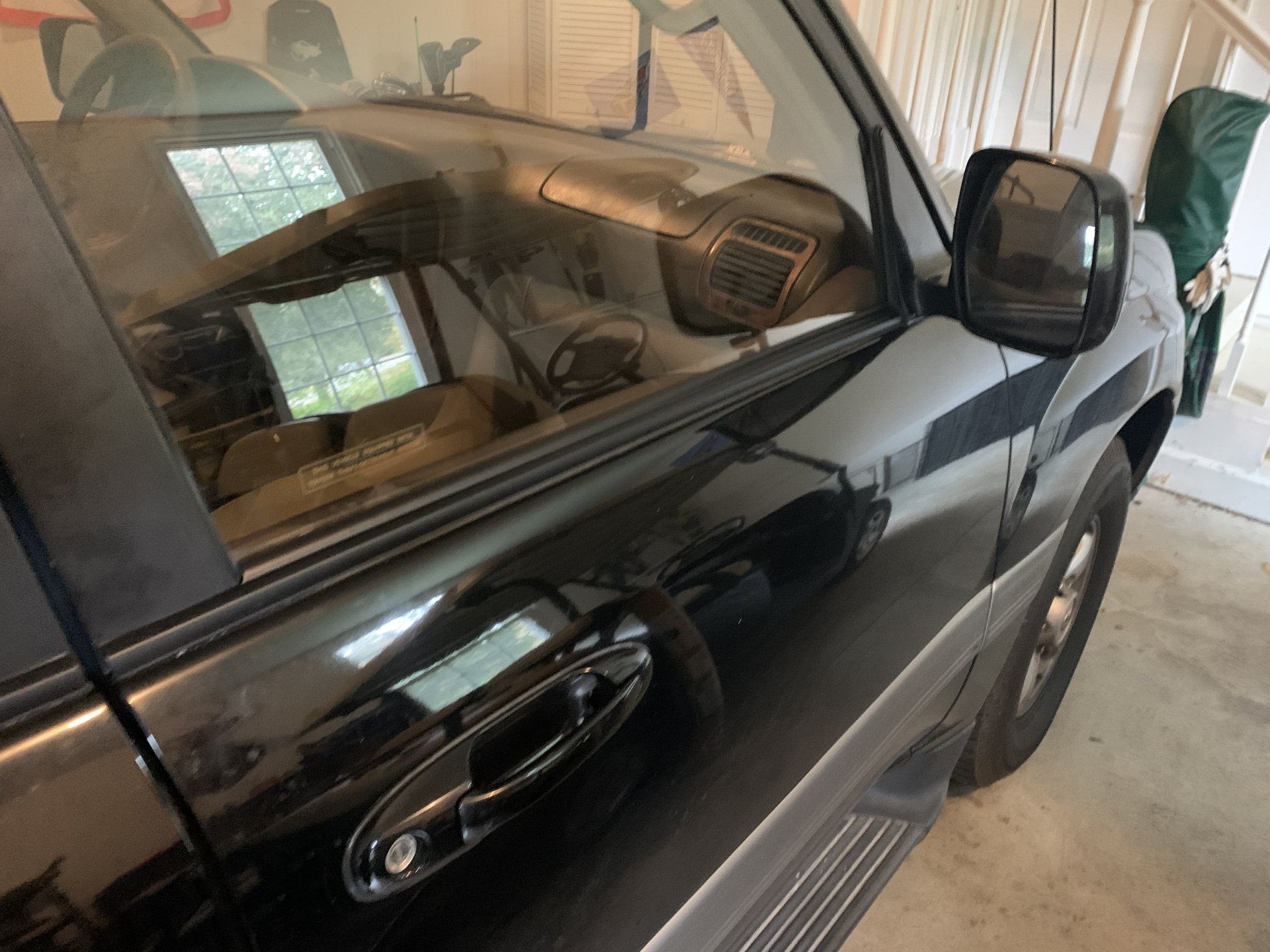

how do I restore window trim?
Cerakote Ceramic Trim Coat Kit - Quickly Restores Plastic Trim.
Works pretty well on that trim. Mine looked similar to yours after a couple wipes of this stuff they look much better.

A couple options:
1. Just buy new. They are not very expensive and we're lucky to have them available.
2. Sand and paint. Use ~200 then 400 grit, followed by a general use black spray paint or VHT Epoxy maybe.
I bought a new one for my driver's door. I plan to buy new for all the others as I apply PPF to the doors. That trim is cheap and the new ones last a decade or more. Painting will be a much less durable solution.
Mr Clean pad and elbow grease also does the job.
For failing/worn plastic on the window belt molding? I didn't think you'd break through that top layer and reveal anything that would last. 🤷
You are certainly entitled to your opinion. My 2000 LC and 2004 Sequoia beg to differ. Lean into it.

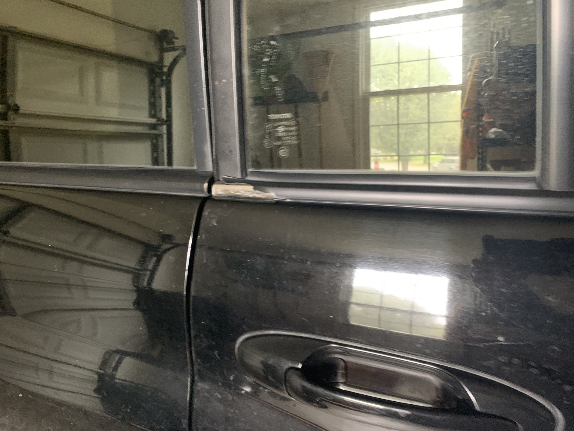

When my belt window moldings was slightly faded and pitted "leaning into it" worked. Once they get as bad as pictured above, even a buffer and cutting compound didn't do it. New pieces on the way.
Back to the window belt moulding for a sec.... as @SL404 noted: the front pieces have a visible screw. The back door pieces don't. Do I just pry straight up to remove these? Or, is there a screw I missed? (that sounded like a bigger missed opportunity than I intended)
Well, that was easy. Thanks again @suprarx7nut!

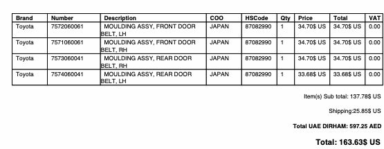

Appreciate this thread! I placed my order last Friday (10/29) and I just received my order today (shipped from Dubai) and have already installed the molding. I did all 4 windows. It didn’t take very long. I ended up being pretty forceful with the old molding and absolutely bent it, but I was going to throw it away anyways so 🤷‍♂️
The new molding looks perfect.

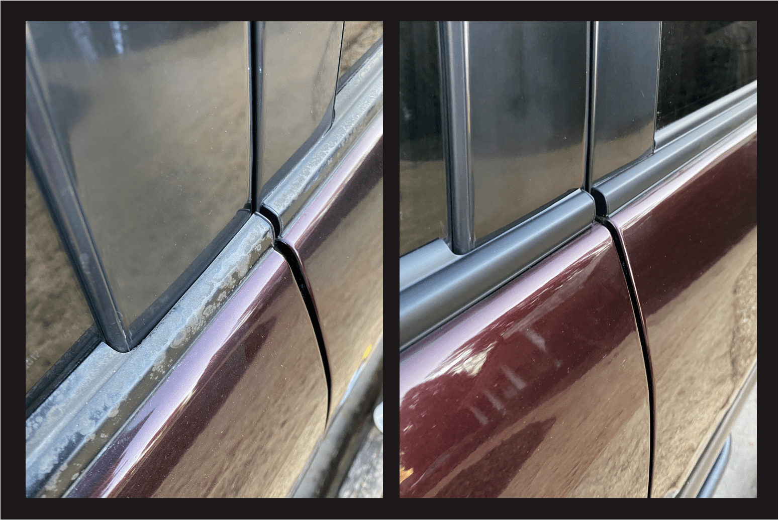

After -
Before-
Thanks guys!

Anyways, pricing has gone up quite a bit on these and impex Japan only has three of the four belts.
