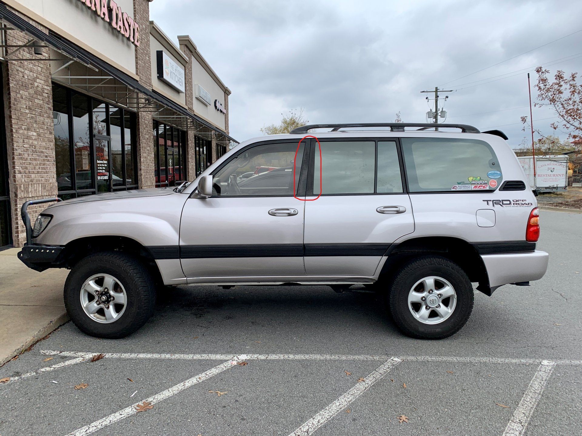

Getting back on topic -- has anyone ever touched up these (metal?) pieces that trim out the windows? I only circled the vertical pieces but it applies to the arching pieces that follow the roof line down to the A pillar as well. You can obviously see the difference in sheen between the drivers and passengers piece, and it gets much worse when you go to the passengers side of the truck where it is starting to look like rust is forming

I can't quite tell what you're asking, but I have redone a few sets of trim in different ways. My go to paint is VHT epoxy black (gloss).

Those panels respond very well to a buffer - start with a mid- to final-level compound; like one step before final polish.
This stuff is absolutely amazing for any oxidation on cars, boats, trim, hell Ive even used on my rear mud flaps on the old 100 series and it restored it completely. If done correctly this stuff lasts for years.
Watch the YouTube videos to get the process down, but your patience will be well rewarded.
