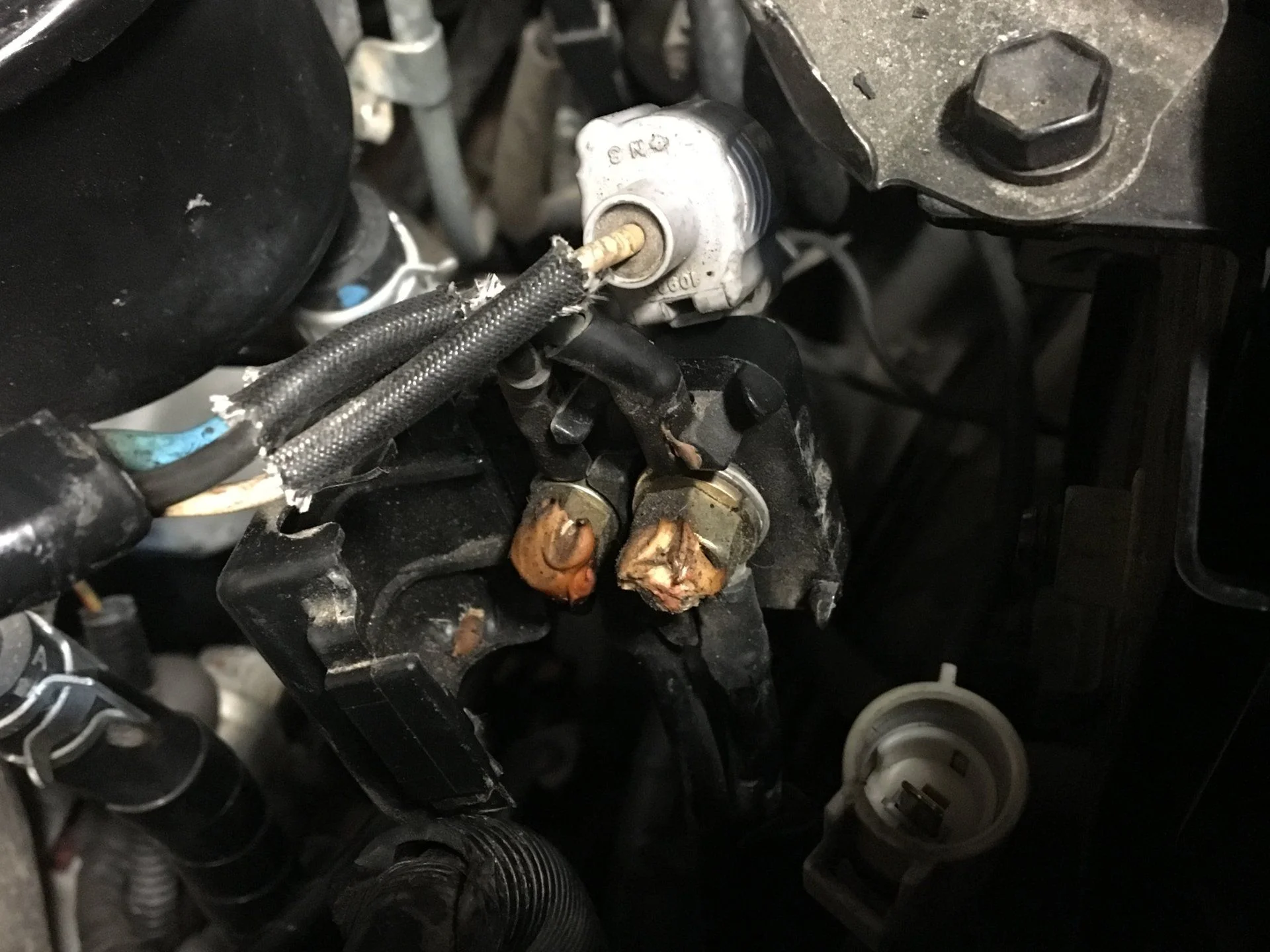

I searched around but didn't find a cut-and-dry tutorial. I'm pretty intimidated when it comes to electrical work so how do I go about replacing them?

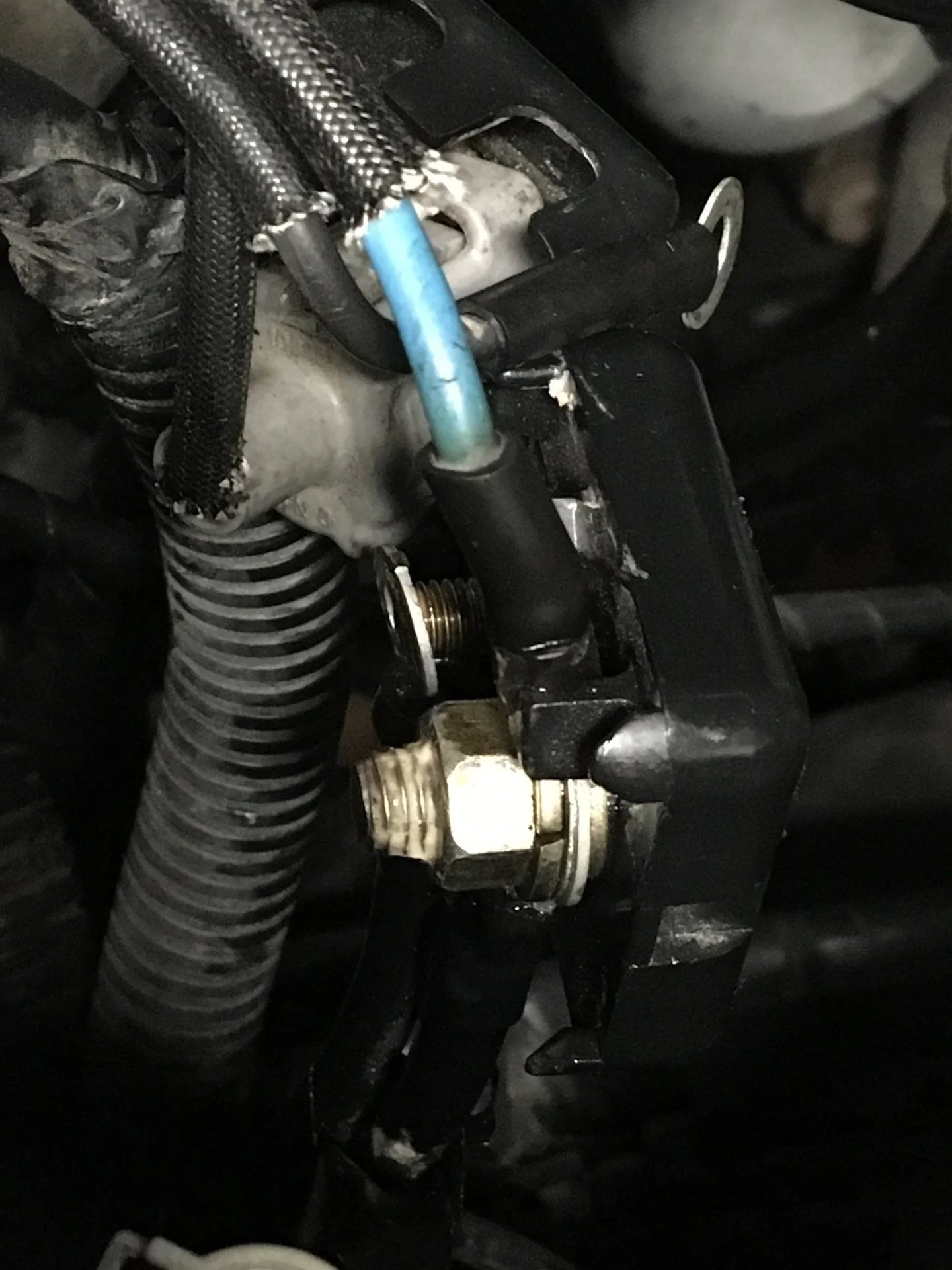

The part is set up with all three wires "keyed" so that it is very difficult to install incorrectly. One wire has a plastic plug (I had to get a small screwdriver to pry the tab for that), and the other two have ring terminals with different size bolt holes. It'll be obvious when you get it apart.
And as someone mentioned.. "zero torque". Not literally.. but it takes VERY little to hold these things together firmly.
I'll argue against the penetrating oil. I wouldn't want any petrochemicals that aren't absolutely necessary getting on the permanent parts of my wiring harness. As long as everything isn't rusted up I just hold the black box firmly with a gloved hand and see how much torque it takes to remove the two nuts first. Only use penetrating oil near/on wiring when you don't have any other options.
Also, these things are cheap. Might as well order another to keep in your spares kit.
Just a clarification, when I say "zero torqueing" I'm not talking about the nut/bolt, I'm talking about the body of the unit. If you fail to stabilize that with an off hand wrench, it will break.
use a longer wench
