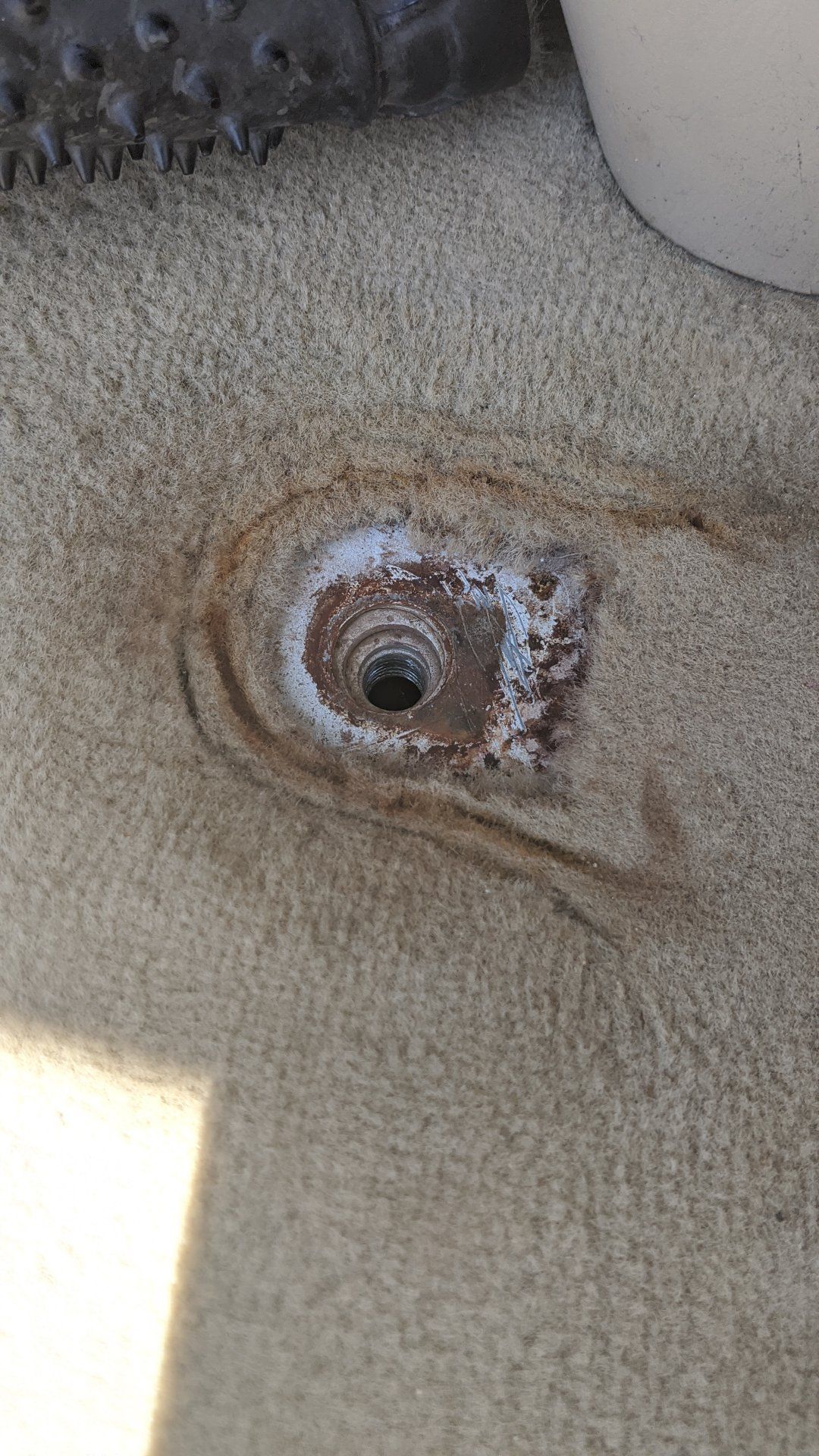

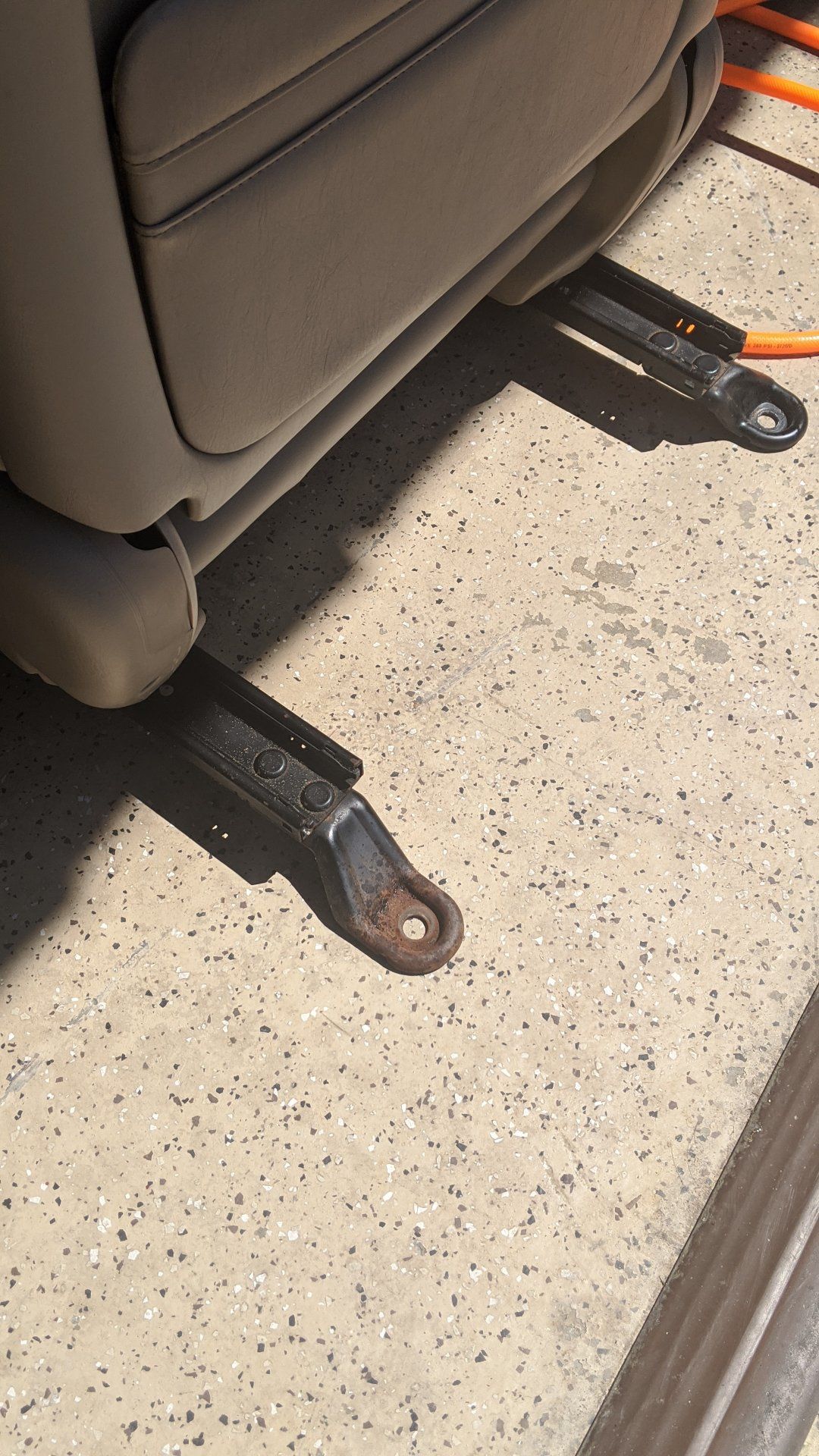

Hey guys I removed my front passenger seat to vacuum and verify the seat is solid. I found one bolt all brown as if some kind of rust? Maybe coffee? Pictures below.
I hand sanded down and cleaned up everything but the bolt and the hole threads are stripped. I searched here and found the bolt size M10x1.25 which I assume is correct. I will be ordering new bolts from Lexus/Toyota.
I don't know how to retap or chase the threads and what to buy and the correct sizes.

Those threads look good to me. Try to torque it down to spec. If it yields before reaching torque spec, then I'd run a helicoil or timesert.
You've got plenty of thread there. I'd oil up a tap (don't try to chase those threads) run it down and then install a new bolt. Bet it will tighten up just fine. Use a tapered tap (not a bottoming tap) as it will be easier to get it 'started'.
Bolt doesn't thread in without force i don't want to jam it in there. Plan is to use the tap linked above to cut/clean the threads so the new bolt goes in smoothly. If this doesn't work ill look into helicoil.

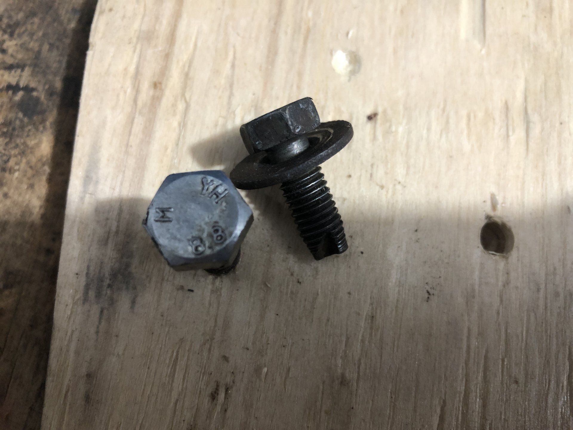

Below are the markings for a Metric Gr 8.8 automotive bolt, on the right a self tapping bolt with bottom threads tapered and sidecut to cleanup existing threads...

'Chasing' a thread is done using a less aggressive Chasing Tap which is designed to 'reform' and clean up existing threads. But in your case I'm not certain the root of your threads are clean and undamaged enough to simply 'chase' them. Hence my recommendation to run a regular tap down it. A thread cutting tap has the ability to 'cut' new threads where necessary while at the same time reforming those that might have been pulled a little. Use a lubricant on the tap and when/if it starts to bind...back it up a little to clear any chips and then proceed.
