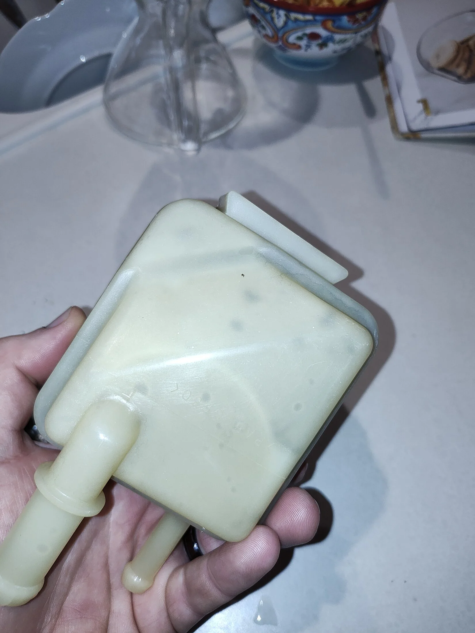

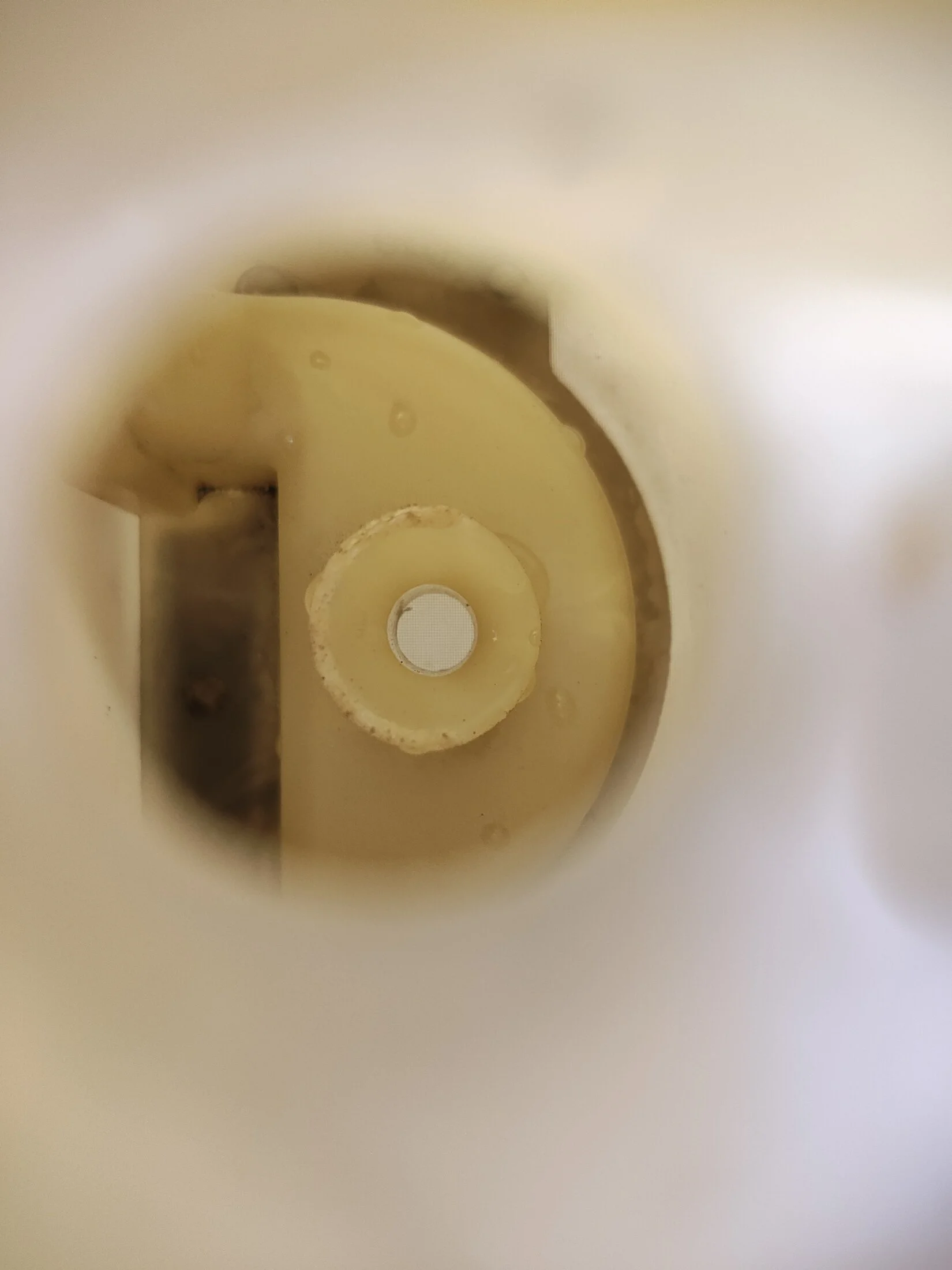

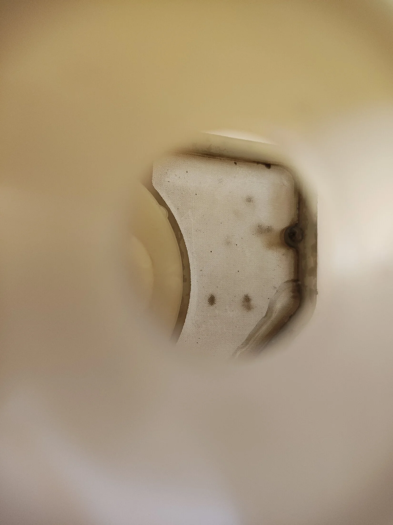

There's no easy way to separate the two halves as far as I can tell. You can't really backflush the majority of screen material since there's two passages for the outlet. Lacquer thinner / acetone don't seem to dislodge the gritties from the screen and compressed air isn't much help in a container designed to reduce turbulence.
I think people aren't actually doing this job very well
I put mine in my parts washer, squirted out what I could and used a bottle brush to reach what I could.
After all that, I agree--I didn't do a great job. It was a bunch cleaner than before, but you can really see the dark spots still.

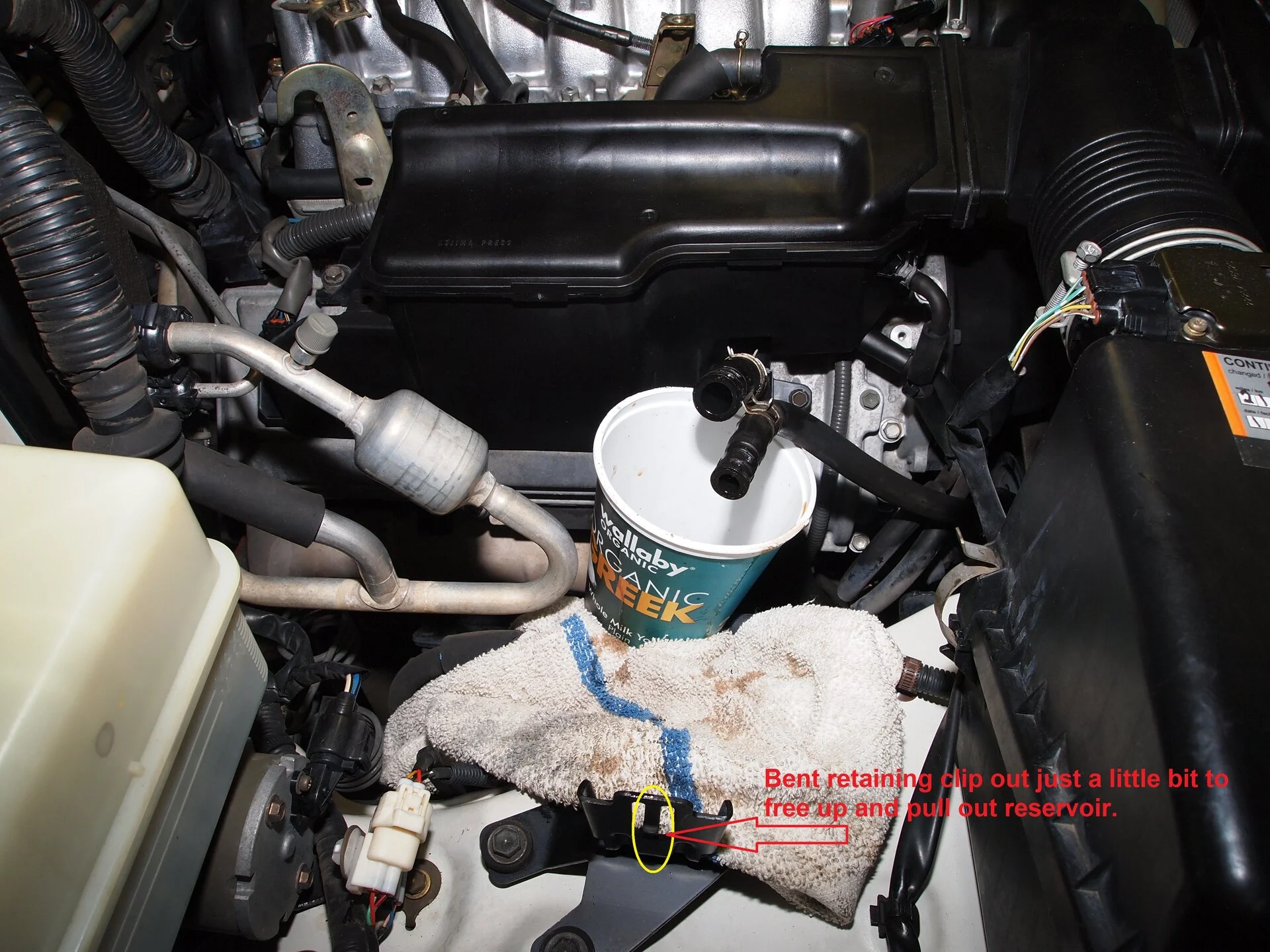

I removed & cleaned the reservoir when replacing my steering rack. Brake cleaner is not so good for plastics. Use a water-based, non-foaming engine degreaser that's says "safe for plastics." Blow out debris with compressed air if you can.

14 minutes in the ultrasonic cleaner, 90% cleaner. Still a few flecks in
screen that I'm gonna try to get out with co.pressed air. Not bad though, and the cleaner cost the same as a new reservoir lol.
