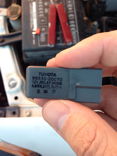

So I got off my butt and figured I'd document the horn relay part number. This is for a year 2000 land cruiser.
Unfortunately for me, I took my relay apart, and it looks super clean. No corrosion and no obvious issues with the soldering. So I'm back to square one, and need to following the lines up the column and figure out what is causing my short that blows the fuse.
