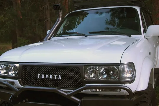

Any of you guys got a part or pic of something you have used, or currently using that works for venting the engine bay thru the top of the hood?
I'd love a louvered panel that has a slide on the inside that I can shut when needed.
If you got 'em, post em up please.

Mine, did couple years ago.I use nissan 280 or 300zx hood scoop.(I just forgot what year the Z, I think its '84 or '89)
damn that's some sexy stuff right there...
yeah, I want that!
