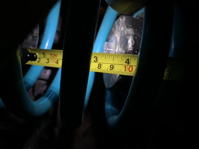

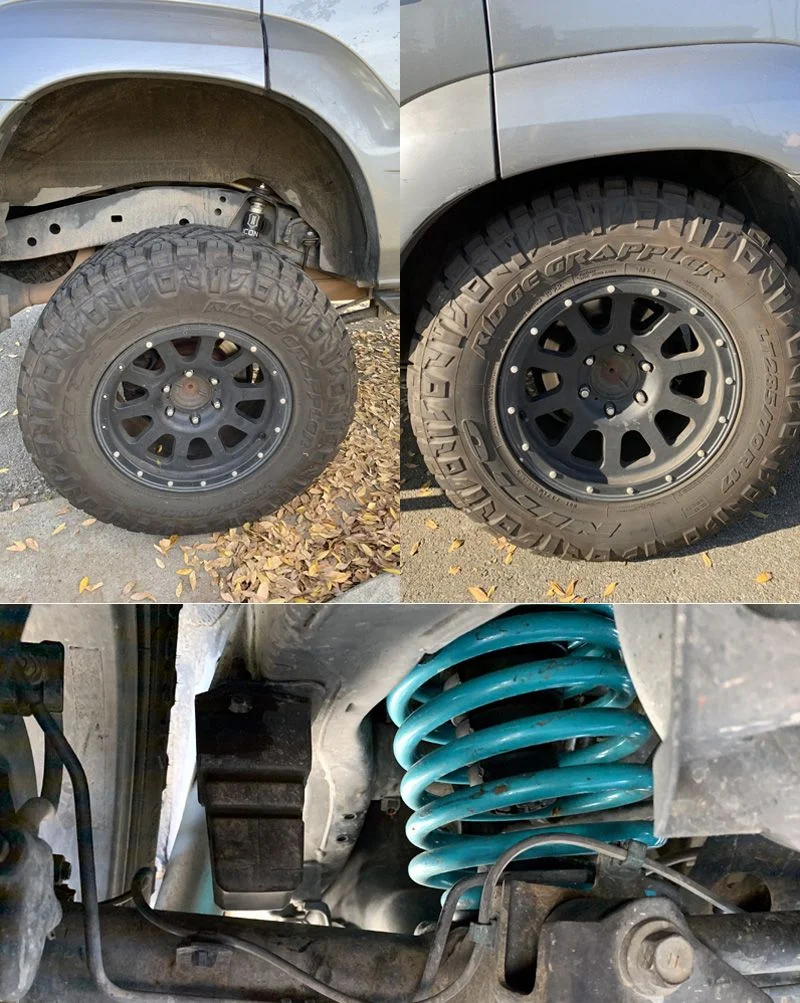

Sidewalk flex...not full articulation, but stock GX470 bumpstops seem to be aligned with axle. Hmmm, I need a taller sidewalk.
Next two photos are while parked on an even surface. Bumpstop to axle distance and inner spring upper isolator to coil puck distance.

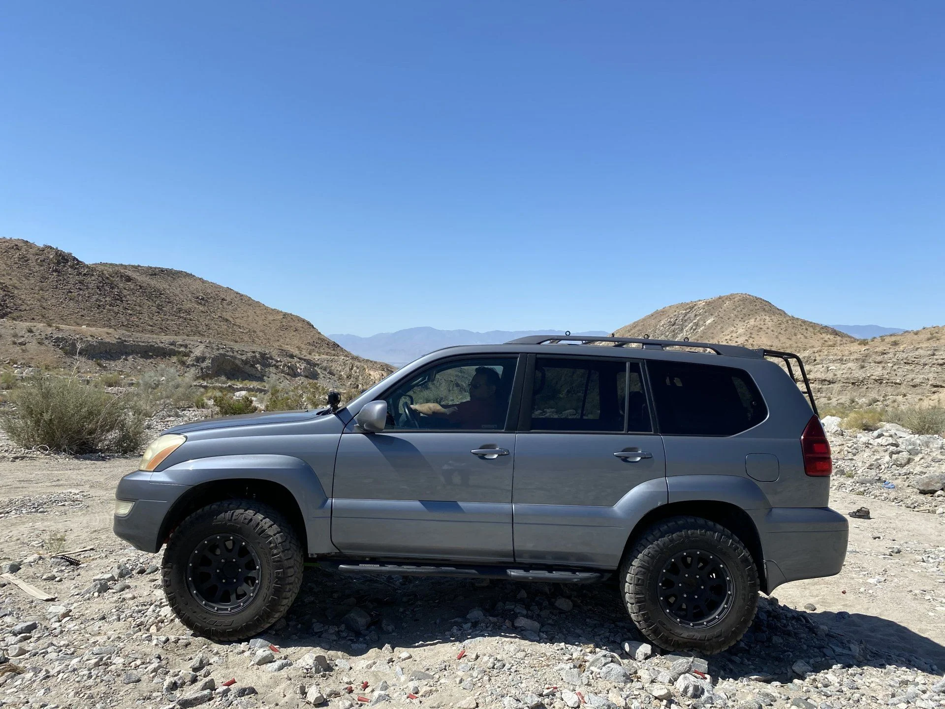

I went on Berdoo Canyon Road up into Joshua Tree National Park. This trail was easy (say a 2 out of 10 in the difficult scale) last year when I did it in January 2019. This time (2/2020) the rains in December/January created a couple of medium difficult areas (say a 5 out of 10). We scraped the skid plates and rock sliders. And there was one section that was like a 7, but it had a bypass area that was like a 4. Pretty crazy that it changed that much.
I felt that my rear long travel suspension (4Runner rear sway bar end links which are 1" longer, Icon MT LT shocks, Dob LT variable rate coils) did really good compared to airbags. I felt that my articulation was really good in the rear and my tires stayed planted in a really rocky section. I didn't spin wheels like I had in the past. I felt my stock GX bump stop on the drivers side (which I lowered about 3/4" using nuts; didn't lower passenger side; just to try it out) hit the axle at least 3 times.
My original GX470 bump stop survived and it's in one piece. Really happy with the articulation gains. I couldn't measure the articulation gains, but just felt good. My son took his 96FZJ80 (only CDL) and I felt like the GX470 kept up with the 80 when it came to staying planted in the rear.

You can measure the interior diameter of your coils (I believe they're 3" but dont quote me). Get a hole saw that size and cut discs out of an old polyurethane cutting board. It will perform just like those aluminum ones.
This post just gave me an idea. I can create 1/2" spacers out of polyurethane board for the stock oem GX470 bump stops. This would be a lot easier than customizing the aluminum blocks I bought to create my own spacers. I might have to go to Harbor Freight to look for some poly boards.
The struts afford 2x lift, vs spacer thickness, the bump stop is at a different point in the geometry. i made bump stop drops from 1/4", steel and that matches the lift afforded from a 0.75" puck. I have material to do 3/8" bump stop spacers, but i think the 1,/4" is actually fine.

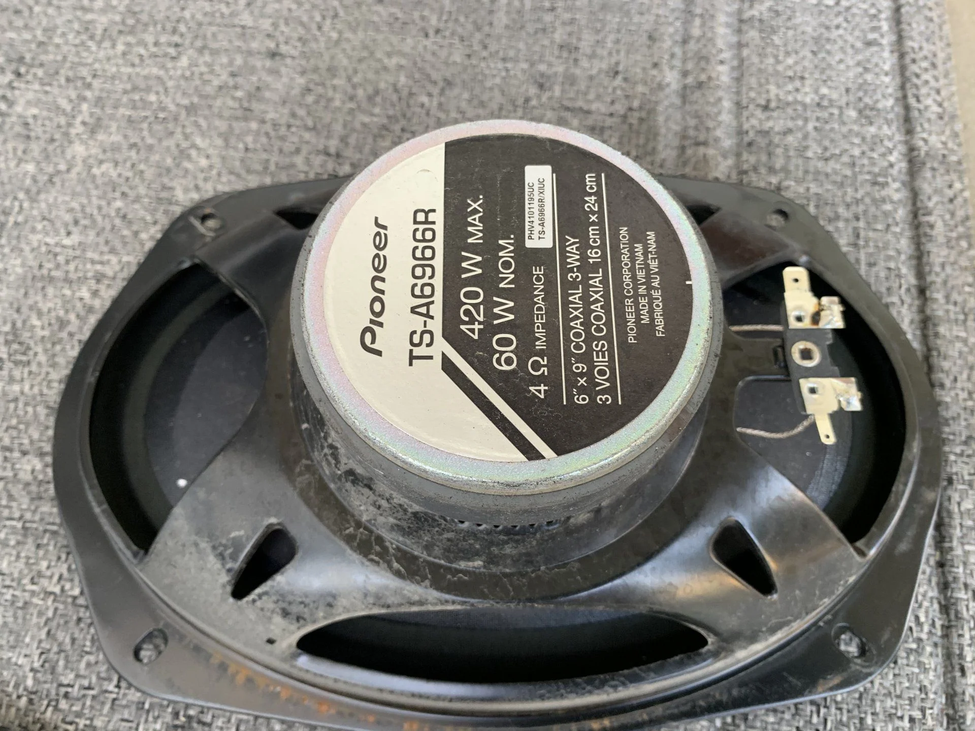

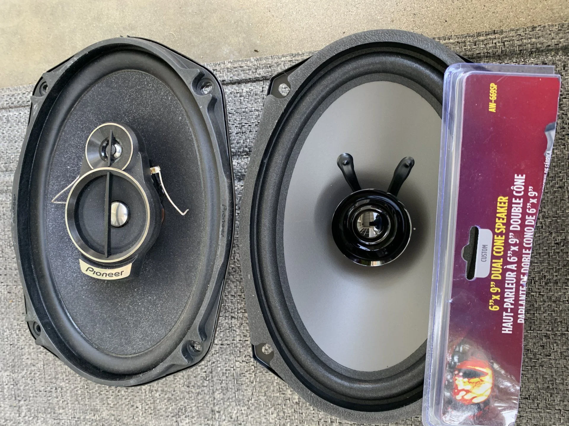

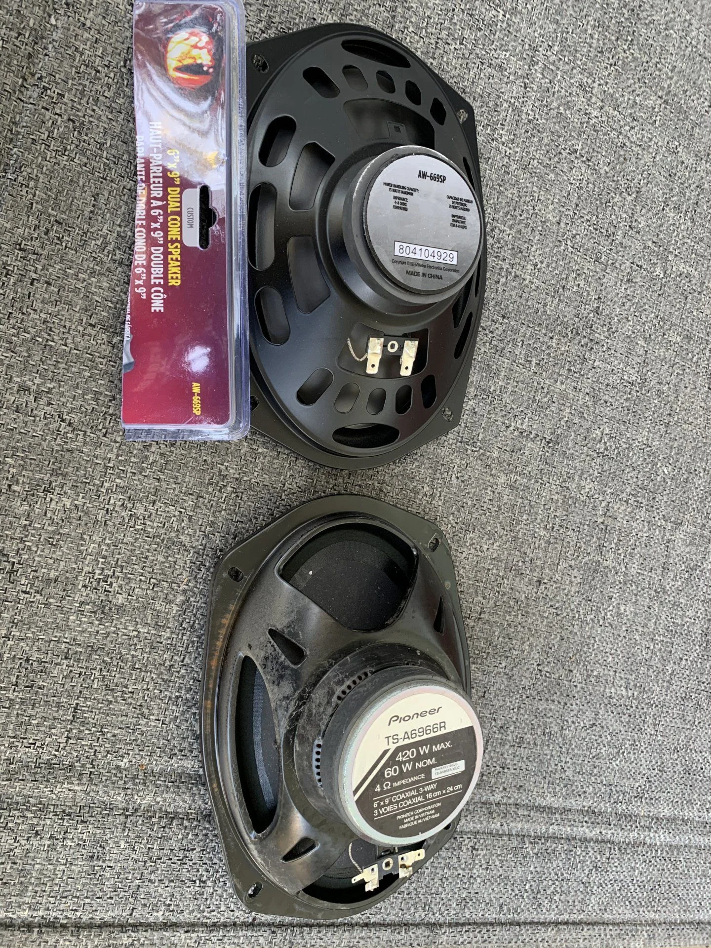

Well...my front door 6x9 Pioneer TS A6926 speakers ($60/pair + $40 install at a car stereo shop) only lasted a little over 3 years. One of the speakers started rattling the sounds pretty good, so I decided to replace them myself. When the 6x9 Pioneers were installed, the shop put in a new 6x9 bracket, so it was very easy to swap out. Just take out the door panels, remove the screws for the old speakers, cut the wires, connect the new wires, and insert the new 6x9 speakers using the previous bracket, holes, and screws.
This time I bought the really cheap Metra Electronics AW669SP front speakers ($16.99 each plus tax). It says it 4 to 8 ohm compatible, so who really knows what that means? But I didn't want to spend a lot and I needed to change them today for a trip tomorrow, so I did a same day pick up at O'Reillys.
I compared them to the Pioneer ones I took out and the Metra are lighter in weight probably due to the small magnet a cheap components. The speakers sound better than the blown one, but that's not saying much. At some point, I'm going to have to figure out what to do with the rest of the speakers. The rear subwoofer sounds shot (even though I tried to do the foam repair a couple years ago).
For comparison, here's a picture of the Pioneer next to the Metra.

4-8 ohm depends on what they're being hooked up to. most aftermarket car speakers are 4ohm. unless you get into subs, high end, or specialty replacements then you can see 1-8 ohm. I don't know about the ML system, but when I used to sell/install car stereo 20 years ago, the factory amped systems were usually 8ohm (home speakers are often 8ohm too).
in the end, it won't mean much to you unless you have miss-matched speakers, as the 4-ohm speakers will be louder (twice the power coming from your amp).
more information than you're probably interested in
Apr 23, 2008
1,769
So Cal
Good info on impedance. At the end of the day, these are cheap speakers and I just hope they hold up for a year or two

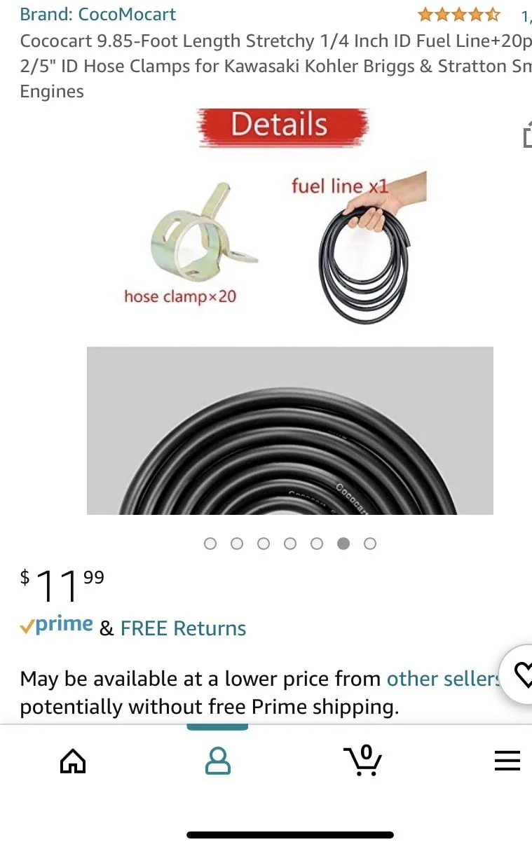

The Dorman axle vent item is a little too big for the 1/4" ID hose. I'm going to look for a smaller vent cap that's 1/4" (0.25") or I'll force the Dorman 0.3" axle vent into the 0.25" fuel hose. I'll need some heat and some lubricant (soapy water). LOL.
