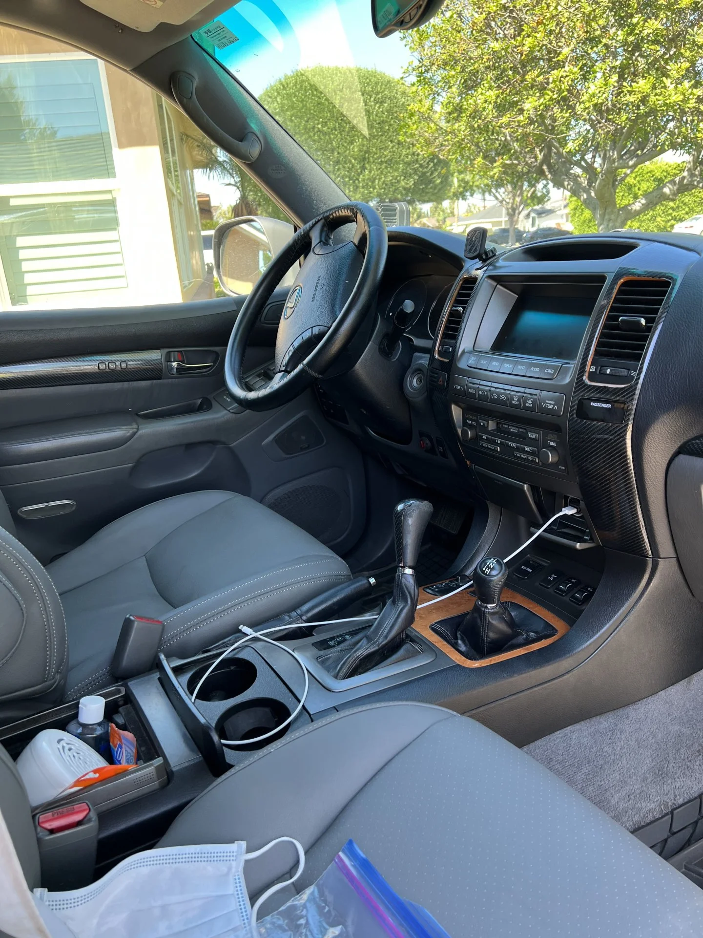

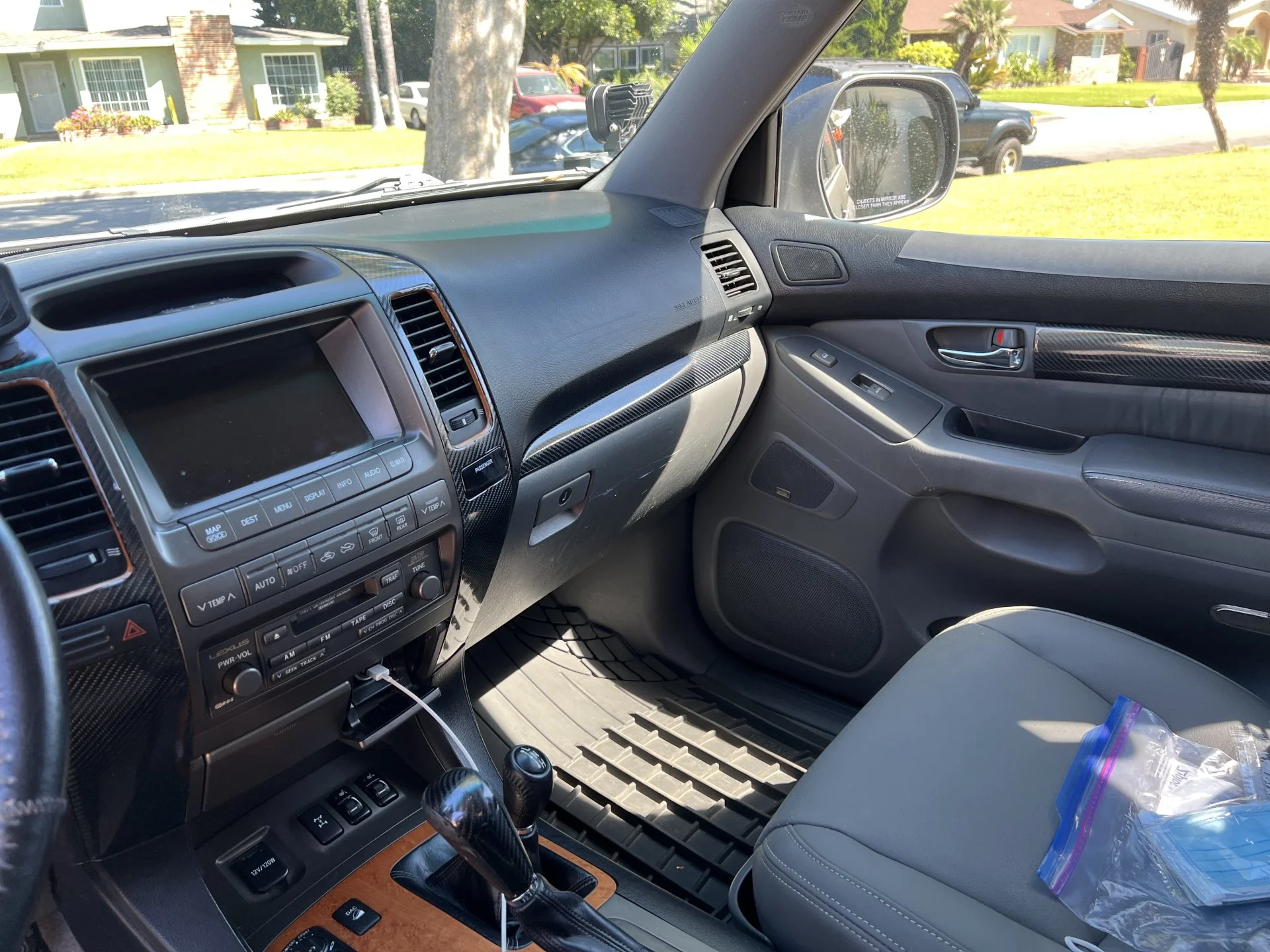

Just one area left to finish wrapping all the simulated wood panels. These front ones were a little harder to do and it’s not perfect, but good enough.
Dashboard was replaced under the replacement program in 2017, front seats got new leather from LSeats.com, and steering wheel got a DIY black leather wrap.

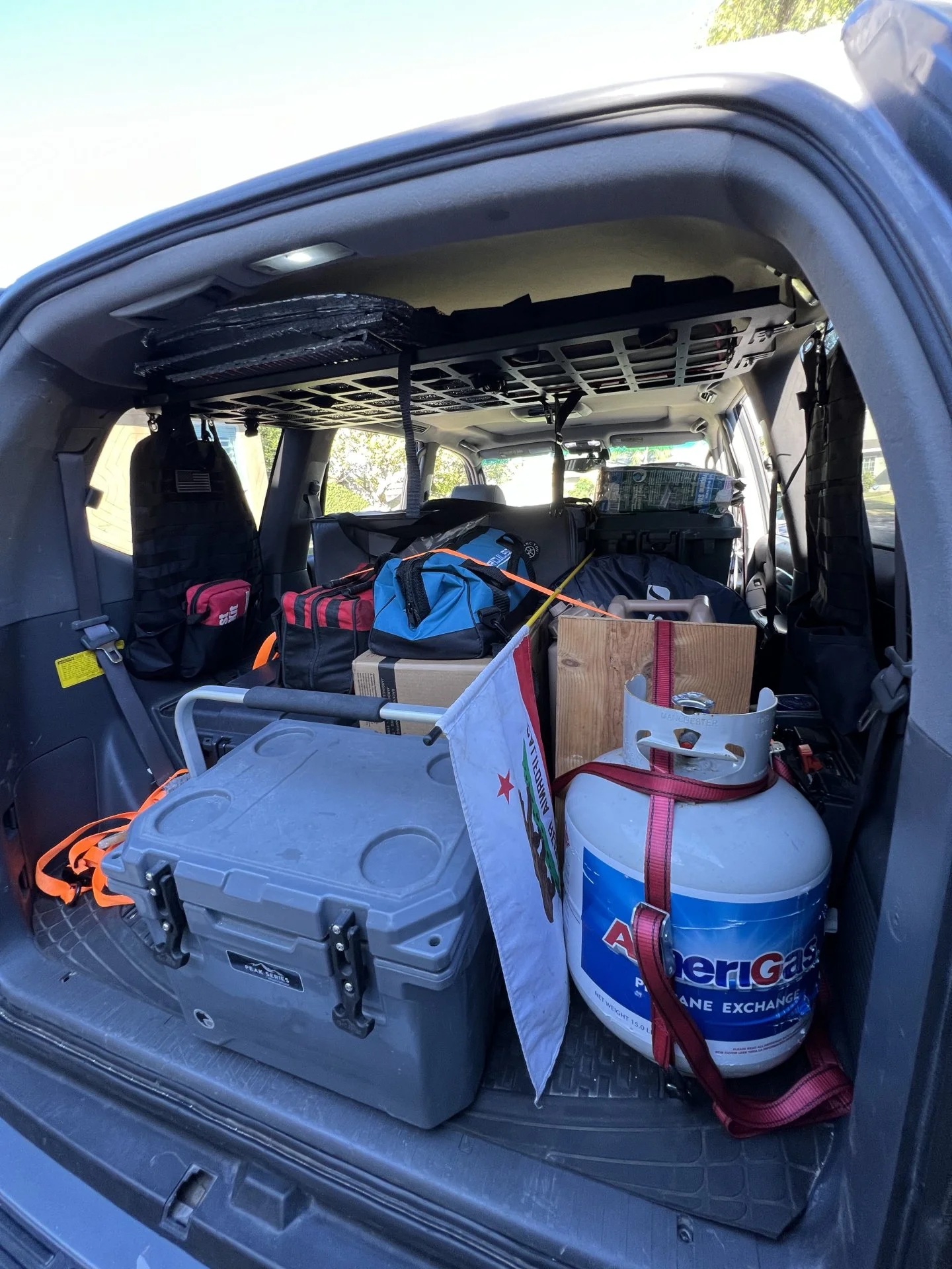

Packing for a weekend camping trip…

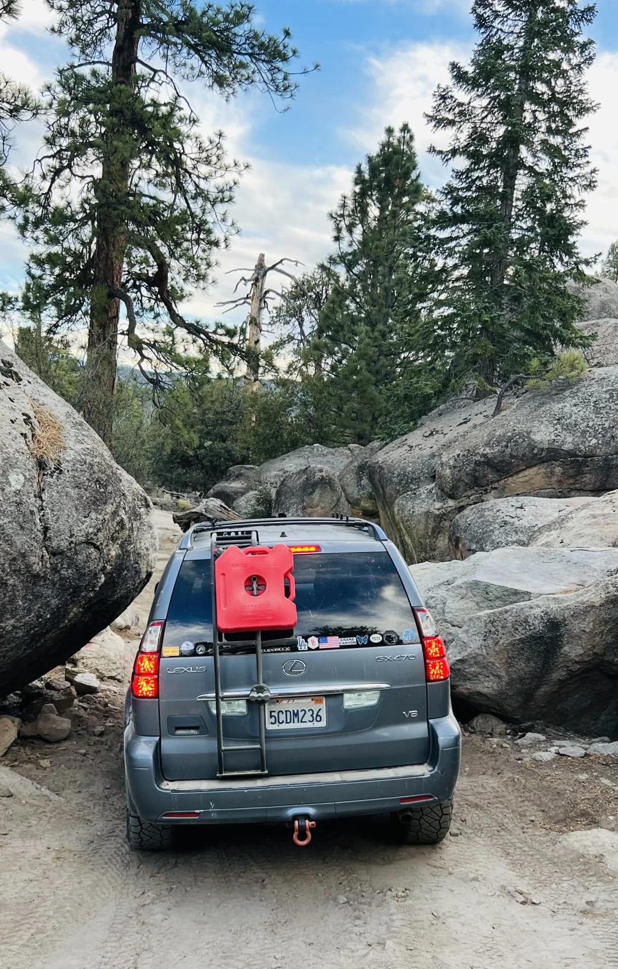

Went to Big Bear and did the Little John Bull Trail.
It rained there 3 days ago and big puddles of water 3/4 up the tires.

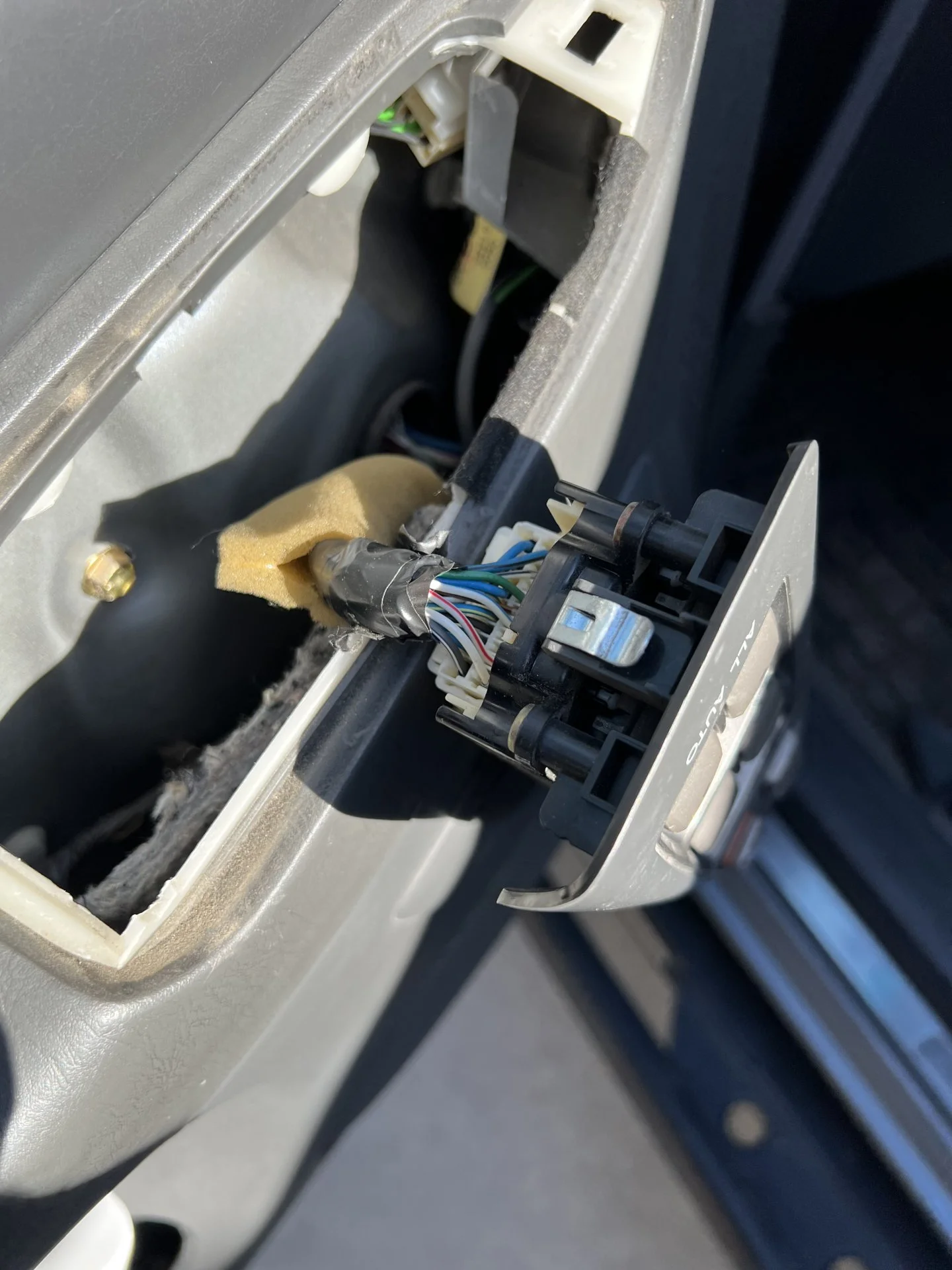

Now all 4 of my windows won’t close (I ran over water while all 4 were down and then had to drive thru 108 degree weather in San Bernardino to get home) and all my door locks don’t work! Arghhh not sure what got wet.
Any ideas on how to troubleshoot?
20amp Fuses look good in engine bay and under dashboard in drivers side.
Windows don’t work from any window button. All do nothing.
Automatic Door lock doesn’t work from drivers side button but works from passenger side button.

Window issue fixed. I guess the last time I disconnected the white connector from the master window switch to take off the door panel I didn’t click the connector back all the way in and Little John Bull trail disconnected it for me.
I connected it at home the next day and all is well. Windows go up and down all around.

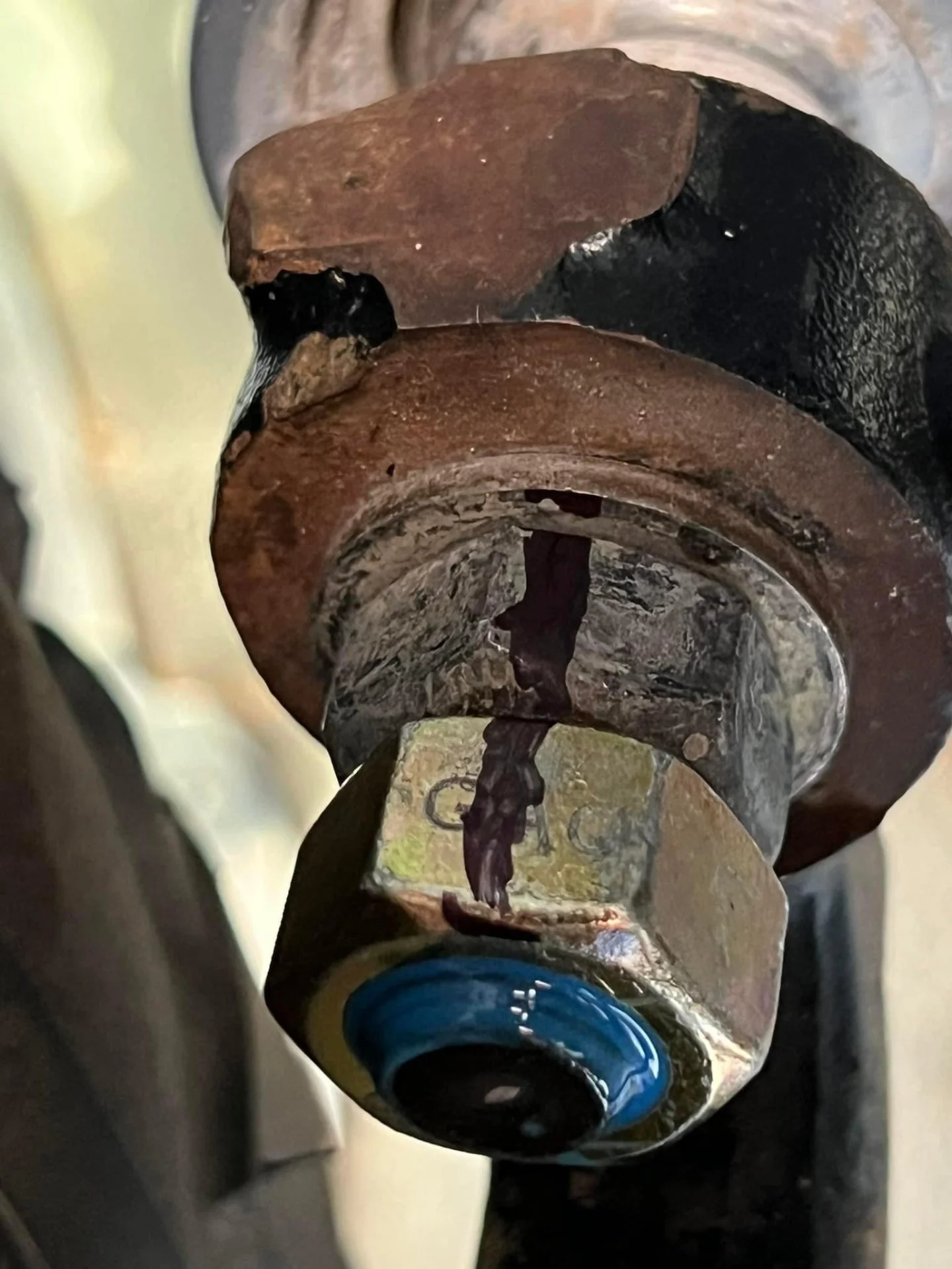

Getting ready to go to big bear again in a couple weeks
Two new mods….

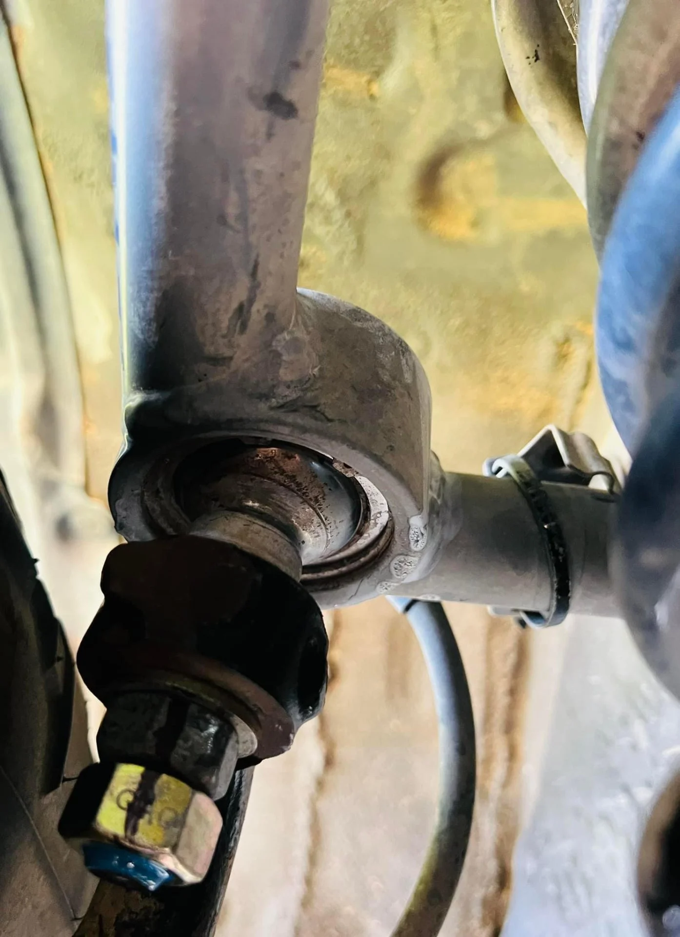

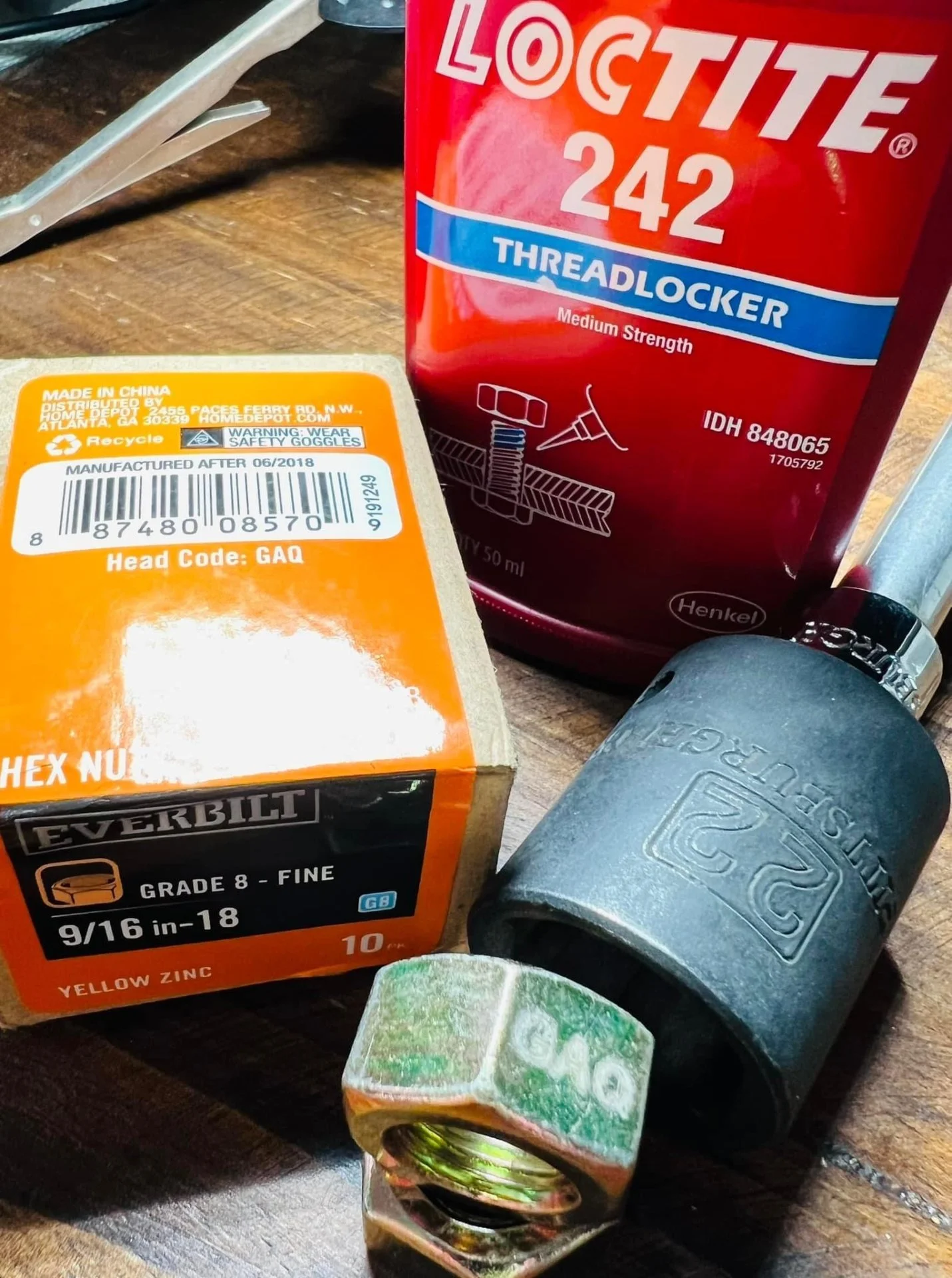

1. Added jam nuts to my TotalChaos UCAs as nut insurance to prevent the lock nut from backing off

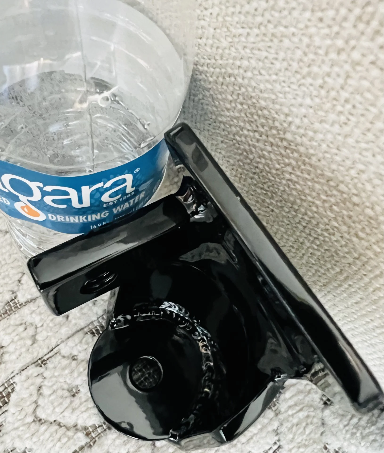

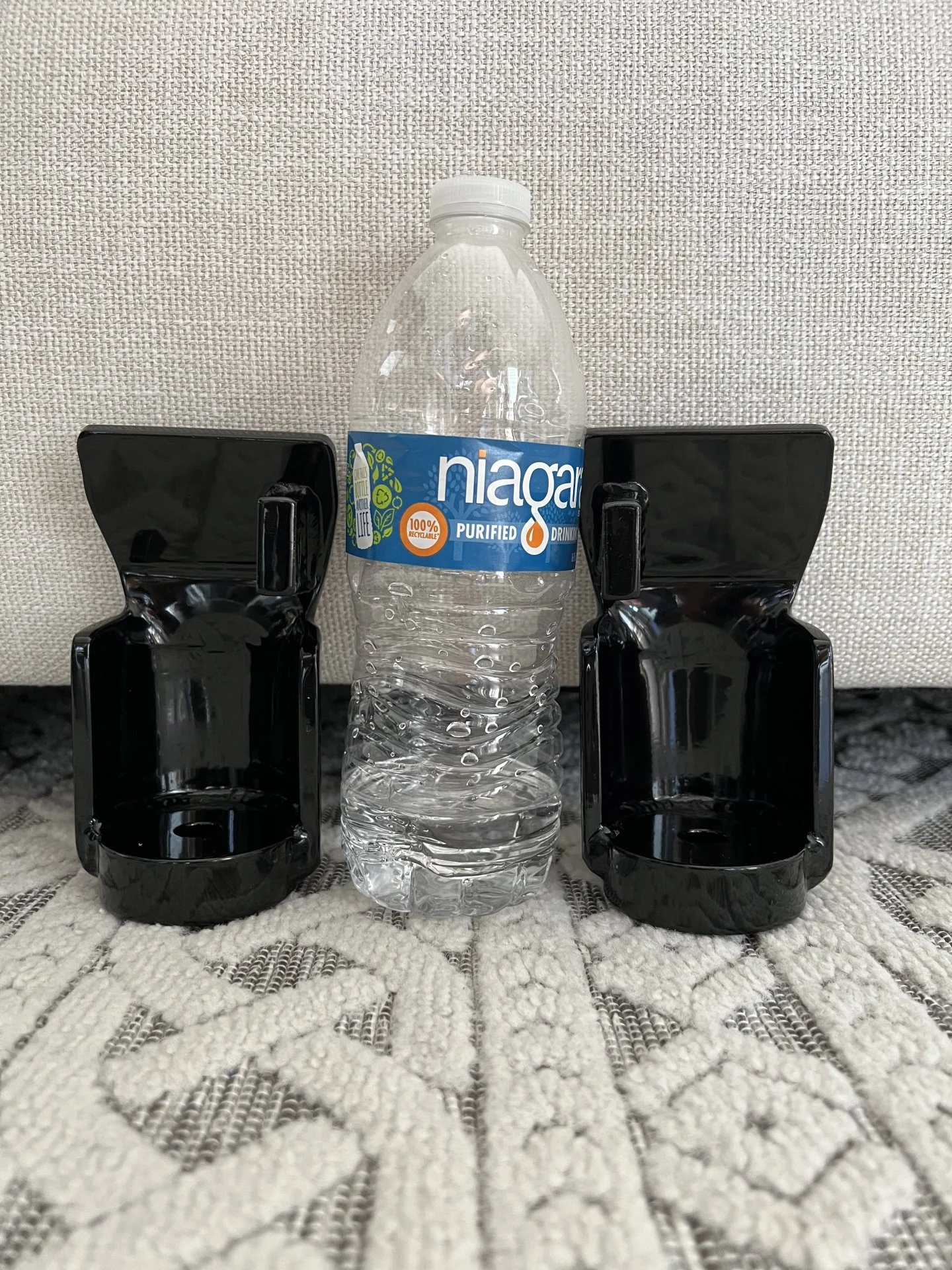

2. Got FJTOYMAN rear shock shin guards to protect the lower shock bolt. My GF asked why I got new water bottle holders! They are beefy water bottle holders!

Installed…my tires are too fat and couldn’t install rear shock guards unless I took wheels off..

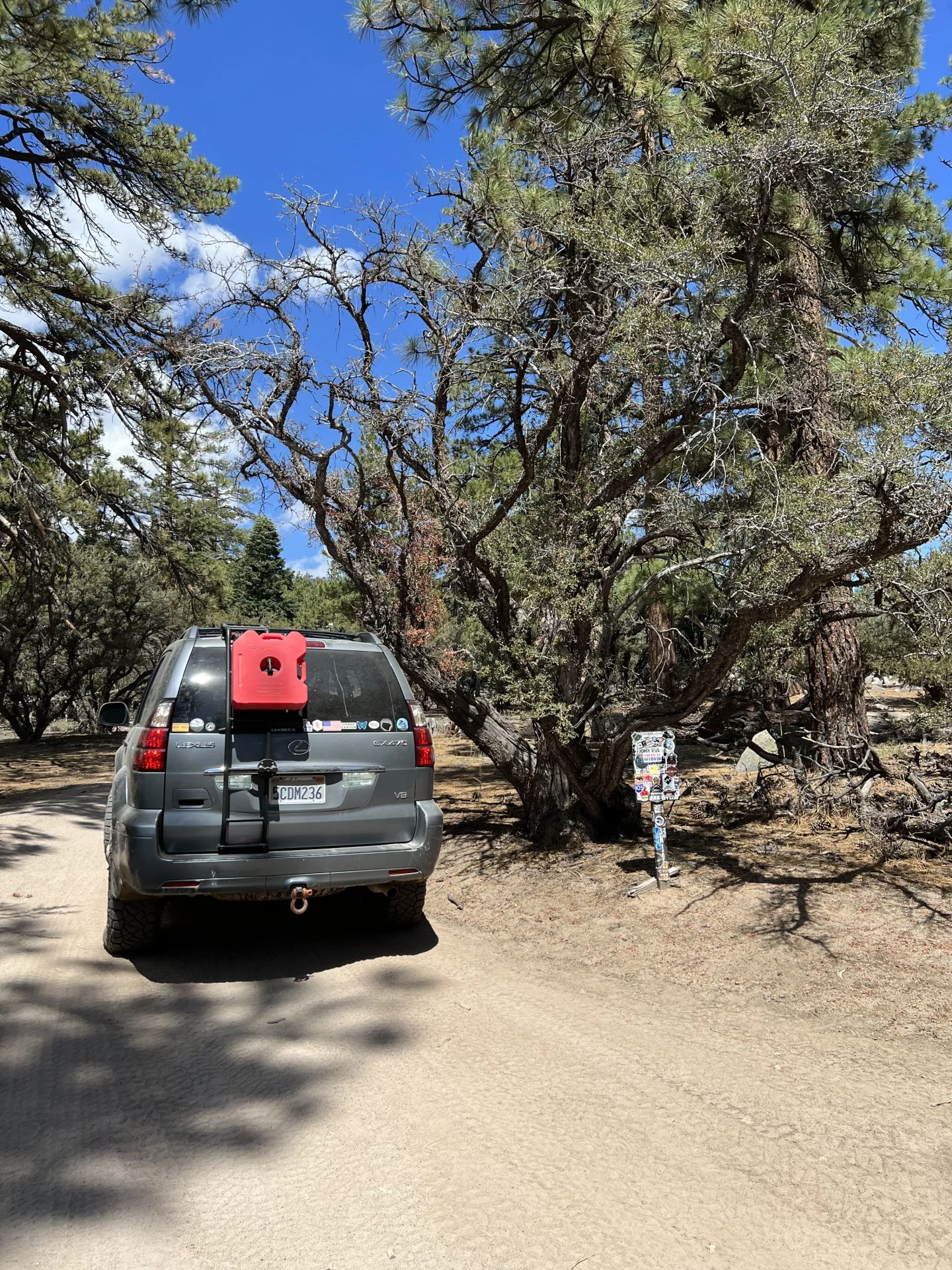

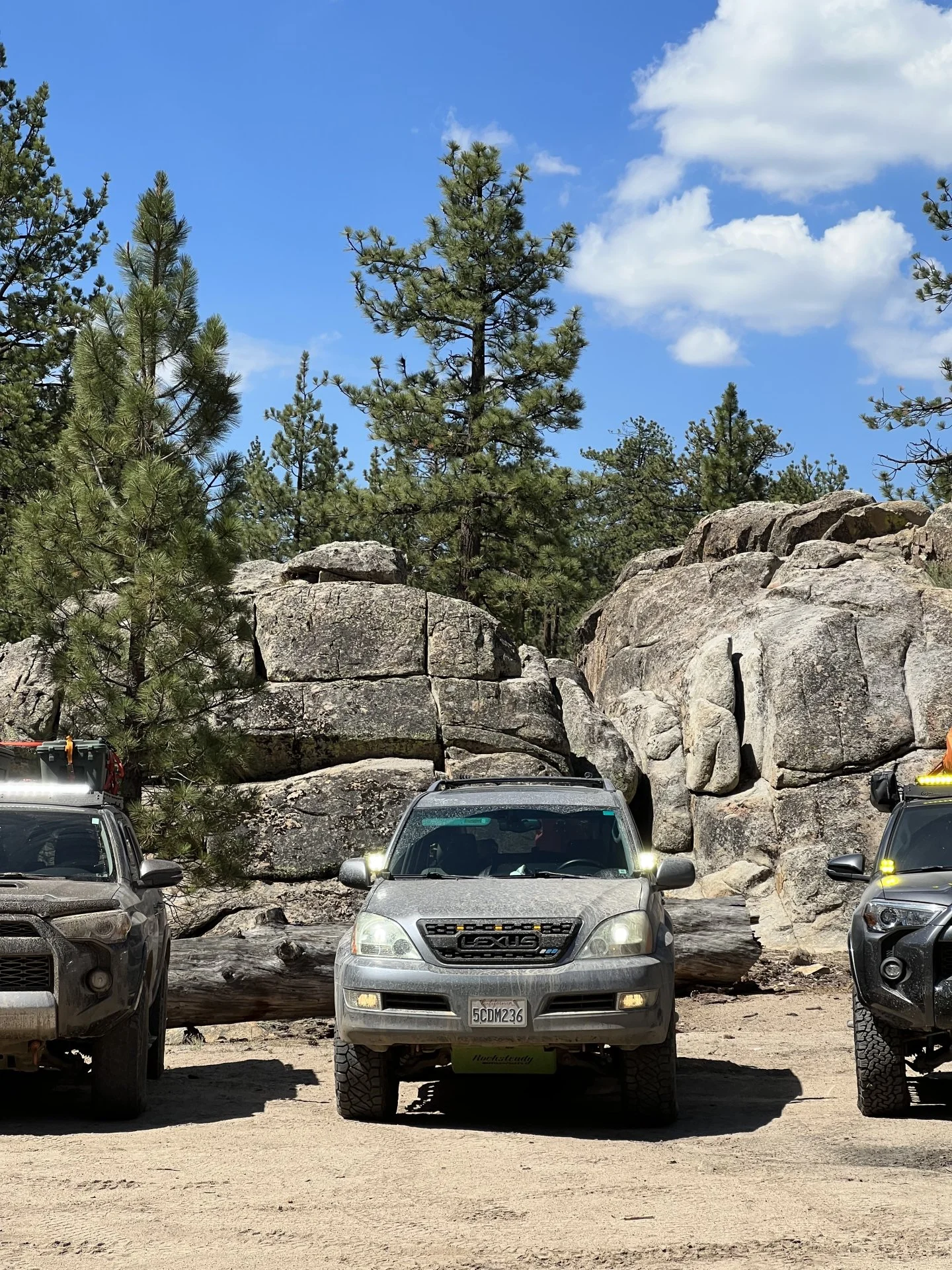

Was in big bear again. Kinda cold at night down to the mid 30s.

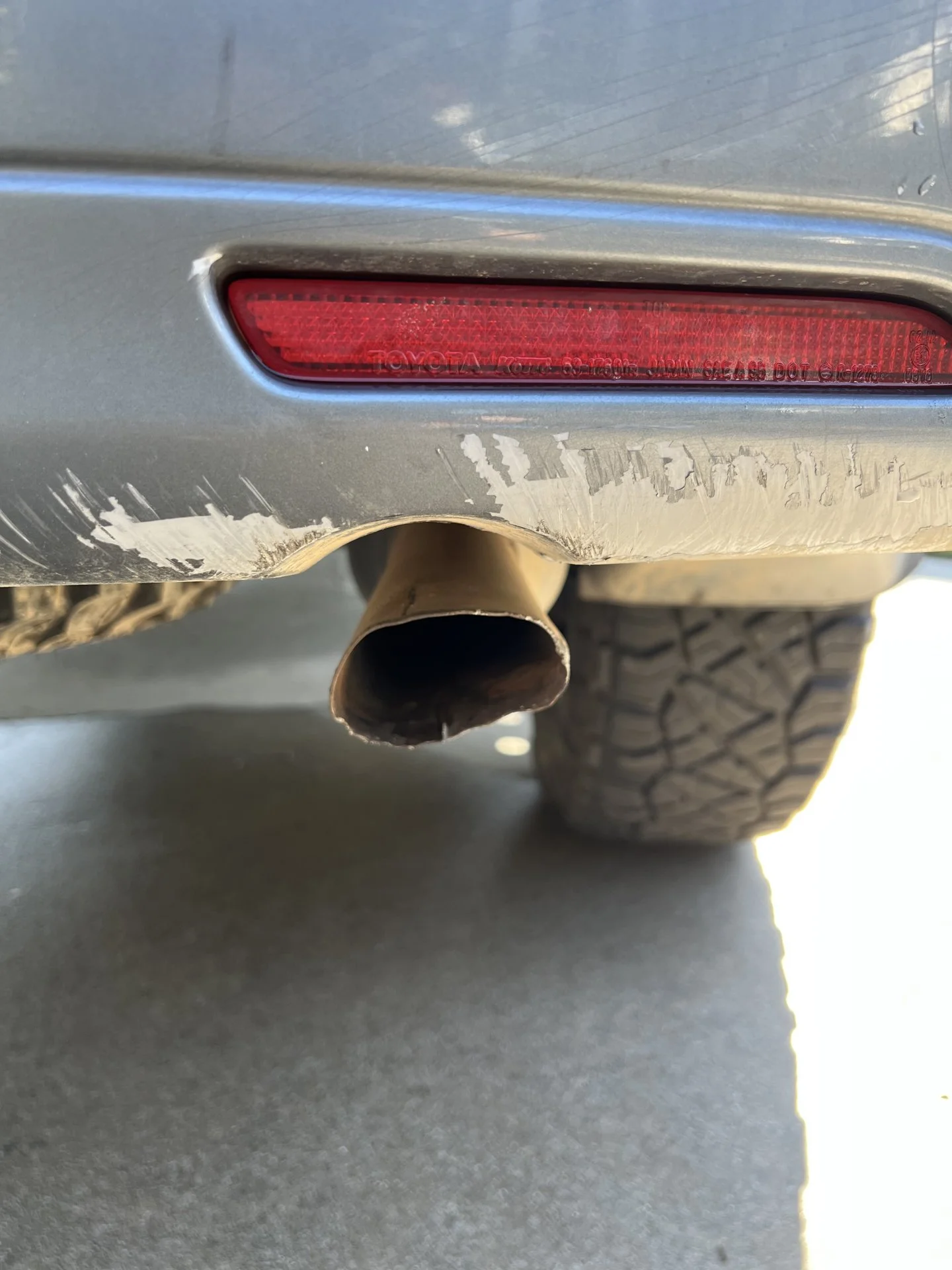

I tried fixing it on the trail

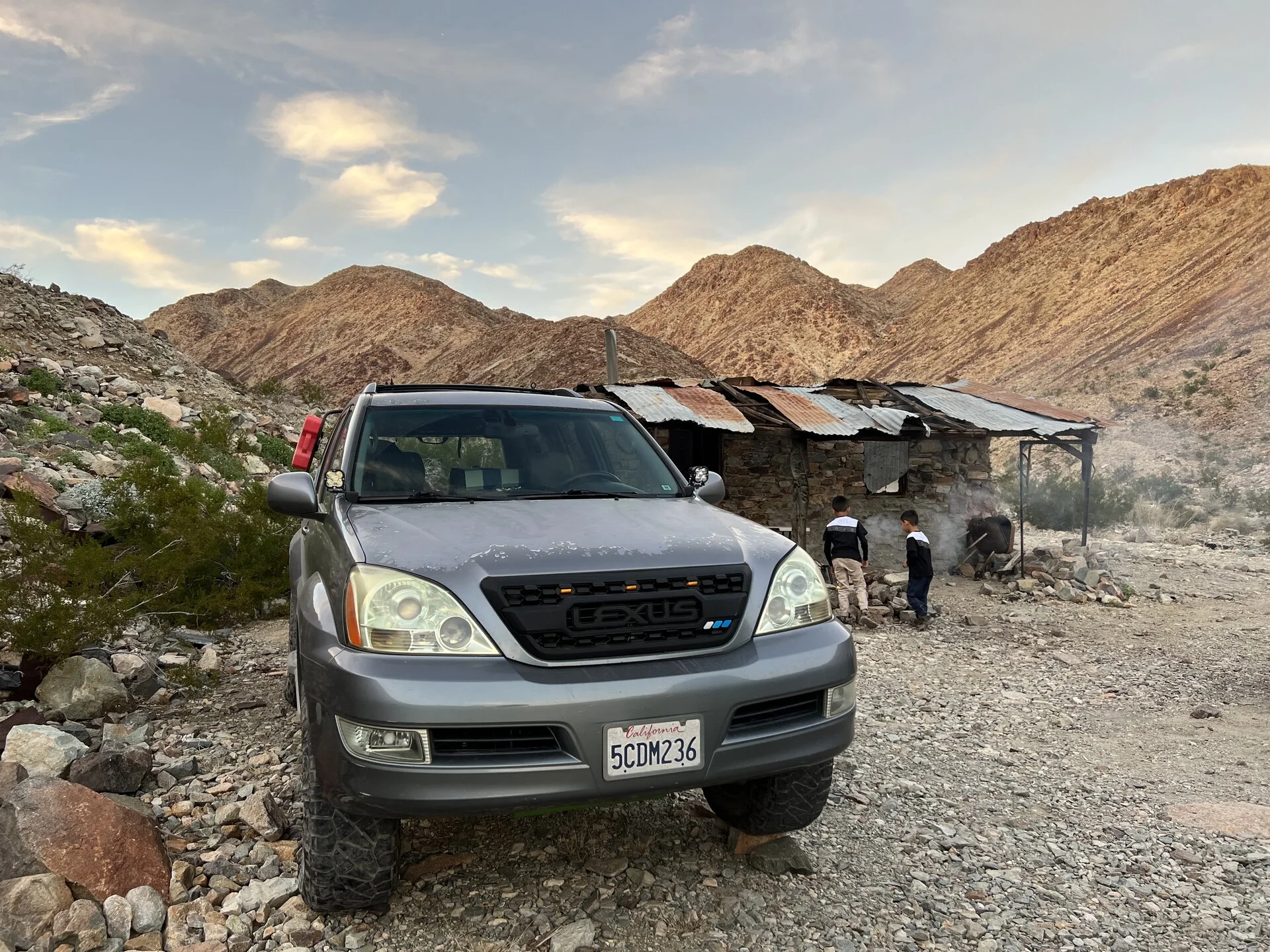

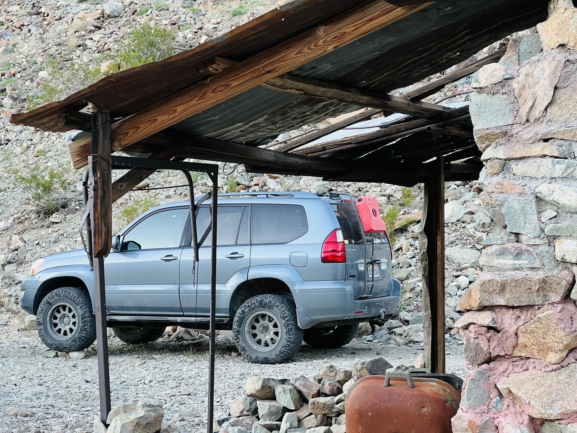

Brooklyn Mine cabin near Joshua Tree NP and the other mines around there like Sunset and Rose of Peru. Intermediate rocky trails that are long and tiring to drive thru.
Started on Gold Crown Road off of highway 62…got into Old Dale Road to the mines, camped overnight, then next day drove thru JTNP and exited via Berdoo Canyon Road
