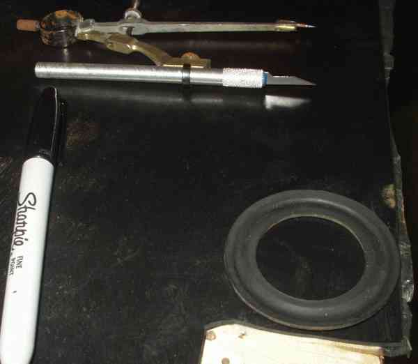

I picked up a 4' x 4' sheet of 1/8" fuel and oil resistant 'rubber' locally for under $20. I made a set of gaskets for a buddy for his tailgate and they came out great. Also made the gasket for the oil fill tube cap on my F engine with it. I found a neat way to cut circles without any expensive tools. I found a compass in an art store that allows you to clamp an X-Acto knife in place of the normal pencil. Now I can adjust the compass to the size of the circle I need and instead of drawing the circle the X-Acto blade cuts it out. See pic. Also Harbor Freight has a set of gasket making tools (hollow punches) for making perfect holes in gasket material. I was easily able to duplicate the gasket shown. :cool:
