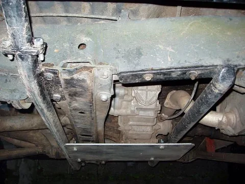

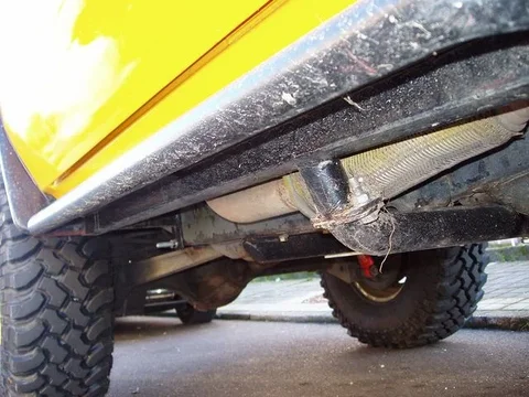

you need to go around the exhaust system:
only shot of the other mounts...
i can not seem to find the shots of the rest of the bars
I've got some cool ones that I'll take pictures of when I get home as to how they attach, but this is what I can provide right now.
I'll try to find the spec sheet that I designed (with exact sizes etc) to get the plates bent up to form around the frame.

Wayne and Craig, thanks guys. Yeah exhaust is a right royal pain. I don't really need sliders per se but more heavy duty steps, so will probably just go with two mounts (maybe attached to transfer support and somewhere behing the exhaust. Not too keen on welding to the chassis though...
Gil
Use Body Mount
The exhaust pipe is the biggest problem with 74 sliders.
I installed a piece of curved flat bar under the exhaust to the tranny mount and a vertical piece to the body mount, which is a few inches above the forward mounting point. Very strong vertically and horizontally, Stronger than the other side
My sliders are 2" by 4" with front and rear kick-outs, modeled after the OEM 'beer can' running boards I folded up on my 1st run out. They are good to stand on- but collect mud.
