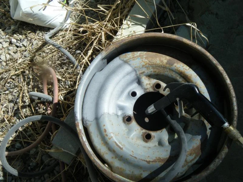

I chose to try using crushed glass. It was $10 for a 55 lb bag.

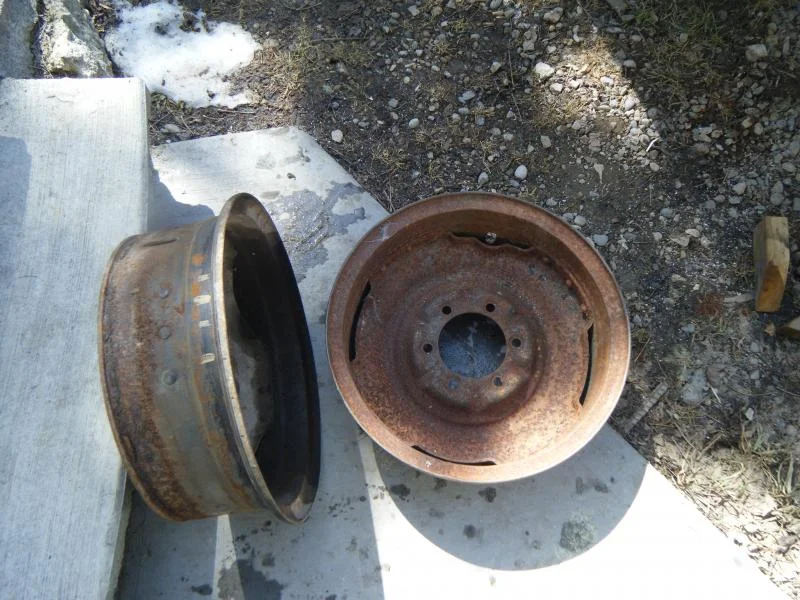

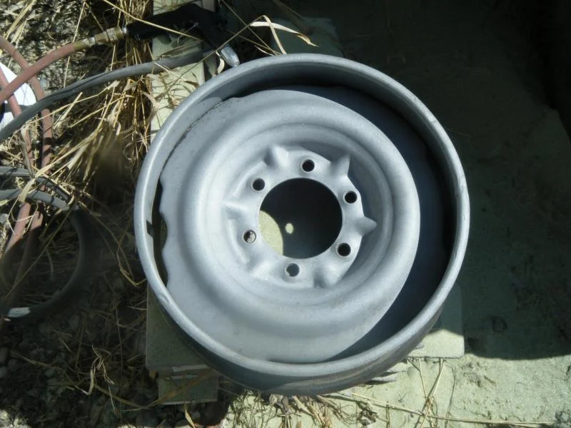

My first sand blasting project was to be my split rims. I tried doing the electo-derusting method (that'll be another thread maybe) with a less than satisfactory result.
The rims were a large area to sandblast, and were quite pitted on the inside. Because they are not airtight, or even watertight, water gets inside the rim and takes a long time to dry out.

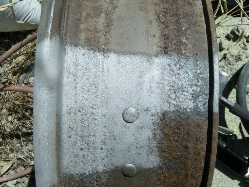

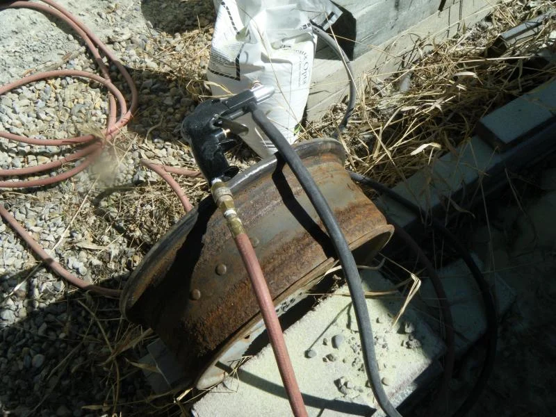

I spent 2 hours and a bag and a half of the media to do one side of a rim. This was not the right tool for the rims.
It did a good job, but it did not have the strength or volume to do the job in a timely manner. I went to the local seld-serve sandblasting outlet the following weekend and did all five in one hour for $100.

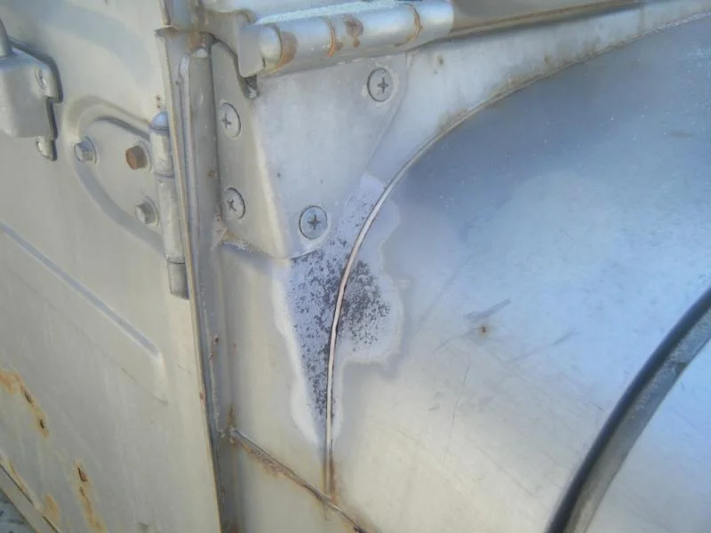

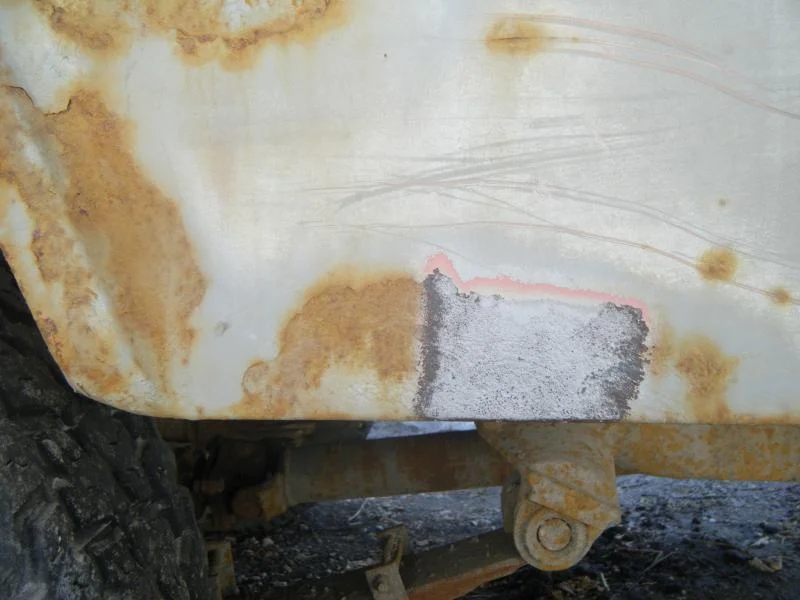

I tried a couple of spots on the body with more satisfactory results. This unit will nicely do for the rust spots on the sheet metal.
