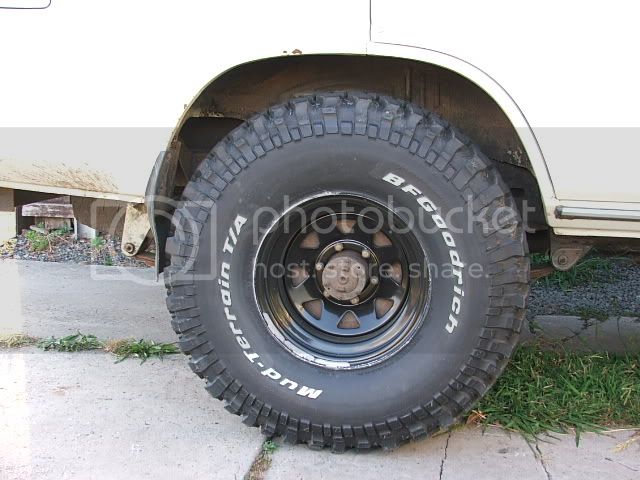

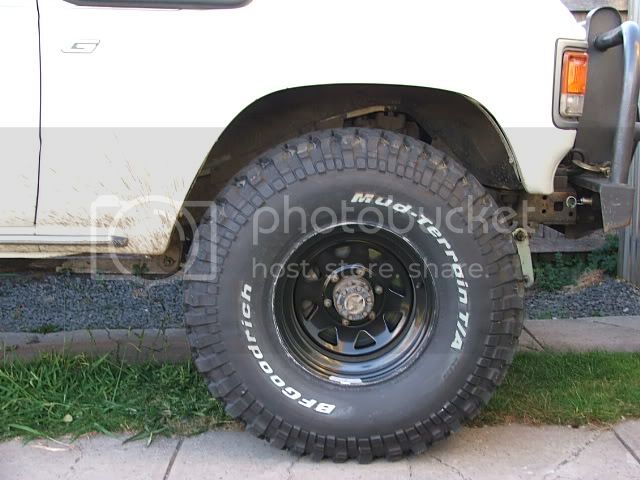

I had 35x12.5x15 BFG MT put on a few weeks ago. I have OME Extra HD front springs and reset rears. Both ends with 2" over length shackles. The tyres ripped off the front drivers side mud flap and the rear drivers side scrape when going around bumpy corners at high speed. I have purchased a 2" body lift kit from Superior Engineering but haven't installed it as yet. I have the HJ60 with the 2H and H55 5 speed and 4.11 gears. 5th gear is pretty much useless. Previous to this I had 33z and I was happy with this gearing, so by going to 4.56 diffs I think it would be happy. I would be happier with Marks transfer case gears, but that's the expensive option. Thought I'd share some pics pre bodylift. Hopefully it will get installed in the next couple of weeks.

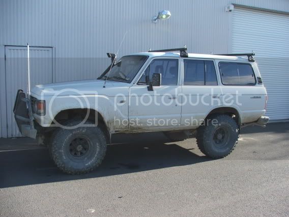

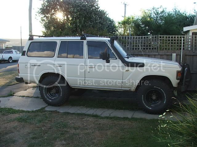

Ok, I got the bodylift on and took it offroad on the weekend. I'm glad to announce that the tyres do not rub at all. I am really happy with the way the 60 is at the moment. With twin lockers and 35 MT tyres, it's about as far as I want to go with it. Time to enjoy it now. I do have some other projects that I'm halfway through, but I will post them up later.

I hate my cruiser sometimes, when was lifted the first time the same thing as you rear end down ! I hate it ! I'm always triying to level it.
Tapage said:
I always thought if you gonna reegear .. to 4.56 go with 4.88 for the same money, unless you are planning to make a race with any sport car ..
It's an optical illusion! It's not actually lower in the rear, but it does look like it from that picture.
