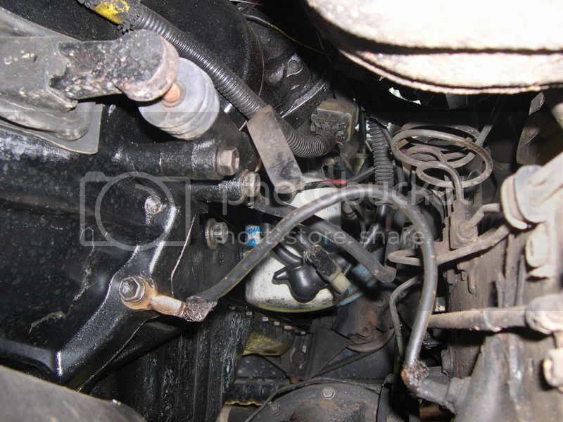

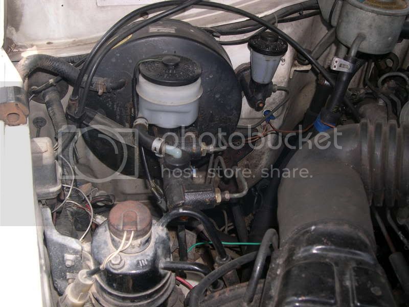

So in terms of the clutch system, I know that it's a hydraulic clutch, and that system entails plumbing the two cylinders together, right? I'm not quite sure how that system works.
As far as I know the slave cyl are on the same side (RH)and a straight bolt up.

This is the hydraulic clutch set up on a right hand drive HJ75 ute.cheers :beer: :beer:
