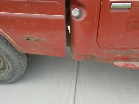

Here is the tub I brought home on a trailer yesterday. Unfortunately, it fell from the side of the trailer (it was too wide to fit on the floor) and hit the floor, putting a nice, gentle bend in the side:whoops:. You can see the bend just in front of the 80 series tyre, behind the running board. It made it almost all the way home (about 1 hour), and fell off about 2 miles from home.....

Must not be too bad - not knowing where exactly to look I can't really see it. Doesn't jump out at me anyway. Pretty good looking tub you have there Josh. No rust, just dirty in the floor boards? Have you got the rest of the cab - doors, rear wall, roof, windshield frame, that piece that connects above the doors....

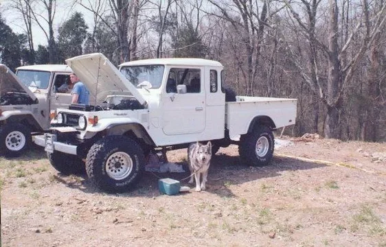

Where are you planning on stretching the cab? You've seen this shot before I assume?
There is a seam where the tub wraps around from the back and then overlaps the door jamb piece at the back of the doors. This is where I would split the tub and add material, the only spot really. That seam is where the cab transitions from straight sides to narrowing as you move forward. You could make a panel with an offset in it for the back wrap and then the other end would spot weld back to the door jamb. You would have to either separate the entire back wrap from the floor/rear shelf and extend the floor or cut across the floor and weld in a filler panel. Oh yeah - just remembered yours is external fuel tank type floor. The same thing would apply I guess - do I see a seam in the floor just ahead of the fuel filler tube?? maybe you can split the floor there and add a panel in?

I have that photo on my hard drive- I have dreamt of it for years. It was taken by Henry Cubillan (at least, that is who sent it to me about that time) at the DC swap meet in about 94 or 95 and was in the Trails at about that time. The owner is Kurt Grasso from memory. He actually took an FJ40 and spliced a Central American FJ45 onto the rear- frame and all.
