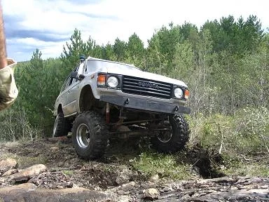

some older pics of it. 1 with 35x12.5 mudbrute Tires. and 1 with 33x12.5 tires

Cool looking rig Andy. Looks like the rear wheel wells and quaters have been cut?

Right as rain. but only due to rust. it was to hard to remake the body seams and stuff. Turned out ok though. alot of ppl dont even notice that the body seam isnt there.
the 84 Bj-60 i picked up, should be the same cab right ? it has hardley ne rust on it. so i was planning on swapping it to my frame. the Frame and fenders and doors on the BJ are wasted.. the guy must have hit some trees or something.
