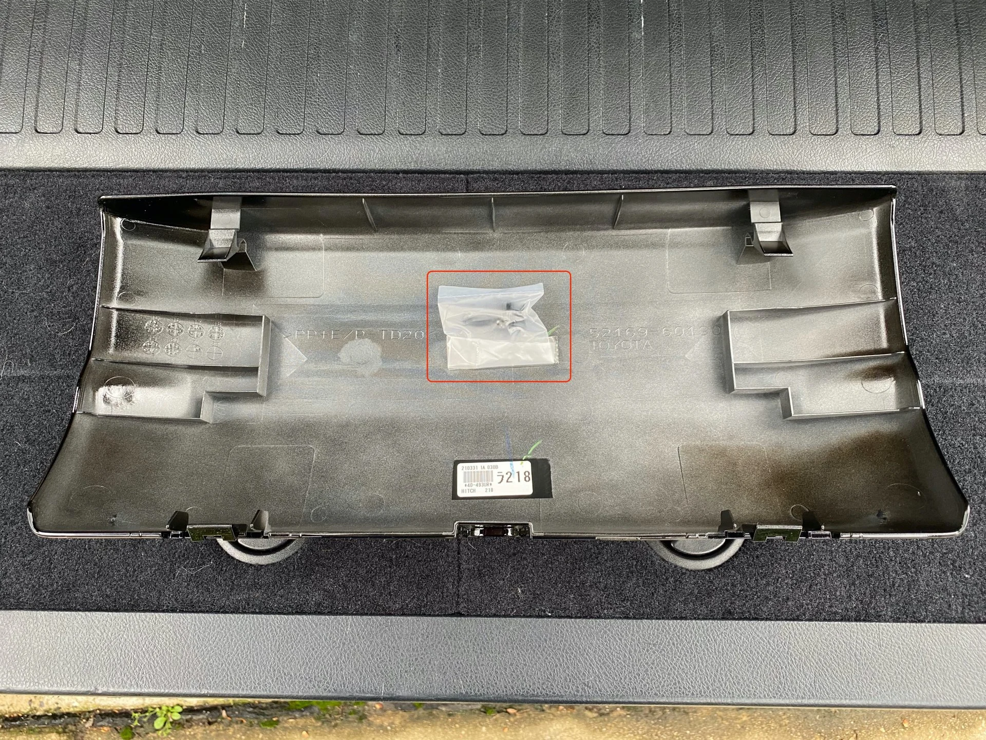

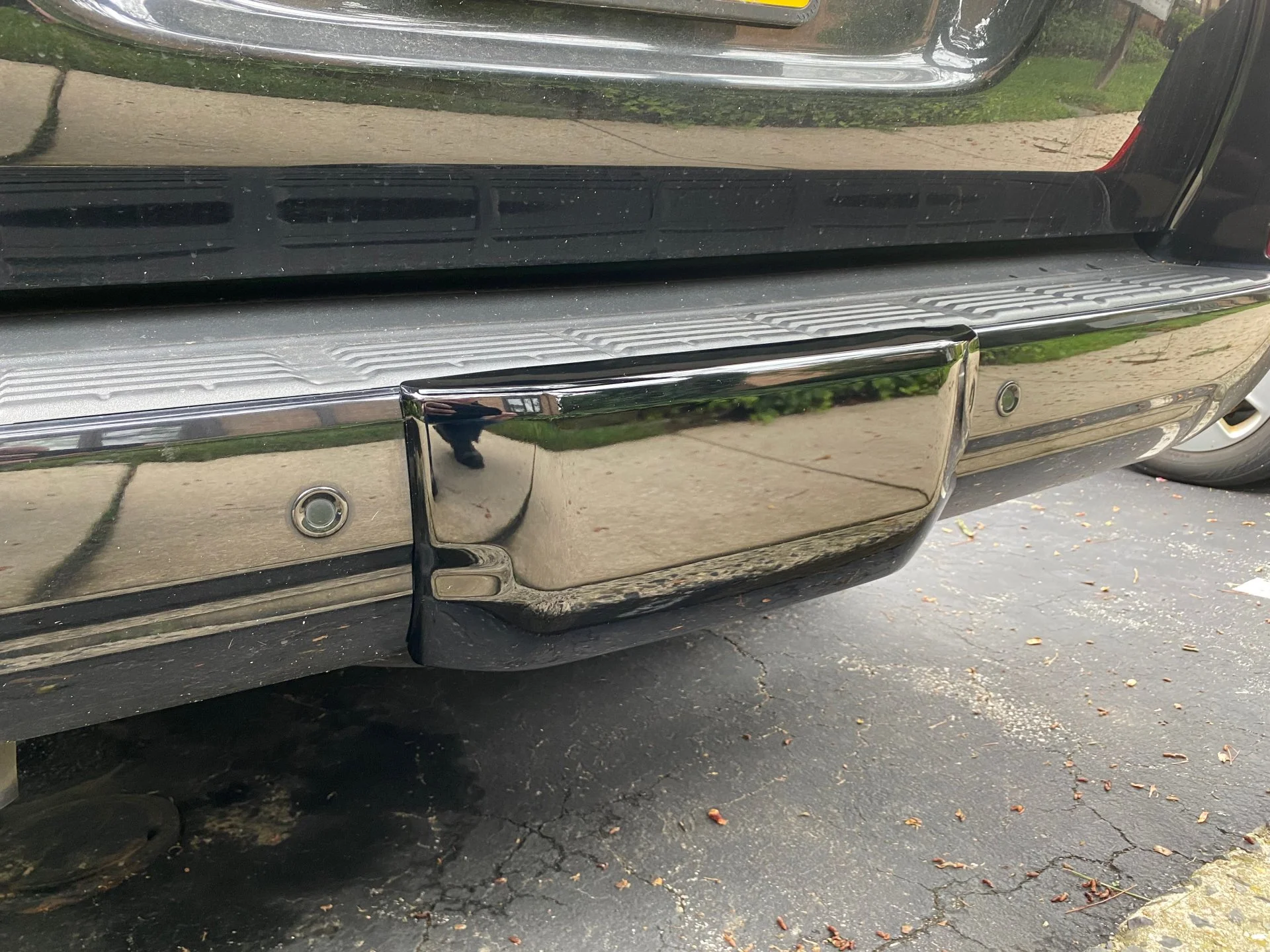

Just recently got a hitch cover for my 2016 Attitude Black - 218 (metal flake with the right light). Part 52169-60190-C1. It comes with the thumb plug to keep it secured.
Would not normally care about seeing the hitch but it just looks bad the way they designed it into the bumper.
